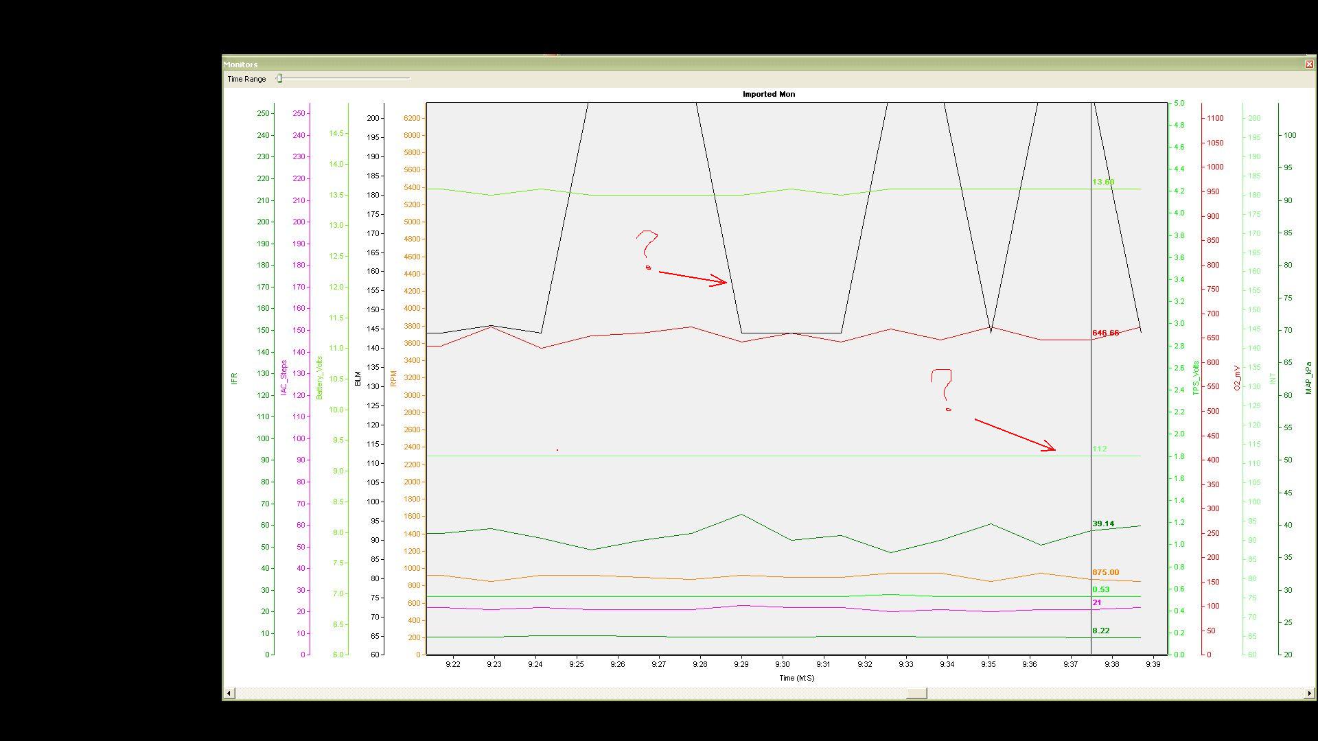

Hi
anybody can explain why the INT has a constant value 112 and BLM greatly jumps 145-200
Posts: 4811
Re: Logging BLM INT
if blm goes to far out of range it will reset INT to 112. Hows your fueling?
fad2629
Posts: 32
Joined: Thu Dec 11, 2014 4:58 am
Re: Logging BLM INT
Post by fad2629 »
Regular gasoline, pressure is normal, fuel consumption above the norm, O2=0.6÷0.85 mV
Set the injection of LD Astra-European (TBI, 1.6, *808) installed on another engine 1.6.
Bin is stock.
It is impossible to ajust VE.
Using WinALDL.
No errors, but it is possible by malfunction of the injector?
