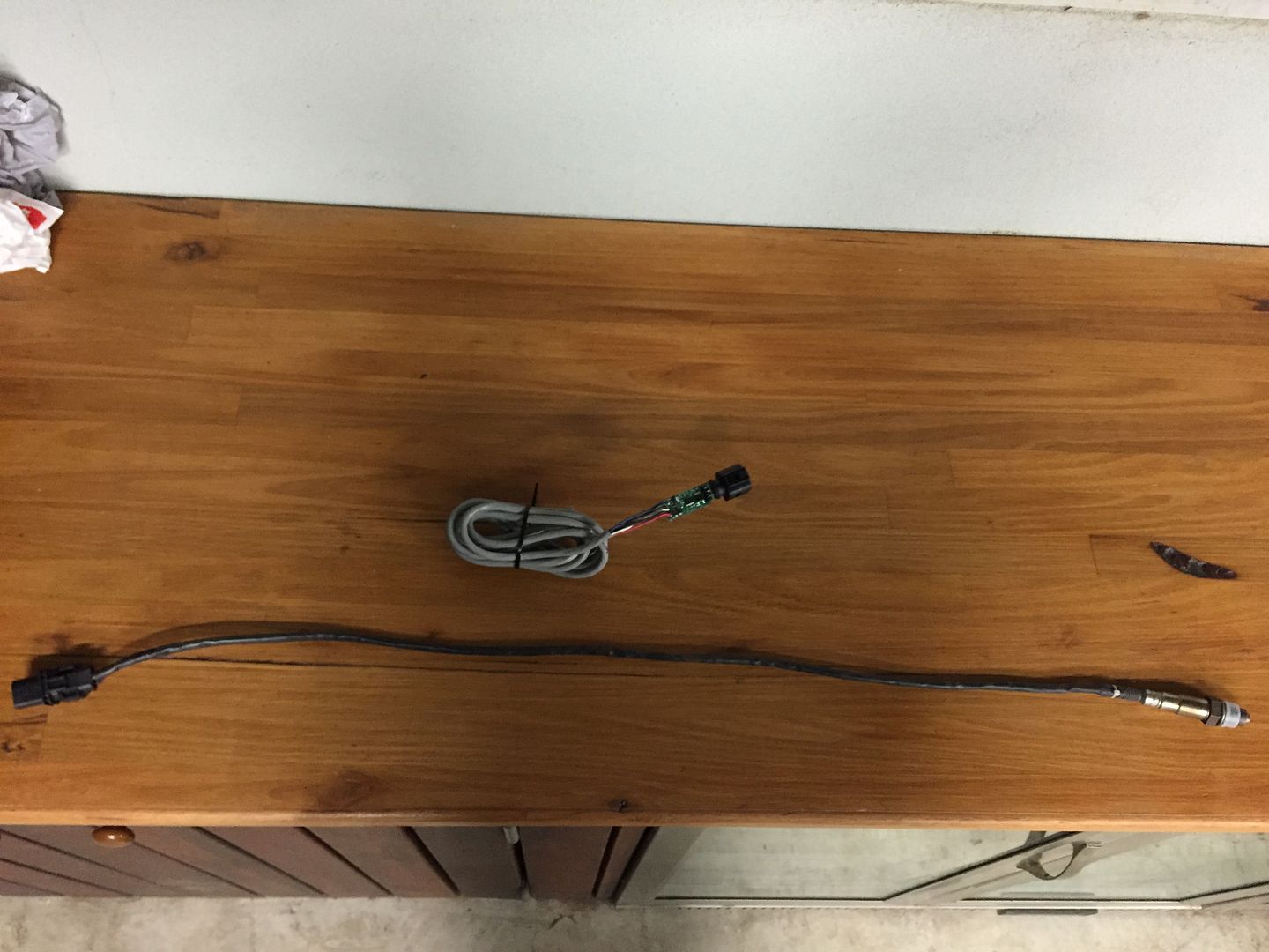

Whilst thinking about the issue, i realised that the wideband lead is waaaay too long, was going to upgrade the connectors to DT series while i was at it, but then realised that the spart has the controller built not only into the lead but onto the connector, fuck...

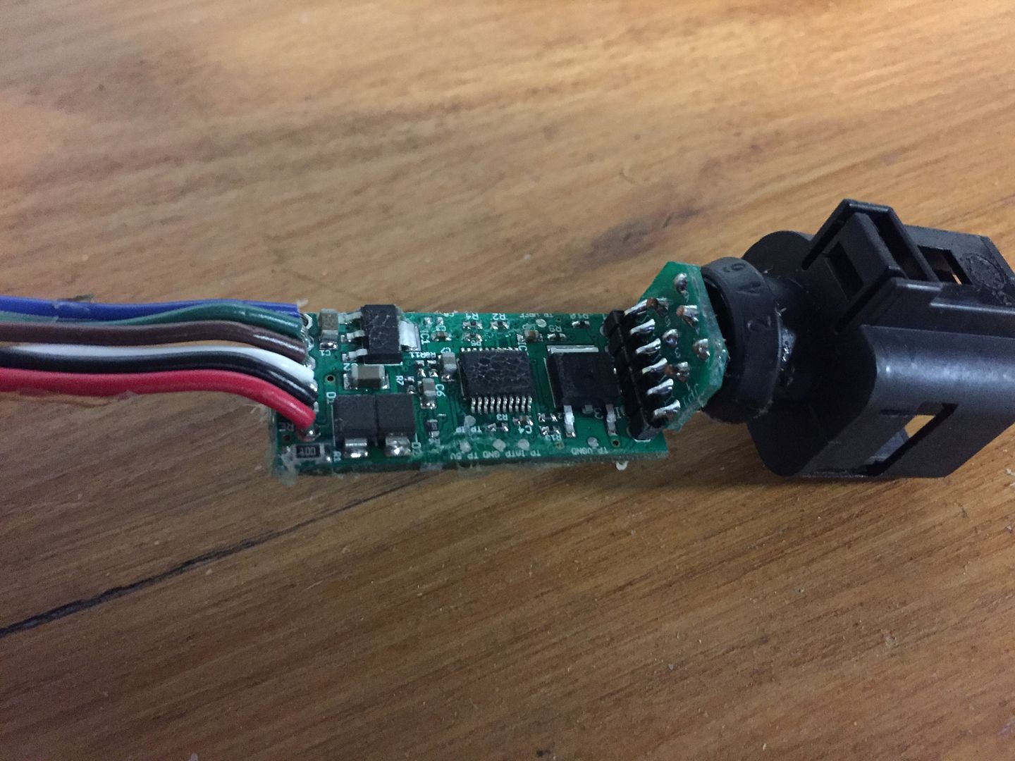

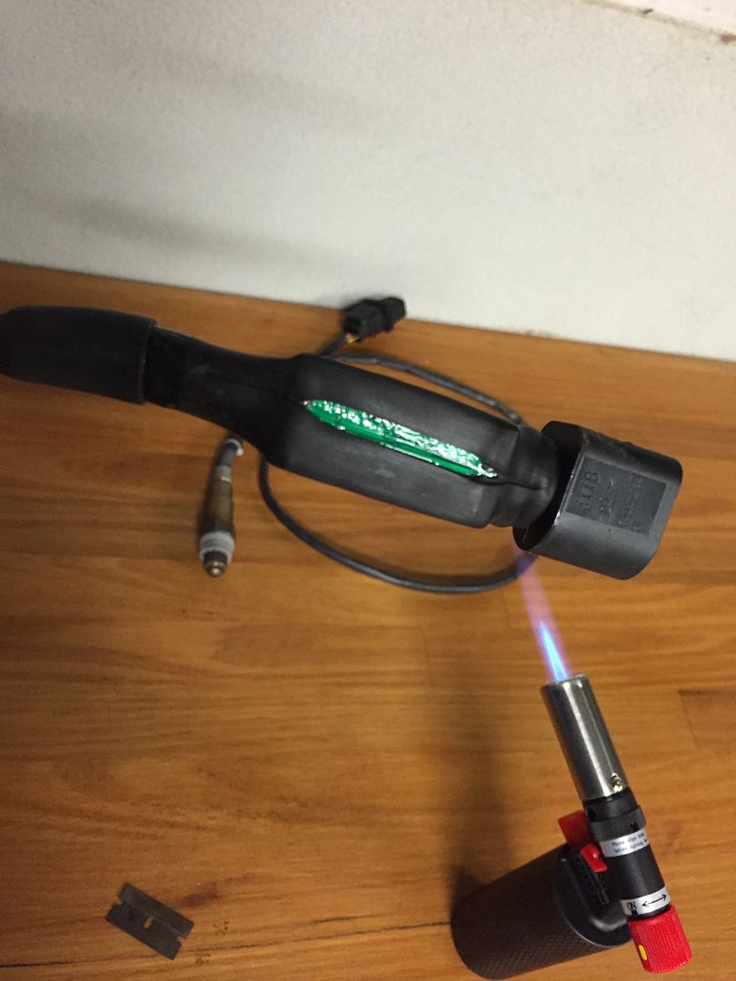

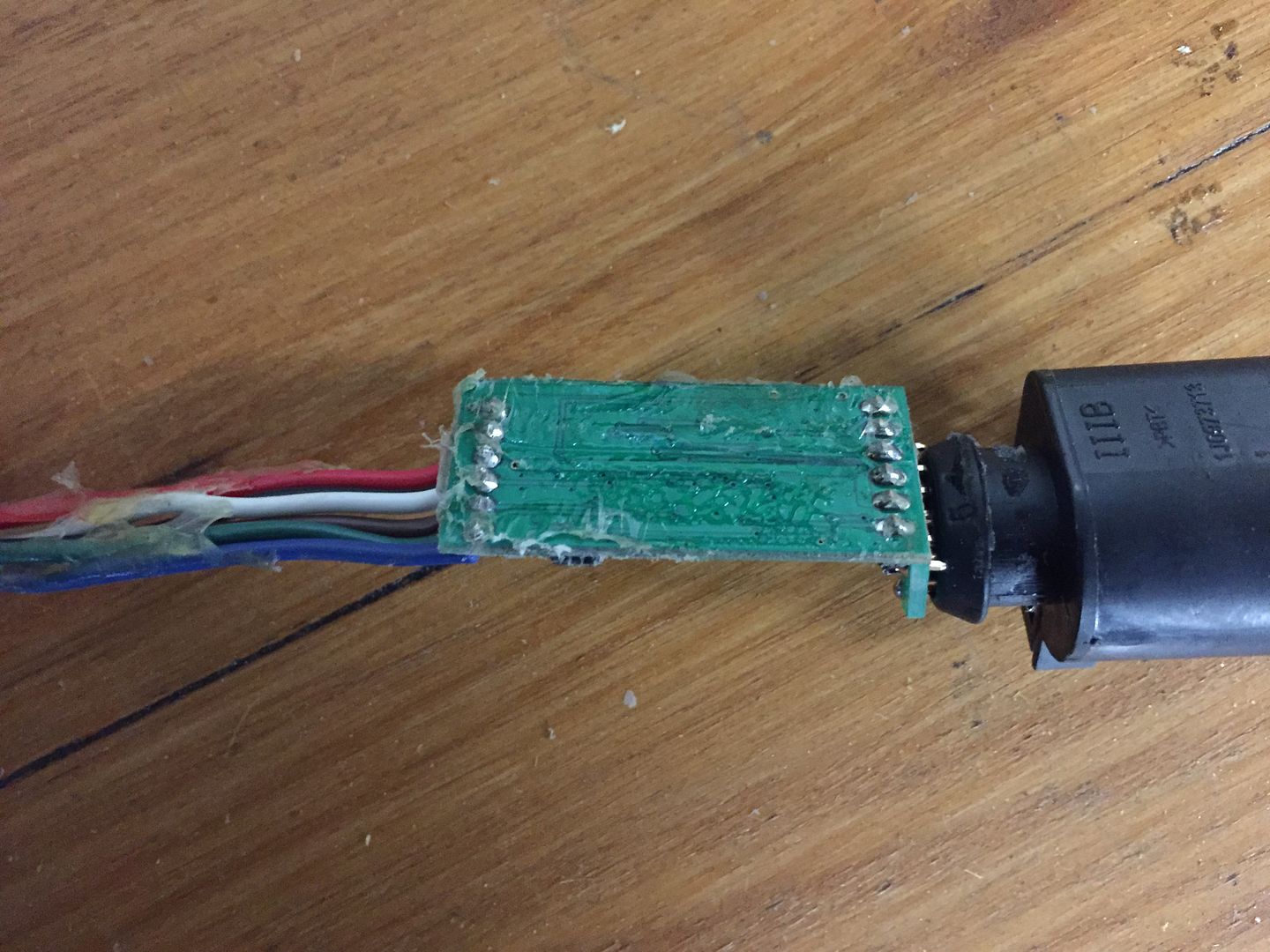

So i pulled it apart to see how hard this problem really is, too some photos for anyone interested...
That wideband is about a meter long out of the pack..
A little trick there, so as to not cut underlying circuits or wires, just score the heat shrink and then reheat and watch it pop open..
