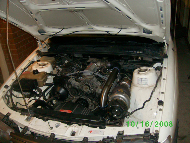

Here is a few pics of my VN V6,
its a series 1
the engine is standard,
its got a manual with 3.9 diff gears
just a simple cheap set up, but its fun to drive
I have put in ba XR8 injectors, which i believe are 30lb
its got a bosh 040 pump inline before the filter
I made up a stainless manifold used the standard manifold on the drivers side and put the waste gate on the cross over pipe under the gearbox,
its got the standard cat and a red back 2.5" exhaust
the turbo is a t70 and a chinese 38mm waste gate.
runs a 2bar tune and is set on 16psi at the moment.
ive done about 6000kms in it now and it hasnt missed a beat, its been the simplest and cheapst conversion I have done so far. its good to pull up at the loghts next to a skyline or a vn ss and blow them away...
its a series 1

That is the sh1t! Ive been in to wagons for a long time, and helped my mate some 8 or so years ago supercharge a VN, so this all looks very interesting. How have you done the exhaust to the turbo? My mate went supercharger to avoid the extra piping from the opposite side of the engine. The other commodore v6 turbo ive seen had a turbo hanging off each side. He was running 10psi on a stock engine, then somehow blew it up. Im not sure exactly what went wrong there. After 6000kms it sounds like yours is the go!

finally haha good to see some pics up lol.my mate just put an 044 pump in line but the intank pump cant keep up with it and causes the engine to die out just something to watch out for even though you have slightly smaller 040 pump he had to add a surge.did you need to change that tune much i sent you.hey ant this thing loves 16psi due to safe timing thats what kills them normally to much advance beats the bearings to death and headgaskets it was only the increase to 20 psi that the headgaskets didnt like aye clint need a 3 bar before going there again LOL

Hey Antus
here is a pic of the crossover pipe, it just runs from the drivers sidemanifold straight over and joins in to the back of the turbo manifold.
Delcowizzard, that tune you sent over was very close to spot on, i had to put a but more fuel in the lower section at cruise but other than that it was great, yeah the first engine held out well untill i got greedy and wound the boost up to 20 psi and blew the headgasket to bits, i even found pieces of it in the sump lol. The engine in it now is the one that has done 6000kms and it was a $57 engine off ebay, it cost me more to hire the trailer to go and pick it up as it did for the engine lol
i am going to pick up the clutch for it on monday, i got hold of a 5 puk sprung center button clutch, it should hold togethor better than this one, going to put a spool in it aswell, there is a skid pan day on in a few weeks and i want to get it ready for then, im looking foward to it....
after chatting to you the other day, you got me thinking about putting in a bigger fuel system head studs and mls headgaskets and running the 3bar tune with 20psi...

Ahh yeah I see
Looks good.

now thats an interesting way of doing the wastegate 1st time ive seen it done ilike that pretty good idea.bleeds off the boost ok obviously.
