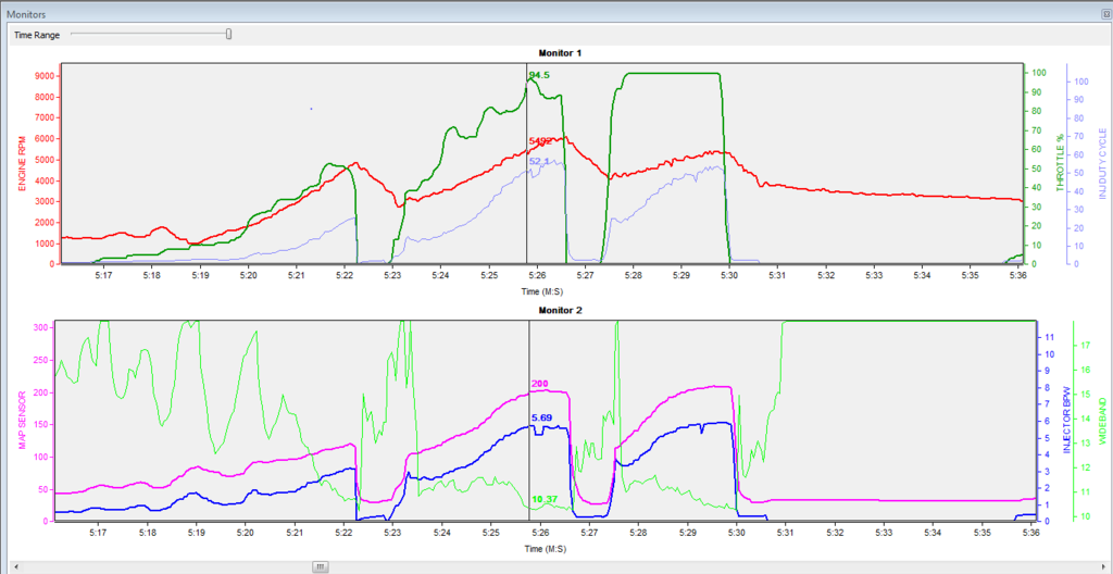

Guys I am in strife. I can't find what is causing random holes in my injector pulse width. I think it is something to do with Asynchronous injection.
The VE table has same values (86.6) for RPM 5200 and 5600 at 200 kPa.
I have increased "Maximum Asynchronous pulse width" to 9.6
I have never come across this problem before. Mind you my memory is not as good as it was a few years ago
Any ideas

fuel cut of some sort?

Getting close to Rev limiter (5600)?

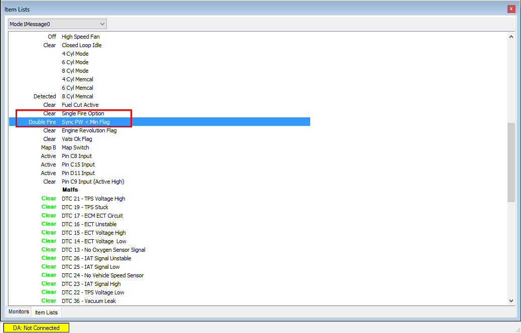

look at the flags immediately before and during the 'hole' and see if anything toggles on.
Put the asynchronus stuff back to stock, that'll affect the bottom end fueling and only with large injectors and with incorrect dead time settings. That wont cause the dip your seeing there, unless you have changed the settings and its kicking in way up there instead. The flags on the data list view will tell you.
sync asnc aka single or double fire.png (33.67 KiB) Viewed 6209 times

Will now check out Antus's post with regards the flags.

from what i can see the point of the hole is as the tps drops from 95 down to just below 90 ? its not some sort of decel setting or something ?

I did notice that too but I have many logs where the TPS is 99.6% all through 1st 2nd and third and it still does it leaving a hole often 4 times wider than the one displayed above.
Just modifying the bin to log the flags. Log above was at 24 HZ with no flags logged.
