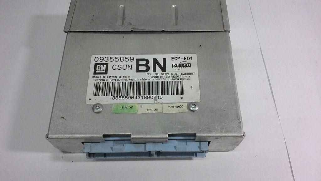

Hello everyone, my name is Luis, I have a Corsa chevrolet 2005 (corsa B), my car has a delco ecu csun, have been researching on the maps injection and degrees of progress, but I still have doubts about the offset, Can somebody help me? My values are correct?
My engine is a 1.6L and 8 valves
0017B Inyection at part throttle 16x11
0022E Injection at close throttle 6x11
0095A Spark Advance at close throttle 9x9
009AF Spark Advance at middle throttle 16x11
00A63 Spark Advance Switch A 16x11
00B17 Spark Advance Switch B 16x11
00CDA Spark Advance During Aceleration A 11x5
00D1A Spark Advance During Aceleration B 11x5
Ecu Picture:
https://www.flickr.com/photos/54220170@N06/?
thank you for all.
Luis
CSUNor.BIN
(32 KiB) Downloaded 630 times

Your injection at closed throttle begins at 000220
Injection at part throttle begins at 000170
Spark advance at closed throttle begins at 000950
Spark advance at mid throttle begins at 0009A0
Spark advance during acceleration begins at 000CD
Rev limiter begins at 000870
This is all the info I have so I hope it helps.
If you find any more maps please post them here.

hi Luis , what do you mean whit advance switch A and B?or Aceleration A or B?

Hi! Is for octane selector, A is for 93 octane, B for 95 and 97 octane.

Thank´s Luis, do you know what is the conversion factor for spark advance and inyection maps? and How should I put it?becose this values not make sence.

I also want to tell you that my Octane selector says C / D , not A / B as yours , my car has knock sensor, and yours?
