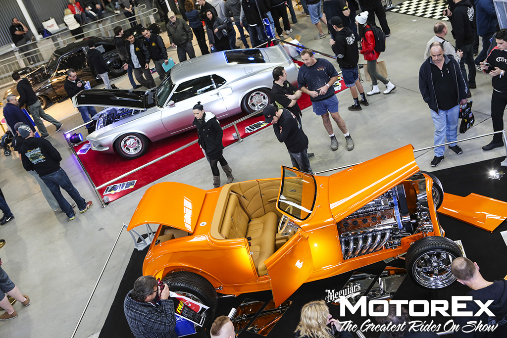

I have a friend that has built a quad cam v12 jag engine and we have been tuning it with kalmaker ,I have convinced him to go with tuner pro and 12p.
He is in the Hastings area,would there be anyone in the area that could help him get started by reprogramming the srams. and perhaps converting the kalmaker tune to 12p.
I have been helping with the kalmaker but I am in Albury so some one closer with 12p experience would be great.
have posted pic of car

Make sure he starts up a build thread it's a nice looking hot rod
