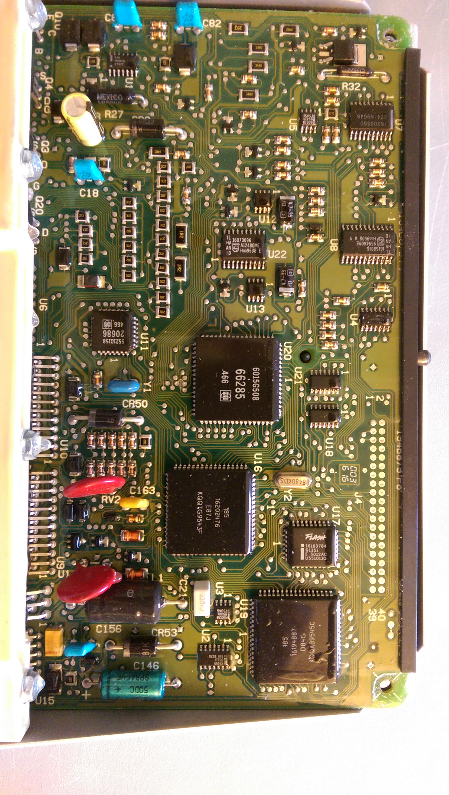

Hi All!
After chatting with Antus, I wanted to start up a thread to get some insight on getting into this PCM. I'm attempting to pick up where a few others left off and first figure out the Seed/Key or security algorithm before I get an AVT cable and get into reading/writing at 4x speeds. I'm going to list every thing I have done so far and the specs on this unit and see where it goes. TIA!
The current dilemma i'm trying to sort through is why this PCM seems to respond to normal ELM 322/327 requests for a SEED and KEY response but doesn't unlock with any of the 256 GM algorithms. Maybe going back a few steps will help me better understand this? I have a great understanding of the OBD-I setup and the reverse/assembly and data mapping, but flash memory is all new to me.
GM 16216588
6.5L GM Diesel 4L80E 1996-2000 (OBD-2 J1850 VPW)
High Res Board Image:
(Following is quoted from an old site "1000cows" that is no longer active)
"Parts on the OBD-2 version of the board:
16055199 = voltage regulator
16166240 = quad driver module with diagnostics
16034993 = stepper motor driver
20686 = SAE J1850 transceiver and controller
66285 = PLCC-68, Delphi IOR, mapped at $1400
16202476 = PLCC-68, MC68HC11F1. 1024 RAM & 448k EEPROM
39985 = PLCC-68, timer I/O module
16183784 = Intel PLCC32 AN28F010 128k x 8 flash memory module
16206550 = ?
I/O Assignments:
AN0 = APP
AN1 = APP

This is a 68HC11 processor which should be very similar to
that used in the OBD-I version. It is a bit unusual (to my mind) to use a 68HC11
on the OBD-II ECM when pretty much all of the OBD-II petrol ECM's went to
68332's. I guess Ford pushed the EEC-V (8065, a 8096 variant) just into the
2000's before going over to the PowerPC's so why not, I guess. Just to be a pain
in the arse, the flash memory has some of its address lines swapped around.
There's space for two 32k memory pages (bank swapped using pin PG3) and one 24k
non-banked page shared between calibration and common (non-banked) code.
Communication is via SAE J1850 instead of SCI."
Some of the address swapping info is on another site along with a direct flash dump done thru HC11 UART and the dos program prog11.exe:
See later posts in this thread for more info on this.
http://www.gearhead-efi.com/Fuel-Inject ... 6588-Flash

GM 16216588 - Hacking
quadstar87
- Posts: 86
- Joined: Tue Dec 01, 2015 6:13 pm
