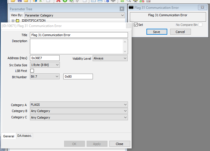

had a read, and ive got it all sorted out, thank you so much for the help now i have read the advanced and basic guides to tuning a car, what would tables would i be looking at to fix the tune for a 87mm pulley. thank you alot!
p.s is this correct to hide DTC 31, i have disabled vats but i get the communication failure DTC its on a VX Ecotec ECU running The 1's enhanced
