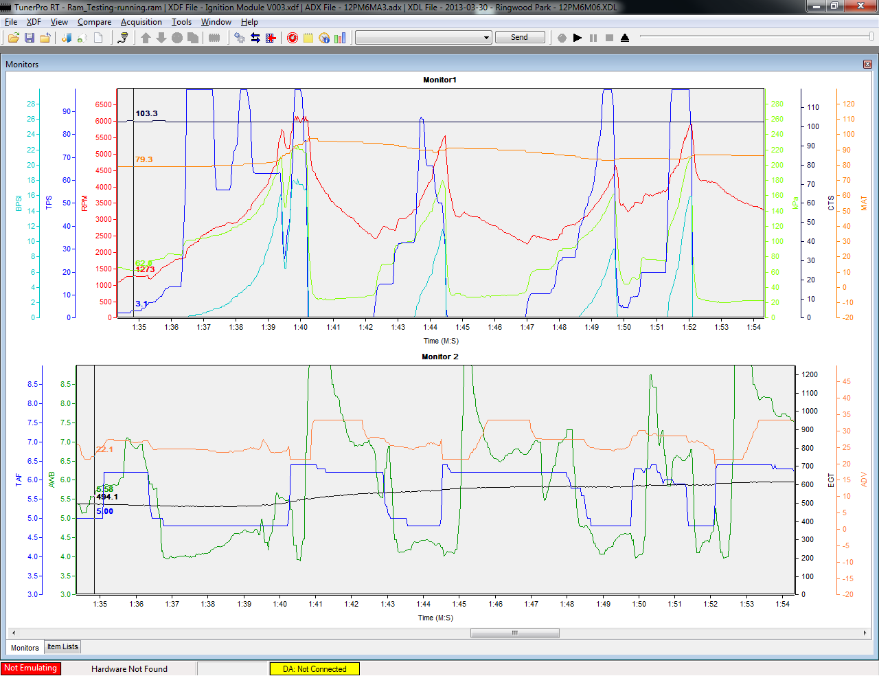

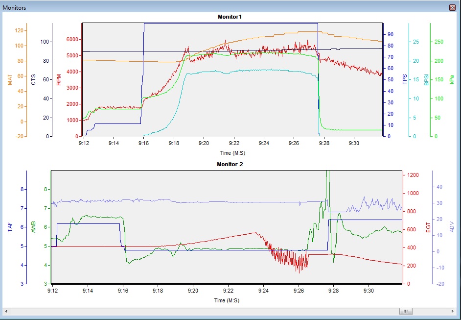

Noticed on different a few different holden v8s the rpm signal isnt very linear under load. Ive done a few logs now on v6 engine and much better. Not sure if its do with V8s having a Dizzy and V6s being crankshaft sensor, or electrical noise? The Cars seem to run well, no missfire etc Anyone else come across this?

I have noticed that on the V8's. I've logged a couple of V6's but cant really remeber there RPM trace.

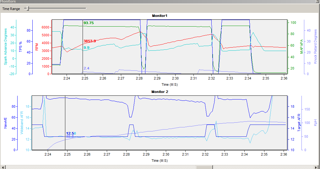

V6 are pretty much dead straight like this.

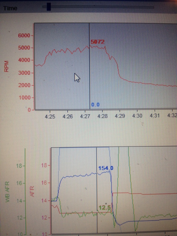

I noticed on the v8s that the RPM signal is more straight in lower gears when the engine revs up quicker, worse in higher gears and more load?

Likely timing scatter from the fact its a dizzy thats driven by a gear which is driven by the cam , gears have lash and so does the cam due to the timing chain and sprocket. V6 is a solid fixed sensor reading the crank so there is next to no error in timing.

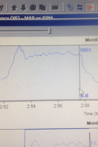

yeah its the dizzy/cam/crank play thay does it, I had the same results with my 202
below is a log with the dizzy.
then a log with crank mounted trigger wheel.
the dizzy is noticeably worse at high revs.
that said it doesn't seem to make a bit of difference to the motor, but I'm sure if you measured it with a dyno or something it might show some differences.
