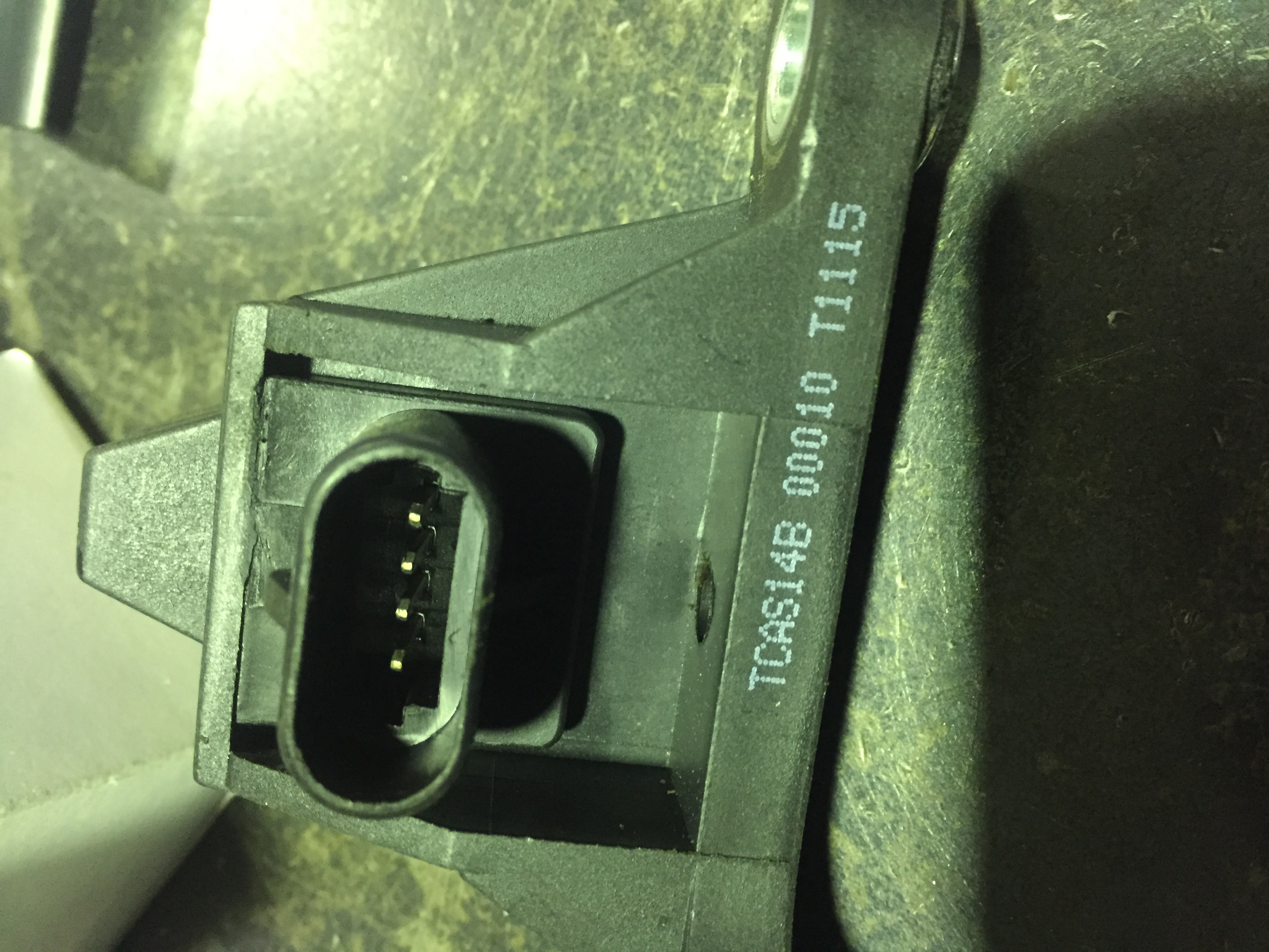

Re: Fault Code 47 & 49 VX $A5k
Not saying it's the case with yours but I had a V6 a couple of months ago brought in running rough, backfiring etc.
Customer had done everything, injectors MAF gaskets ignition module coil leads crank angle sensor etc etc.
It had been fitted with a brand new out of the box non genuine crank angle sensor.
Put it on the scope, the 18x signal was terrible. Signals missing or not staying on for the whole duration of that tooth.
Put a new quality crank angle sensor on and instantly fixed.
Not sure what brand or where the customer got the sensor, but just warning there is very poor quality sensors out there for sale.

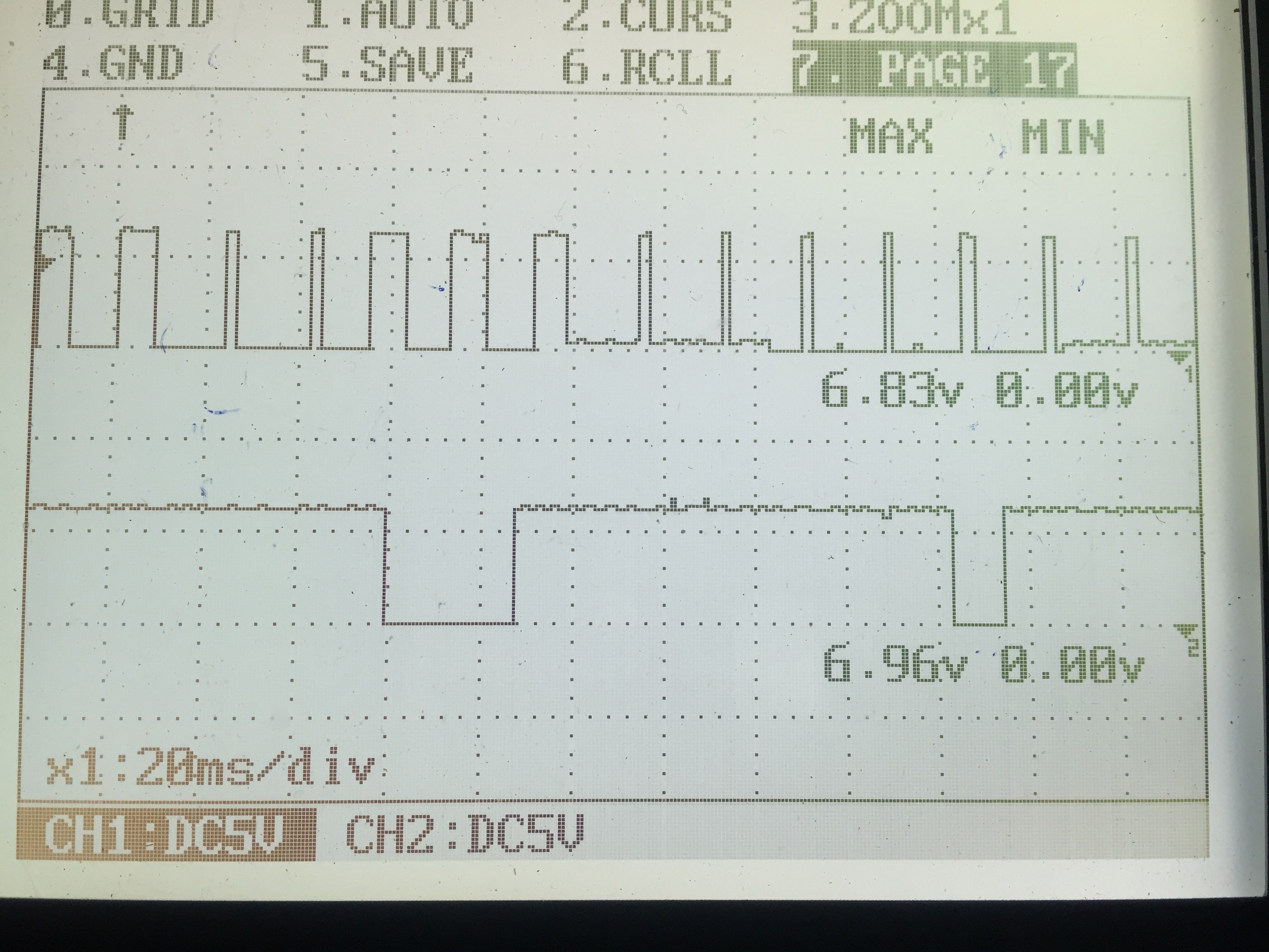

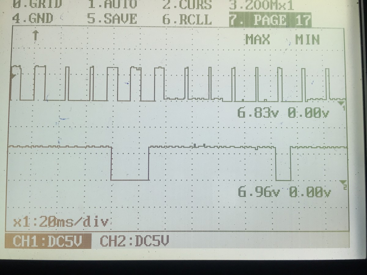

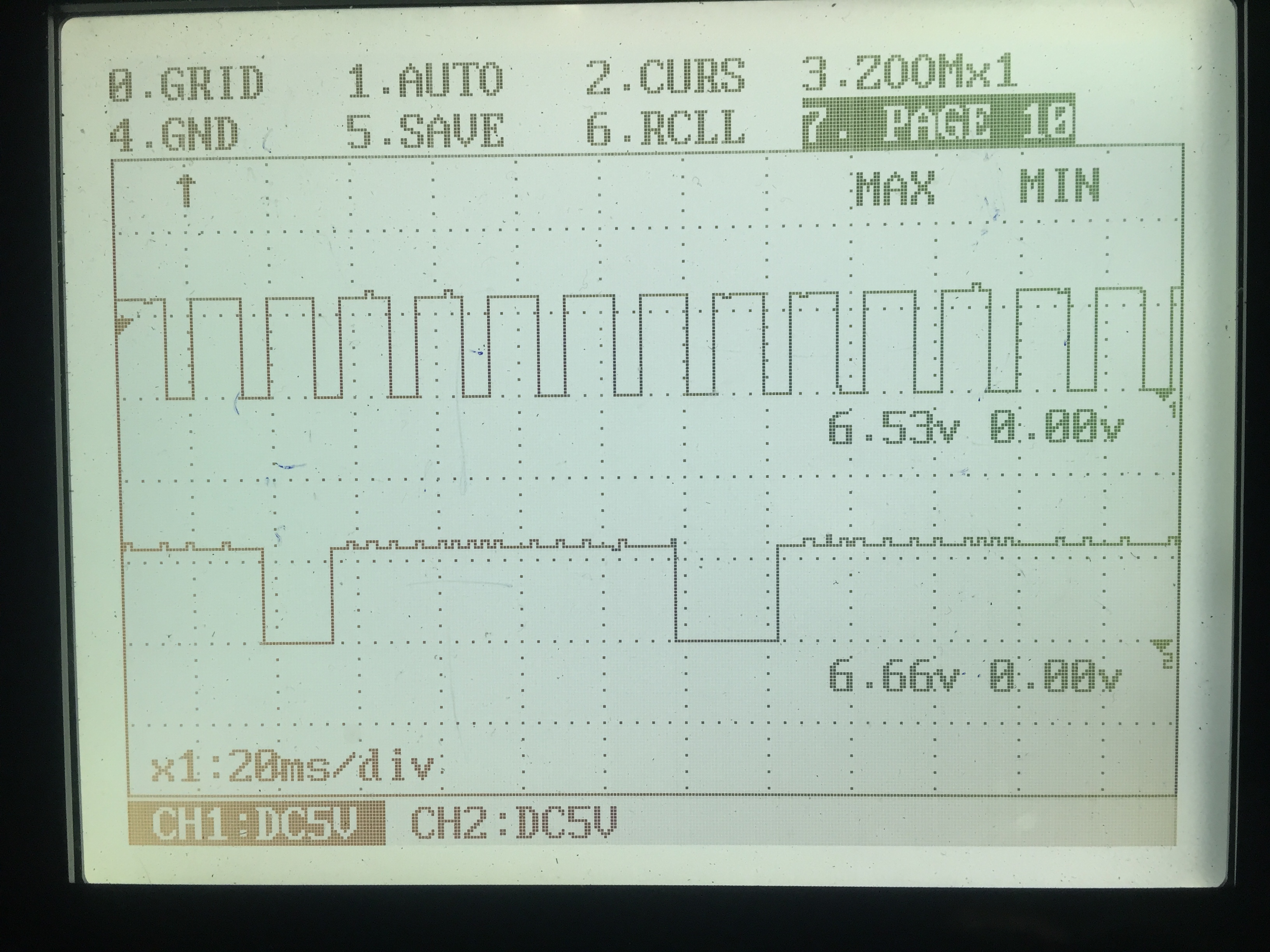

And some photos comparing signal from the bad sensor to the new one we fitted
ive seen that plenty of times with aftermarket cas's id never skimp on anything get genuine holden or delphi.
Wow, no problem with actual electrical noise, just completely out of spec length of the pulses in the signal! Thanks for posting that, exactly the very useful info we need but which is rarely available. The actual signal is probably discarded or filtered by the pcm as spikes of electrical noise.
