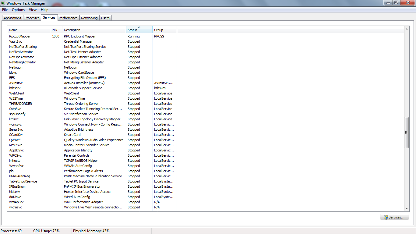

Getting weird problem on my laptop ,it's randomly loosing it's wifi connection, I tried another wifi module (borrowed from another machine) but the same fault, tried with a LAN cable, same fault. After the fault occurs you can go to the device manager and it shows the device drivers for the wifi and lan are ok and device is working fine. Not getting any error warnings from microsoft like you would normally with a software error/crash. When the fault occurs the machine won't shut down either, i have to force it to shut down. If I bring up task manager it shows a whole list of stopped services. Screen dump attached.
Seems to be worse when the machine gets hot. Me thinks it's a hardware error by any advice appreciated.

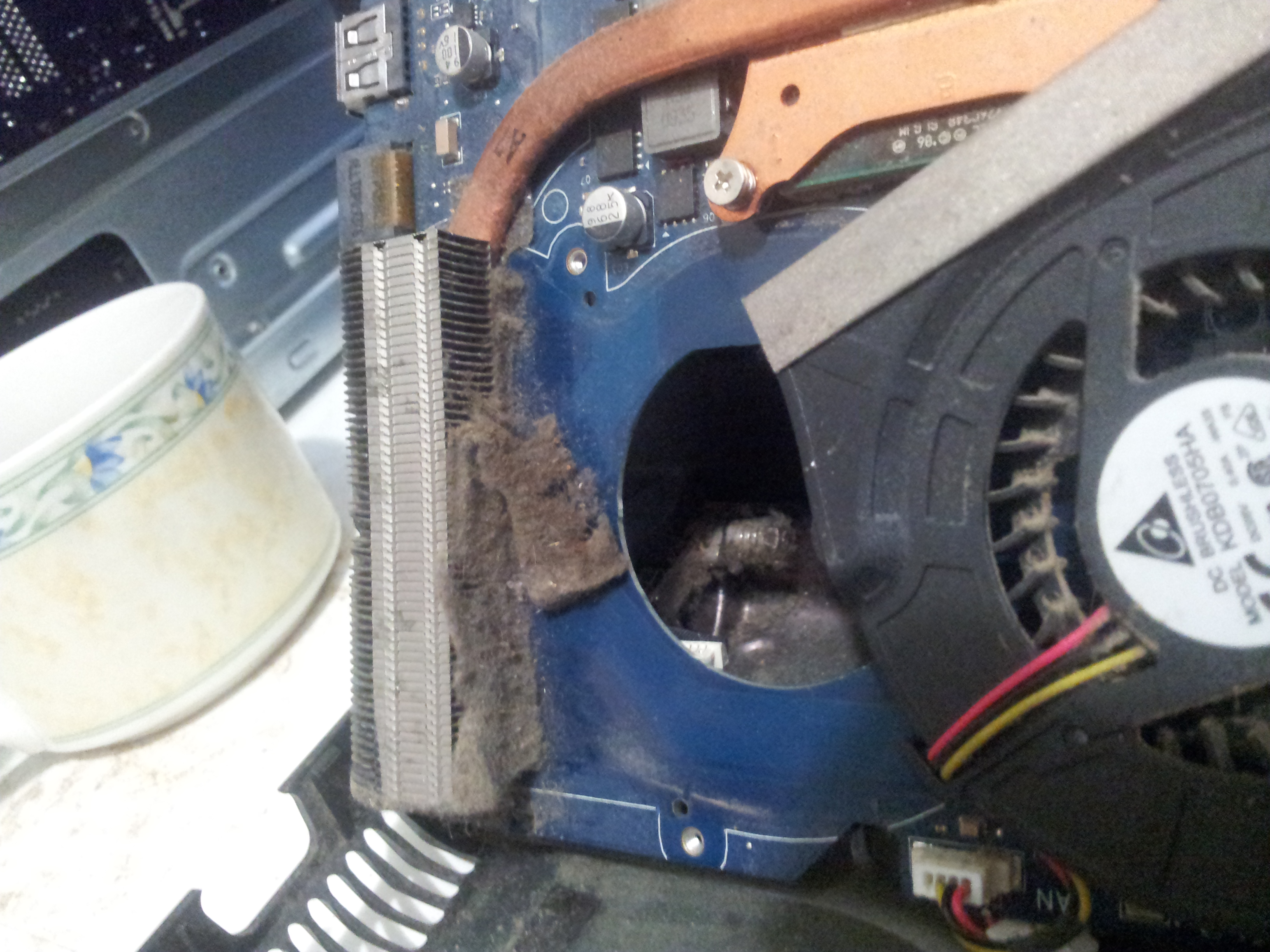

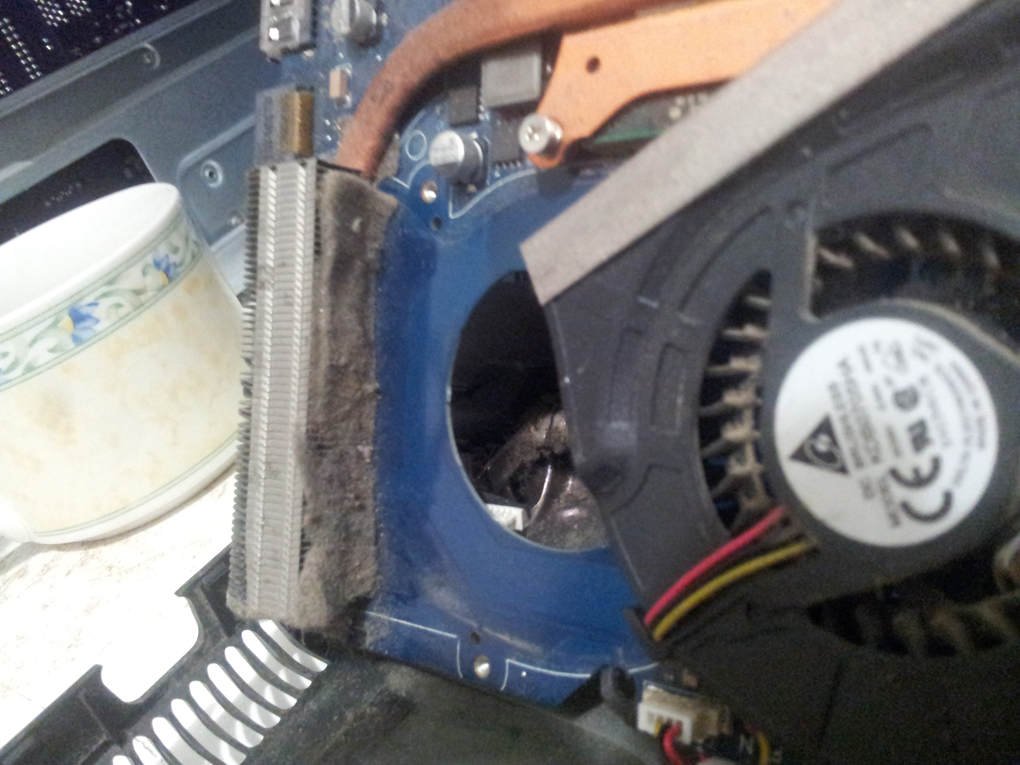

After many years my main laptop starting playing up to the point were it was unusable, so I reverted back to my old laptop. Sadly a dodgy power socket ended that exercise, so a few weeks ago I decided to strip down my main laptop for a look-see. This is what I found:
Needless to say the fan was having no luck cooling things down & subsequently the whole system would very quickly overheat and become unstable. I had to remove the motherboard in order to get to it, so it required a complete strip down, but once it was reassembled it was as good as the day I bought it. You could try blowing it out as slewinson suggested, but if it's anything like what I found then I'm not sure how much success you would have.
Good luck.
