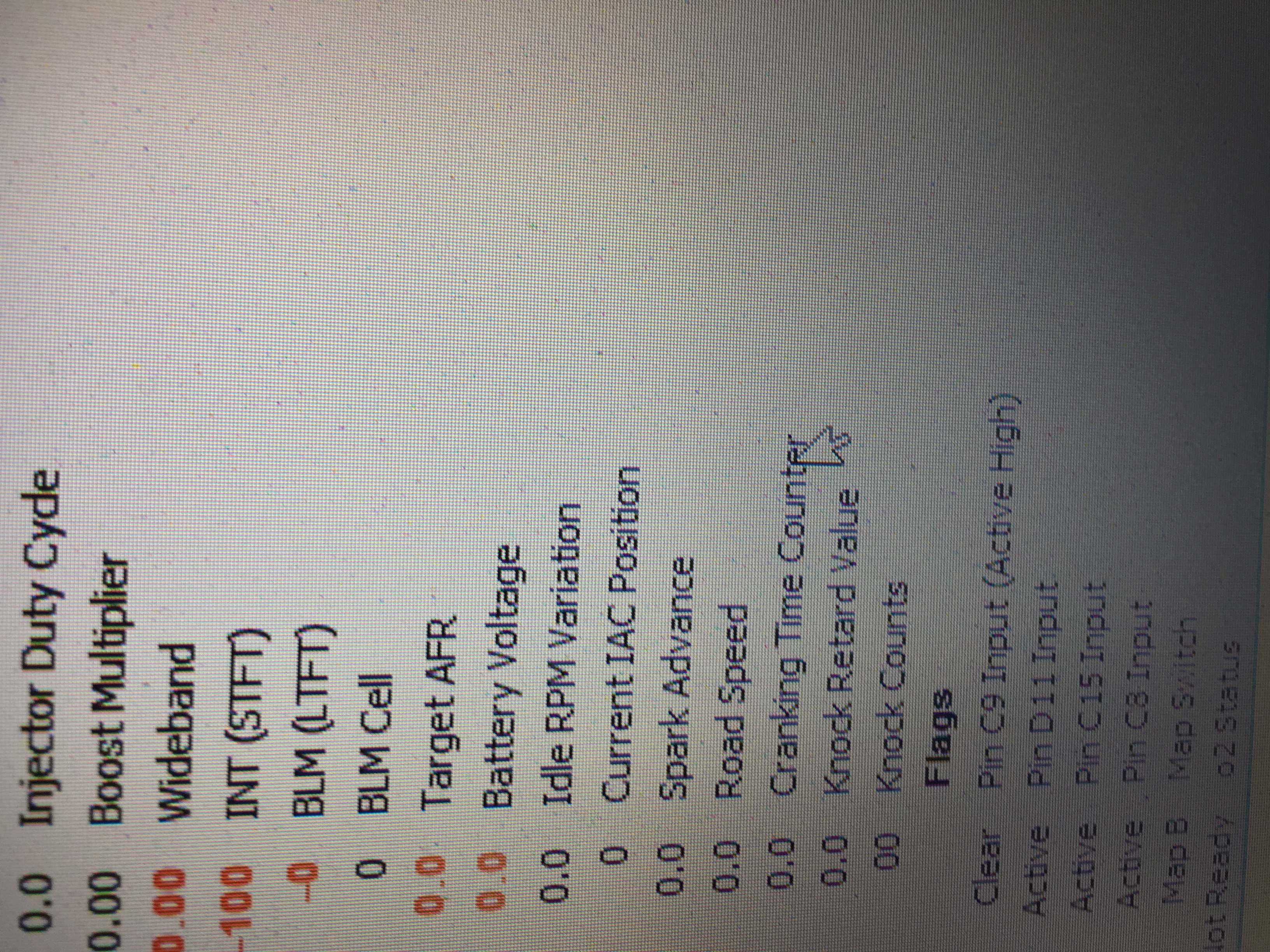

Another thing I've always noticed in tunerpro, when I go into data list views. The cranking time counter has always been highlighted red. Which normally means there's an issue there. Can any one point me in the right direction or shed some light as to what's going on there?

This is the cranking time counter I'm talking about. When the cars running and the laptops hooked up, it's red indicating an error
