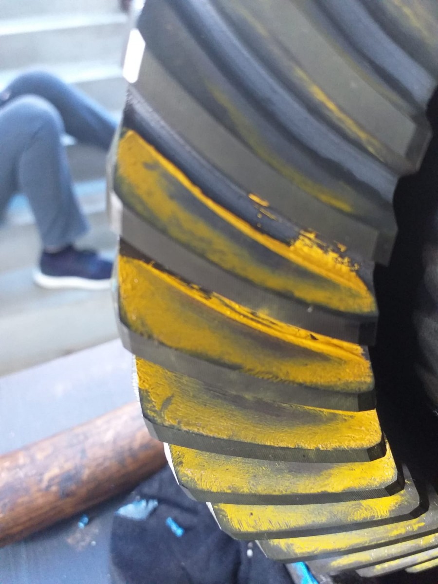

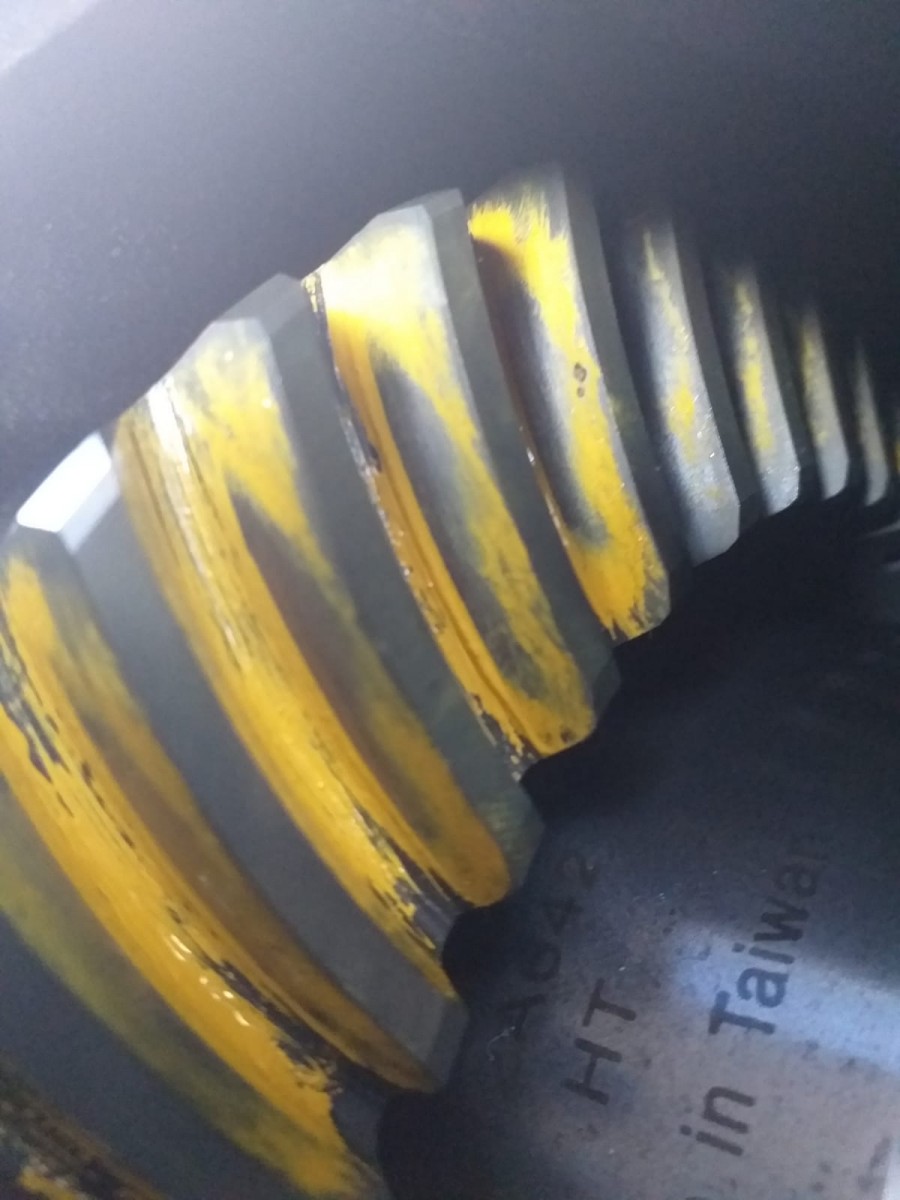

SO I got the diff back in the car but struggling with gear noise. First few laps around the block is was awesome but then as it warmed up the noise gets louder. I think it's gear noise so I took the diff out and adjusted the backlash, increased it a bit and put it back in. First time the noise was worst over overrun. Now it worst when just cruising. hit the gas and it goes away mostly. Definitely accelerating better and traction is a real bonus. This is what the gear pattern looked like this time around.

My only thought is maybe the pinion a touch to deep?
Using 80w-90 mineral oil as recommended by Motive Gears and Eaton Truetrac.
Also, A big thanks to Tazzi. Got a copy of his Body Diagnostics software to change the dash cluster.
I would check the pinion bearing pre-load. I had one destroy itself within a few Km. Did the same, was quiet and got nosier and noisier after about 1-2km
Posts: 3680
Yeah, that was my first though first time around. I reset the pre-load and I'm sure its within spec. I used the old string and weight scale method to check. They recommend 1.4 to 2.4Nm with new bearings and seal and we were right at about 2Nm.

Pulled the diff out and checked/stripped it down.
What we found, Backlash had increased 0.02mm and the pinion pre-load was slightly lower but still within spec.
Tomorrow we will clean and re-assemble. Will also double check the carrier bearing pre-load again. Otherwise I can't really see any reason for noise other than the gear set?
Posts: 3680
Diff is back in. Less pre-load on the bearings. Back lash and wear pattern look good but the diff is still noisy so I can only put it down to the gears :( Recalibrated the dash this arvo using Envyous customs software. Was definitely the easiest part of this whole gear swap saga. Literally 2 minutes and the job was done. Thanks Tazzi for the software.
Motive Gears recommend a 500mile break in period doing short drives to heat cycle the gear set. The crown wheel did show some interesting heat markings so I think I'm going to try that and see if the noise changes, hopefully the bitch will wear itself in and quieten down.
