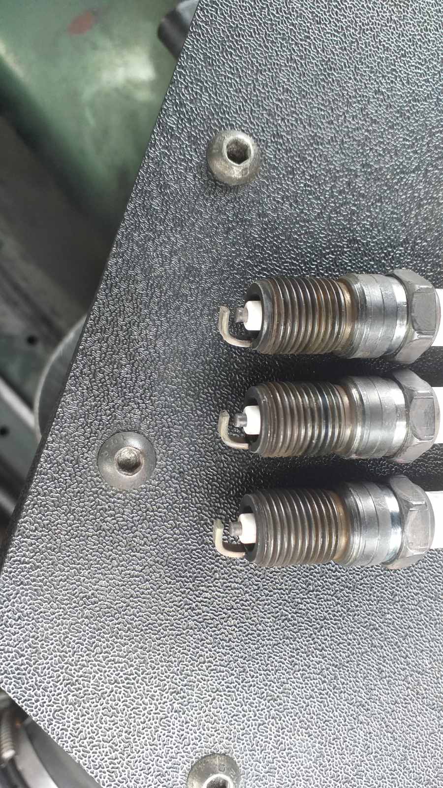

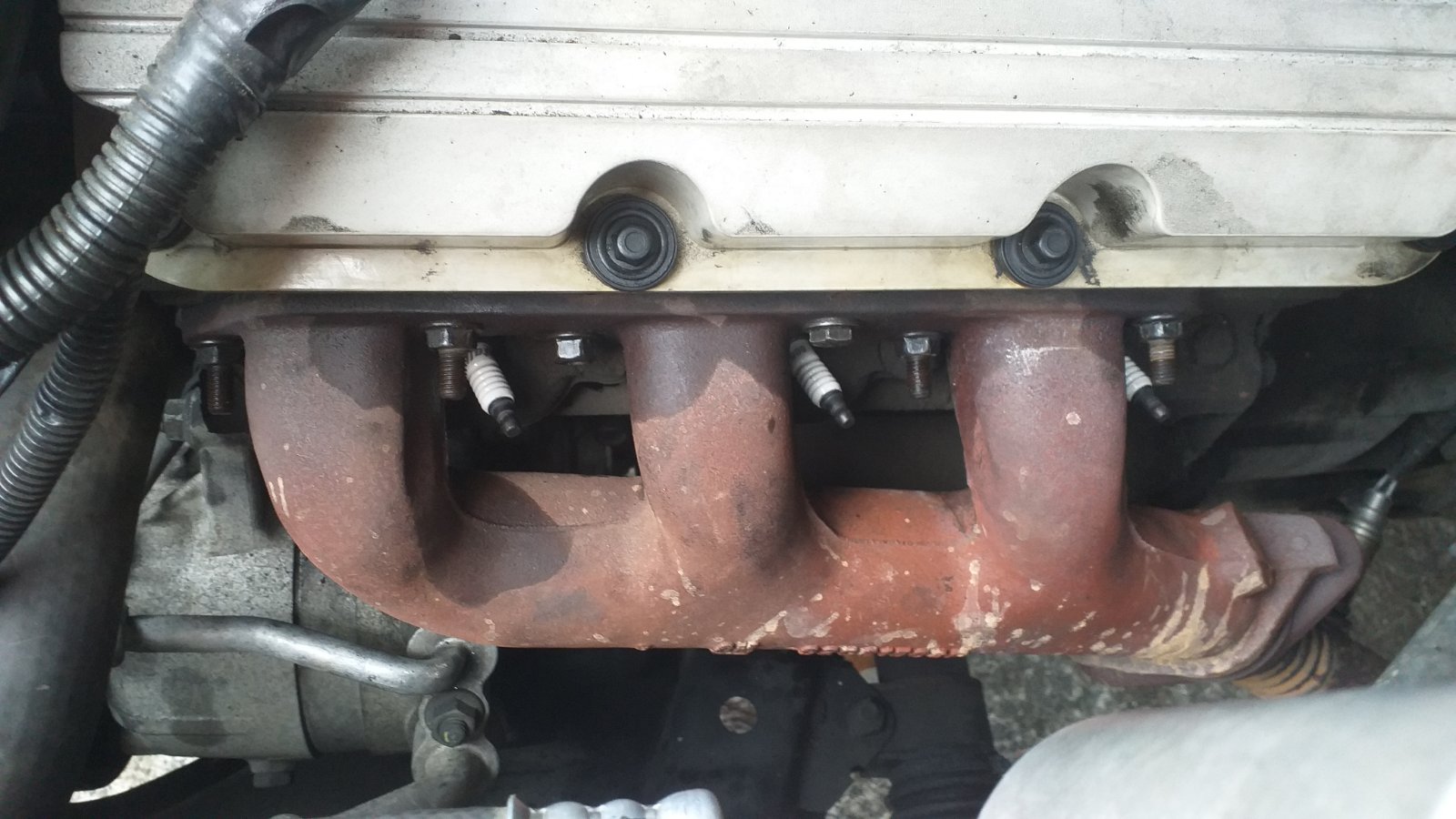

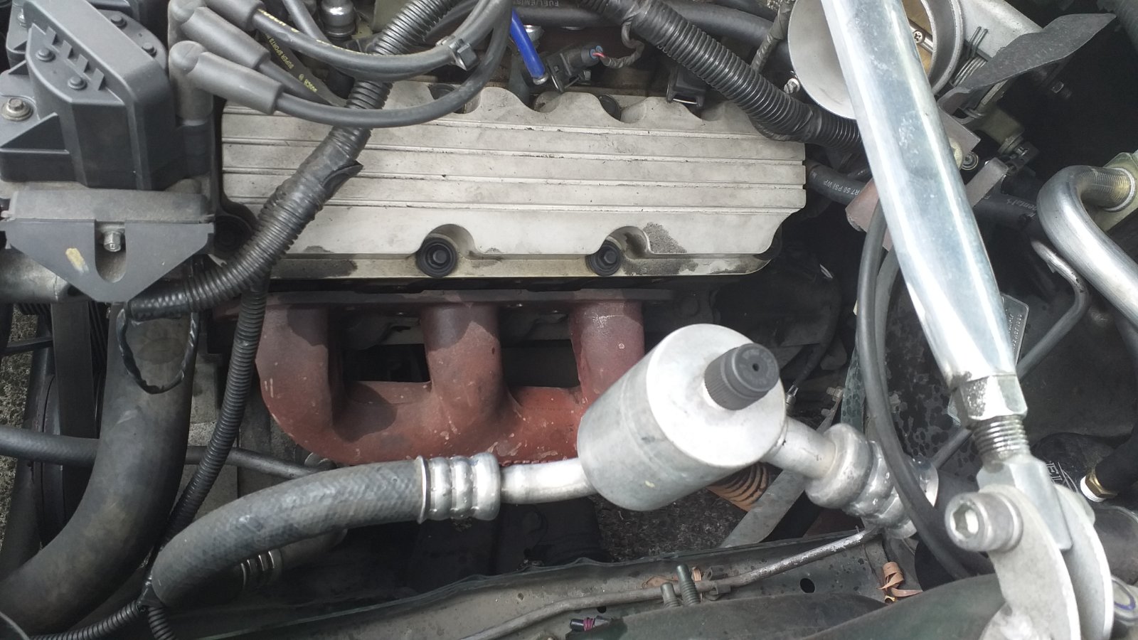

Well I don't think it's a plug fouling issue. This is after a drive and getting it up to temp.

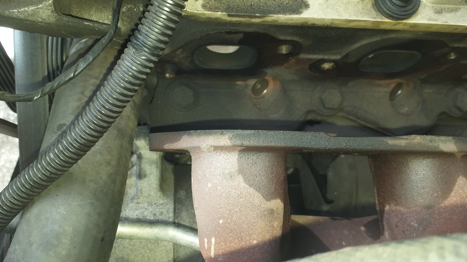

Got the manifold all loosed off. Need to drop the exhaust pipe at the flange under the car so I can rotate the manifold away from the head to get access to the broken bolt. All the bolts look to have some sort of loctite so it's not going to come out easy

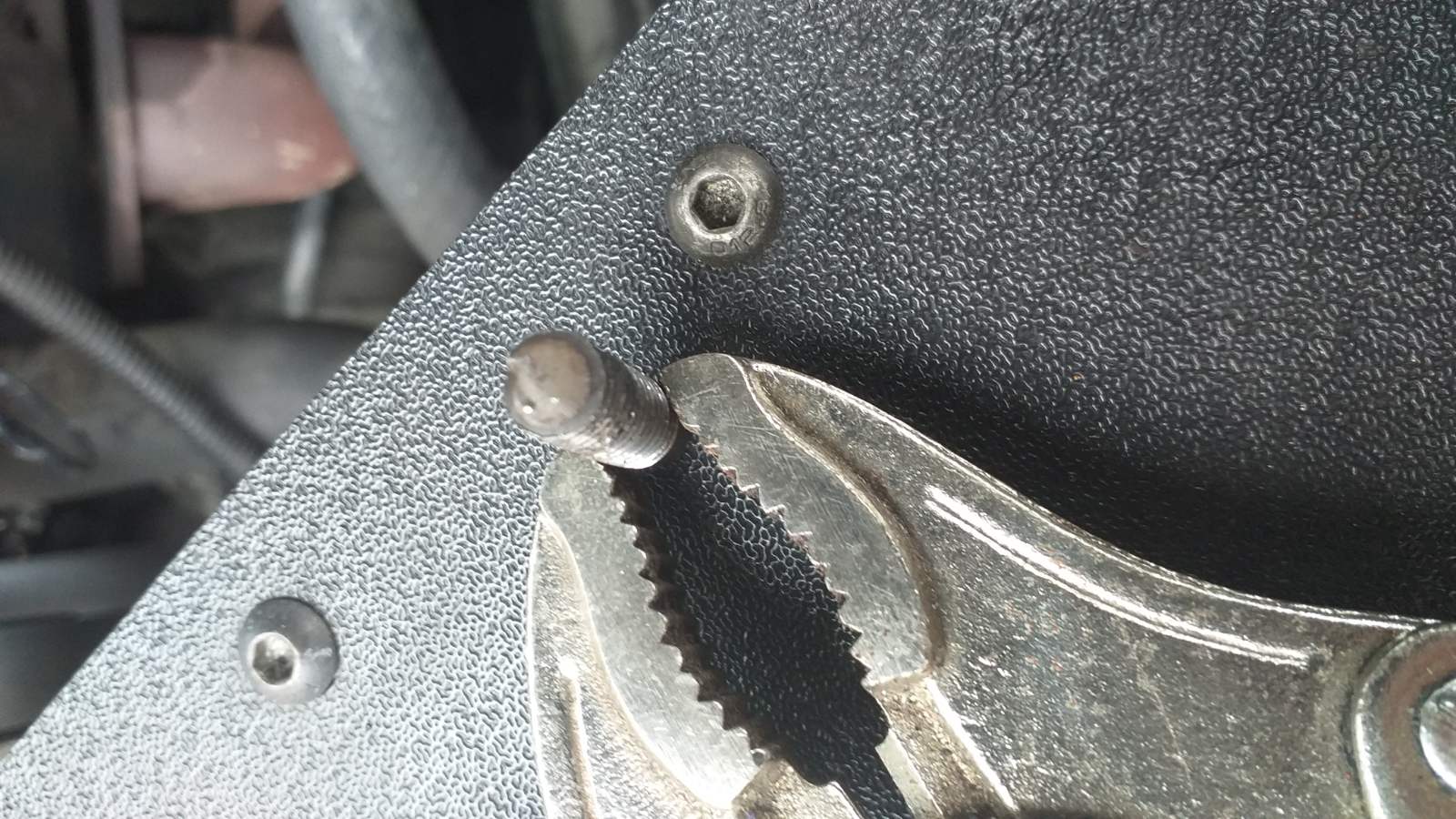

So there is the culprit. Got it out with some vice grips. There is not corrosion so this is a mechanical failure of the fastener. Cost cutting using smaller bolts? And all back together. I think I'll get some grade 12.9 cap screws and swap these out as there is no reason for these to break like it did unless it's a heat/expansion issue with the cast exhaust manifold.

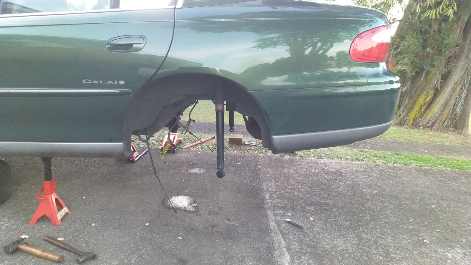

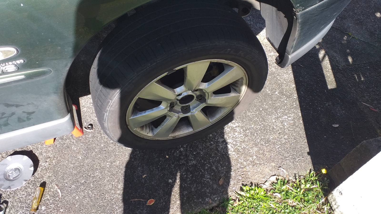

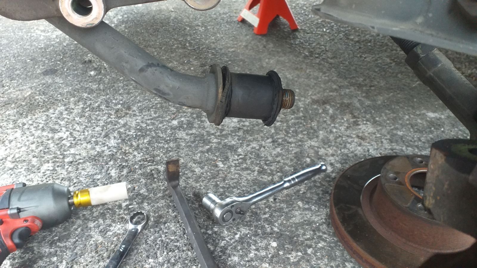

Got started on the front suspension this morning. Getting the passenger side lower control arm out wasn't to much of an issue. The only issue was the radius arm bush stayed on the radius rod and nut in the control arm. Was completely shagged.
Ended up having the grind the old bush off the radius rod and then still had to bash it off but we got it all back together so we can start on the other side tomorrow.

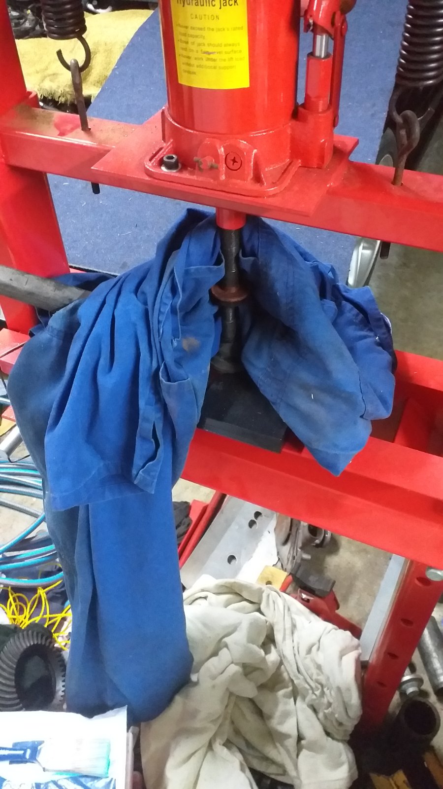

Life definitely easier with the press in the garage.
Safety first. Wrap something around the object been pressed to stop shit flying everywhere should it go wrong.Ended up having the grind the old bush off the radius rod and then still had to bash it off but we got it all back together so we can start on the other side tomorrow.

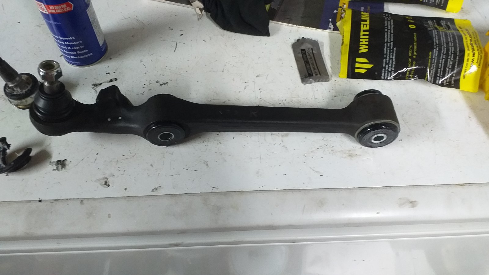

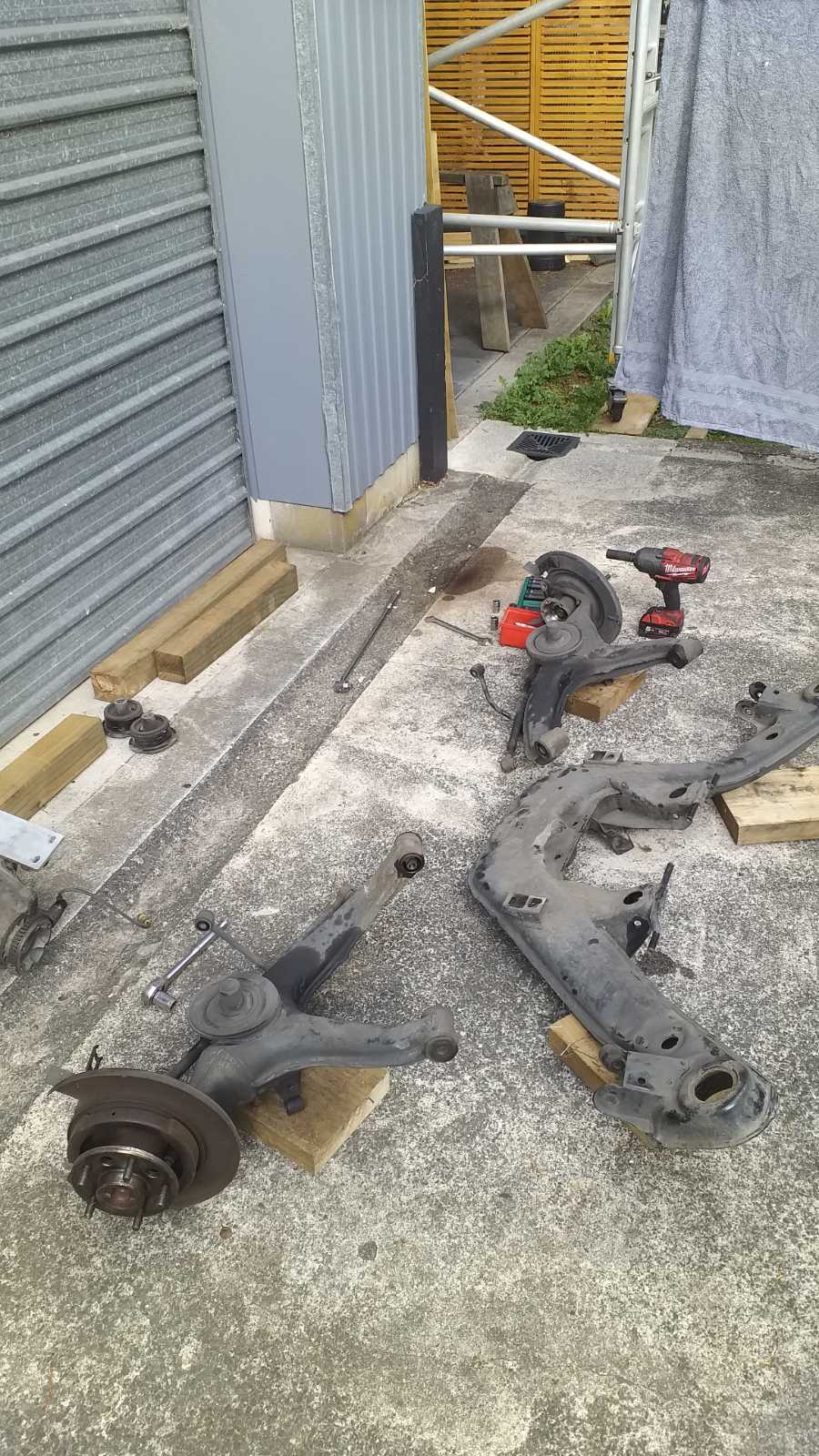

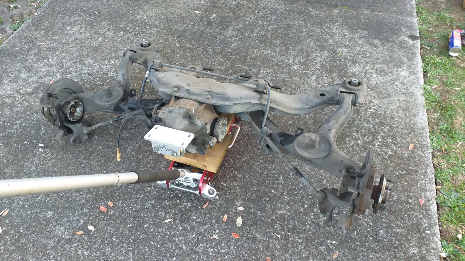

Yesterday was a rather bland miserable day but managed to get the drivers side lower control arm out. Fortunately only took about 25 minutes and the radius rod came straight out of the arm.
Today we went from this, To that in about 20 minutes. Just need to drop her down on all fours and torque the relevant bolts to spec.
Then about 2.5 hours later I ended up with this... Plan is to do all the bushes and then tackle the diff. We still need to clean everything properly and assemble it. Not sure yet how we are going to wash it all as I don't have a parts bath at home but we are going to figure something out as I really don't want to go through this again.

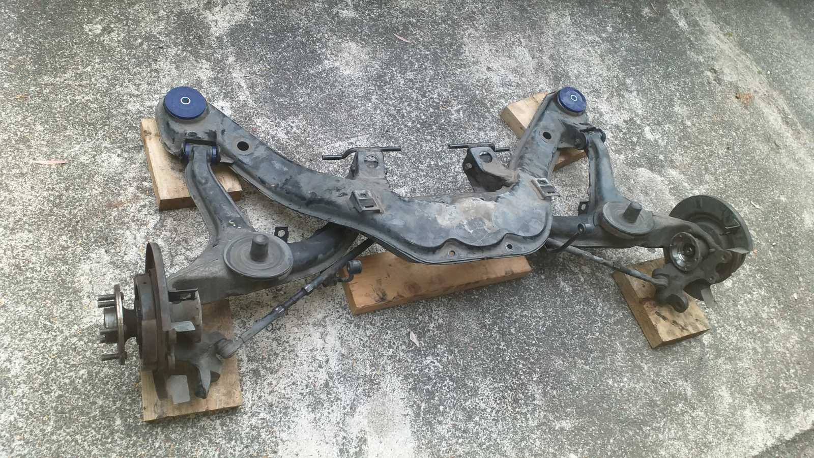

Slightly productive day. Started with stripping the subframe down to it's major components and removing the main subframe to chassis bushes.
Then we put all new Superpro bushes in and assembled the arms back onto the subframe. Tomorrow we start on the diff build.
Then pressed out all the old bushes. This been the later style rear subframe with the extra toe link arms it had these weird voided bushes on the one side with the body been some sort of plastic/fibre mix which did not want to come out.Then we put all new Superpro bushes in and assembled the arms back onto the subframe. Tomorrow we start on the diff build.
