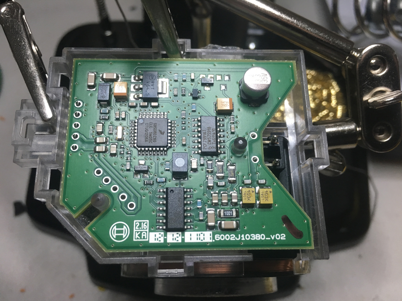

Maybe try grab the immo code form the immobiliser?
Quick look at it.. three main chips.
- MS9S08DZ60 = MCU - http://www.nxp.com/assets/documents/dat ... 08DZ60.pdf
- PCF7991AT = Send/receive key signal - http://pdf1.alldatasheet.com/datasheet- ... 991AT.html
- TH8056 = CAN transceiver
Could go on.. but.. dunno if nutting out how to get immo on public thread is a good idea? ahaha. Mght attract the wrong kinda people
*Edit.. quick pic inside....
