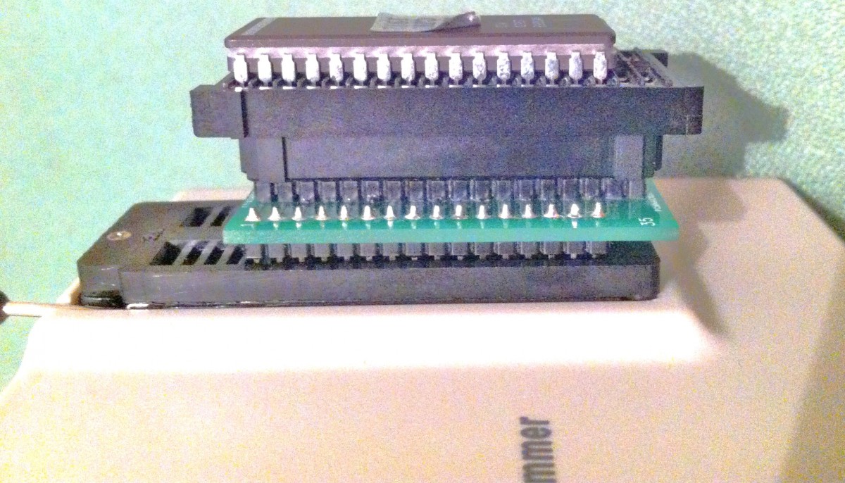

Post a pic of the adapter you are using,

Re: Stock VT memcal write fail VT SC Enhanced
View from both sides
- Posts: 4852
that looks correct, the memcal will go on the socket the same way it goes in a pcm, with the face pcm connectors guide. then pin 35 36 end goes to the bottom of the zif socket on the burner. Hope that makes sense.
It seems to make sense see pics of eprom in programmer it all appears to be correct but still the same result no ID
