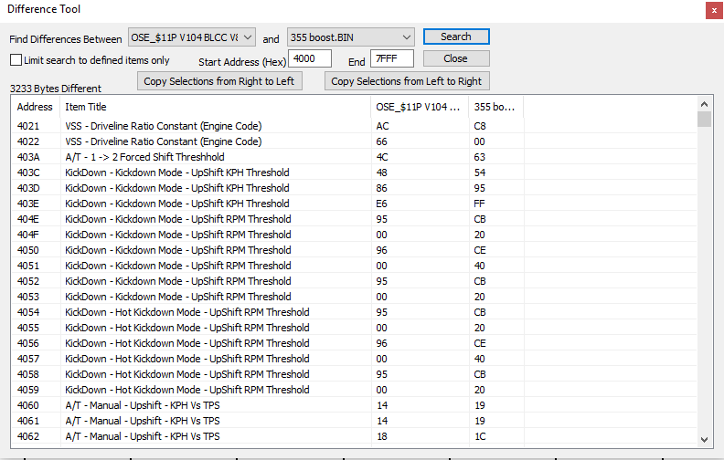

done a compare to the std 11p blcc bin? theres 36467 bytes different!! whats going on there?

PaulR wrote:done a compare to the std 11p blcc bin? theres 36467 bytes different!! whats going on there?

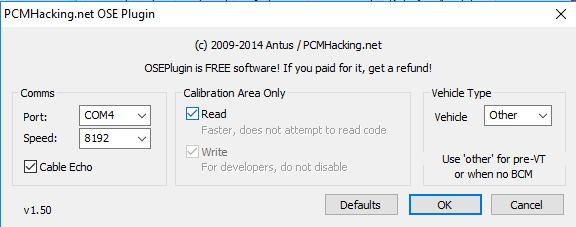

Your posted bin only contains the calibration, not the 11P operating system, ALDL responses or os update over ALDL segments. Use the delco flashtool to get a complete bin, or disable the oseplugin optimisation calibration area only->read. It'll take more than double the time to read but will give you a complete file (which will have more than required - it'll contain stuff out of the PCMs RAM too, but thats not a problem). Its a lot quicker to work with calibration area only but you should be aware that your bin wont work if directly flashed to a chip.
If you need to start again from scratch because the OS isnt running and you cant connect over ALDL and you want to go back to that cal you would put the stock 11p bin on the nvram with a programmer, then use tunerpro or the delco flashtool to upload the calibration over aldl. That process will merge it back together for you.
calibration area only.png (12.49 KiB) Viewed 3985 times
Use the tunerpro difference tool and restrict the range to 4000 -> 7FFF to identify calibration changes in 11P and skip over the missing segments.
11p calibration differences.png (40.59 KiB) Viewed 3985 times
