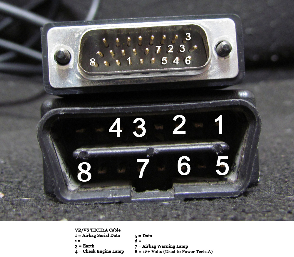

Good work mate, i did this a while ago if you want to compair.

Thanks The1. Is that VT tail light connector in the 1st pic?

the plug is a toyota factory headunit plug.

Well going over your pics with both the VN and VR type connectors it appears as though the 160 and 8192 baud rate data are located on teh same pin in the dsub so that means in teh 2 row dsub the correct pin is pin 9. Your a legend The1 Thanks for your help.

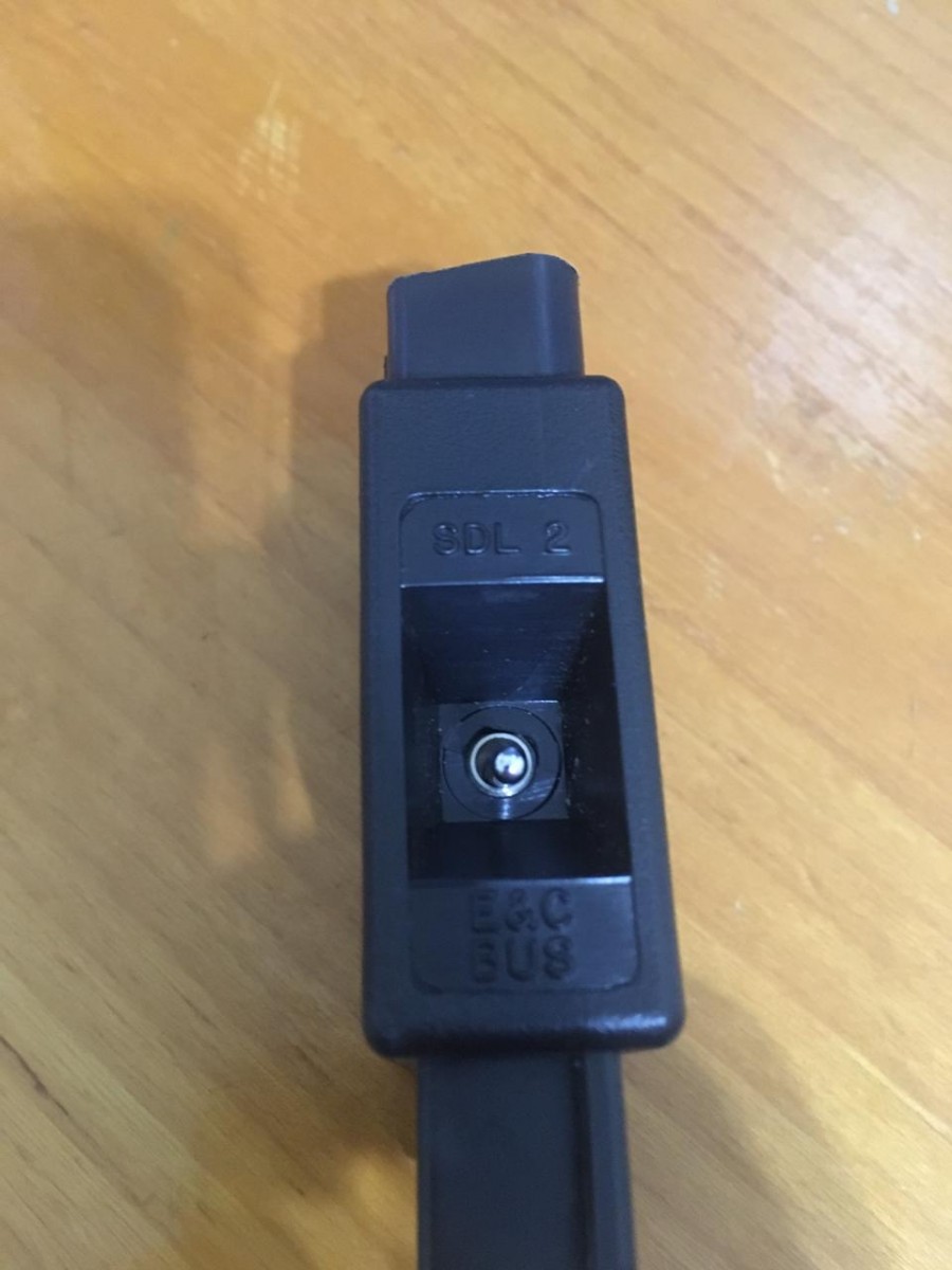

just take note some connectors have a switch on the side of them.
MAGP
- Posts: 665
Re: Tech 1 cable pinouts
Yep. That adapter has me a bit stumped at the moment. The wire that is switched goes to the power wire on the aldl connector but it goes to a different pin in the dsub. It's an on/off switch for something in the Gen2 LT1 from what I can figure out. US vehicles need a different base cable that has a cigarette lighter plug to power the Tech 1 so the wire we have in our cars for power supply is free in the aldl connector fitted to US vehicles to be used for other things.

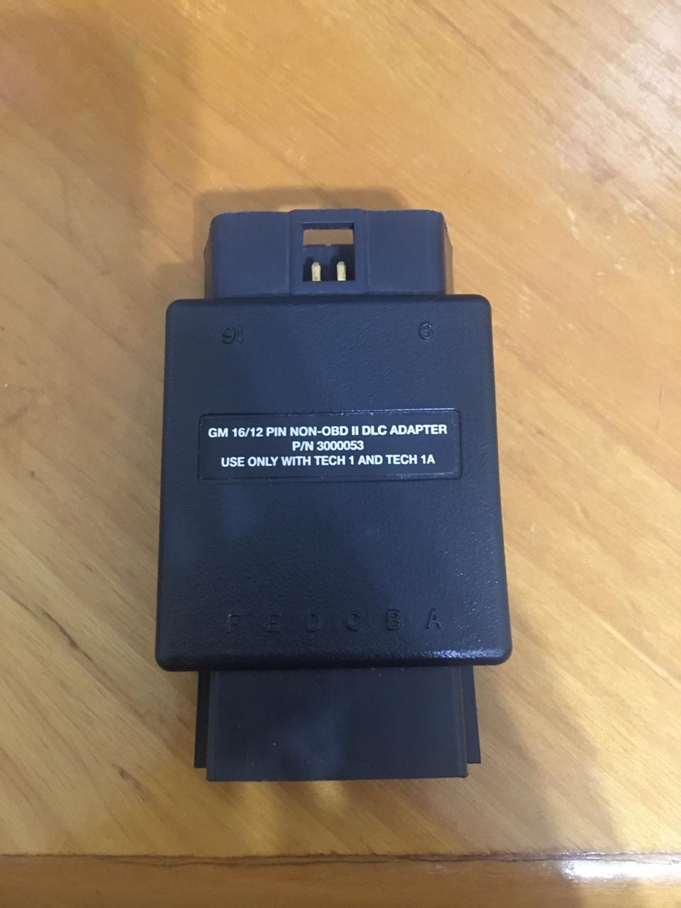

My contribution:
GM 16/12 Pin Non-OBD II DLC Adapter
P/N 3000053
GM 12 pin <----------> Non-OBD II 16 Pin
A <----------> 5
B <----------> 6
C <----------> 3
D <----------> 11
E <----------> 5
F <----------> N/C
G <----------> N/C
H <----------> 12
J <----------> 1 (SDL2) 14 (E&C Bus)
K <----------> 13
L <----------> N/C

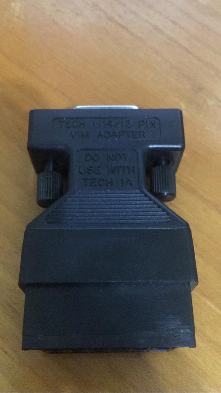

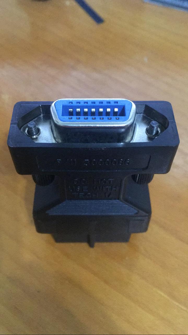

M <----------> 9 Tech1 14/12 Pin VIM Adapter
P/N 3000086
GM 12 pin <----------> 14 Pin Centronics
A <----------> 6
B <----------> 5
C <----------> 3
D <----------> 2
E <----------> 1
F <----------> N/C
G <----------> N/C
H <----------> N/C
J <----------> 4
K <----------> 11
L <----------> N/C
M <----------> 13
