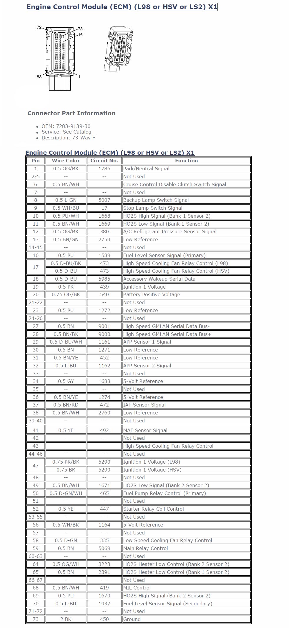

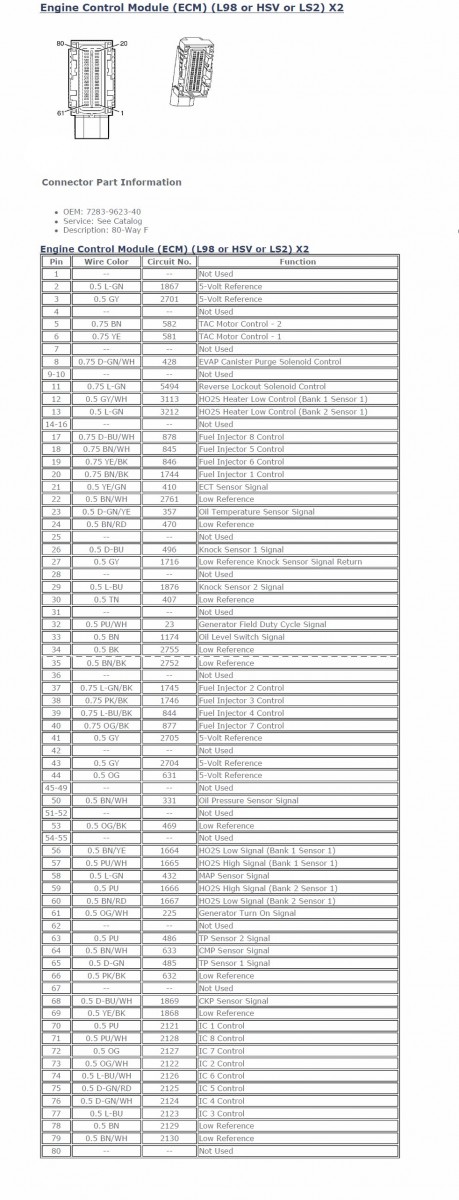

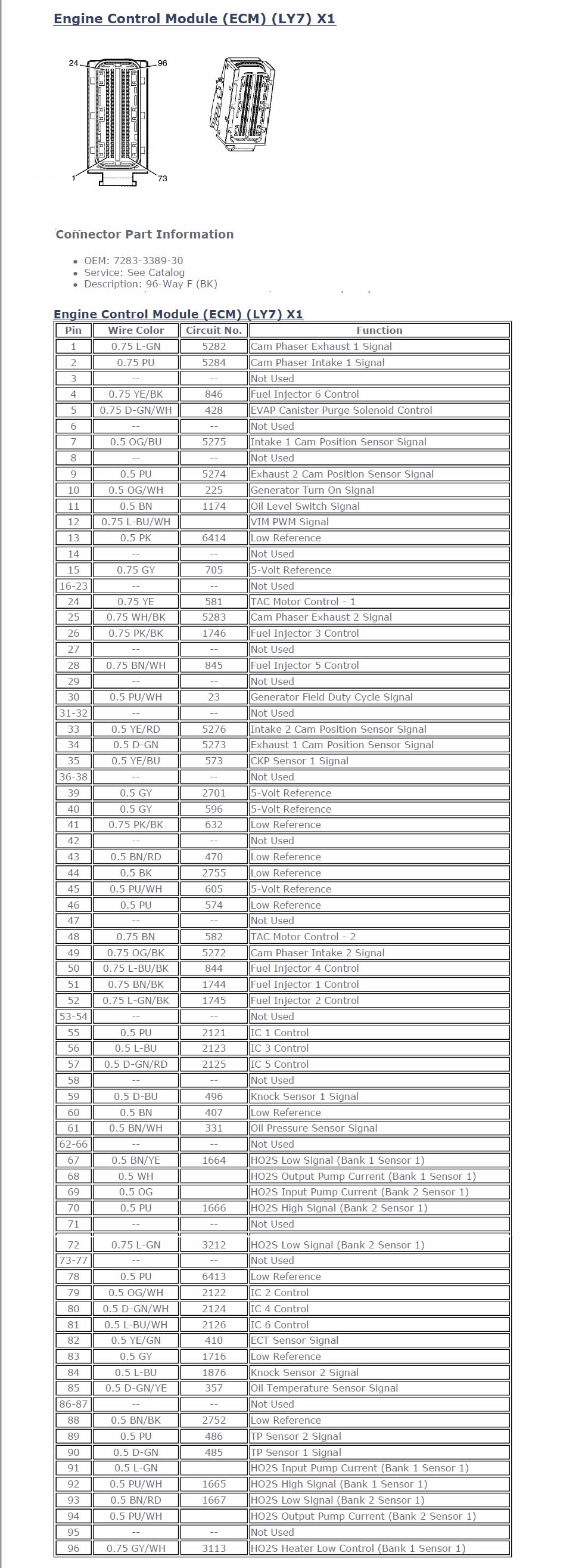

VE V6 LY7 & V8 L98 LS2 ECM Wiring Diagram
Wiring diagrams and questions
Posts: 4810
