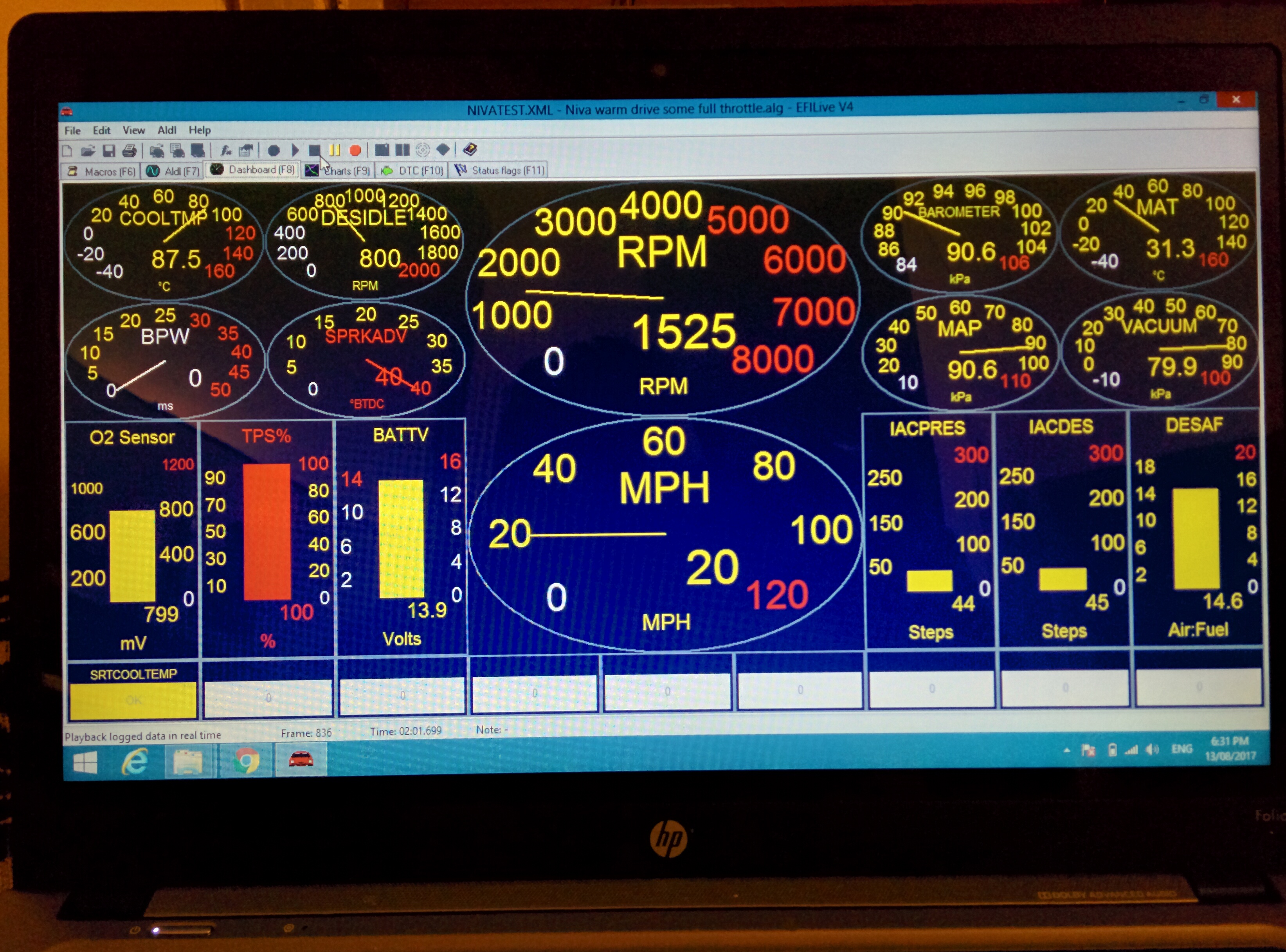

I built an ALDL interface and bought a full licence for EFI Live. Im using a definition created by a Lada fan decades ago, this is working well enough for basic stuff but there are no macro's or anything, cannot send commands etc. Also the timing stats are wild and I think, inaccurate. (60BTDC..)

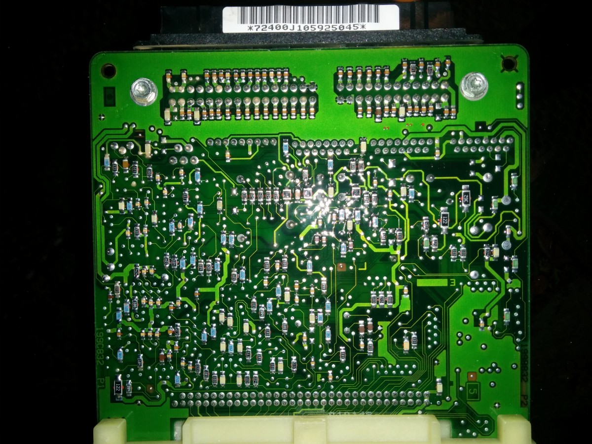

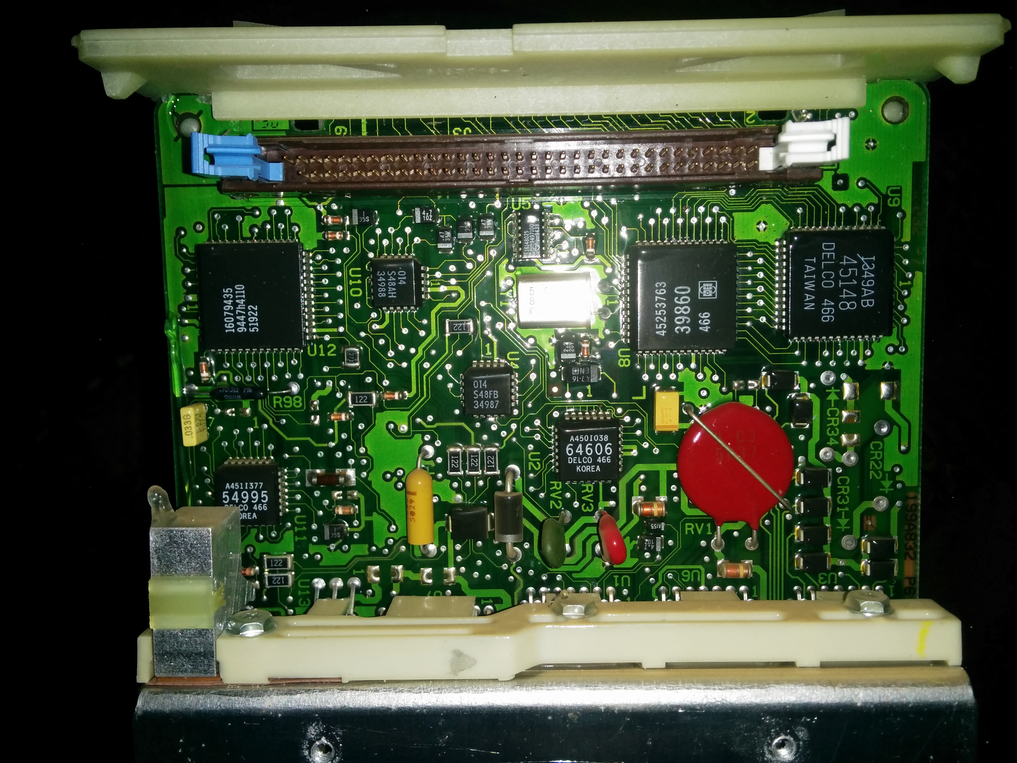

Can you post up a picture of the circuit board?

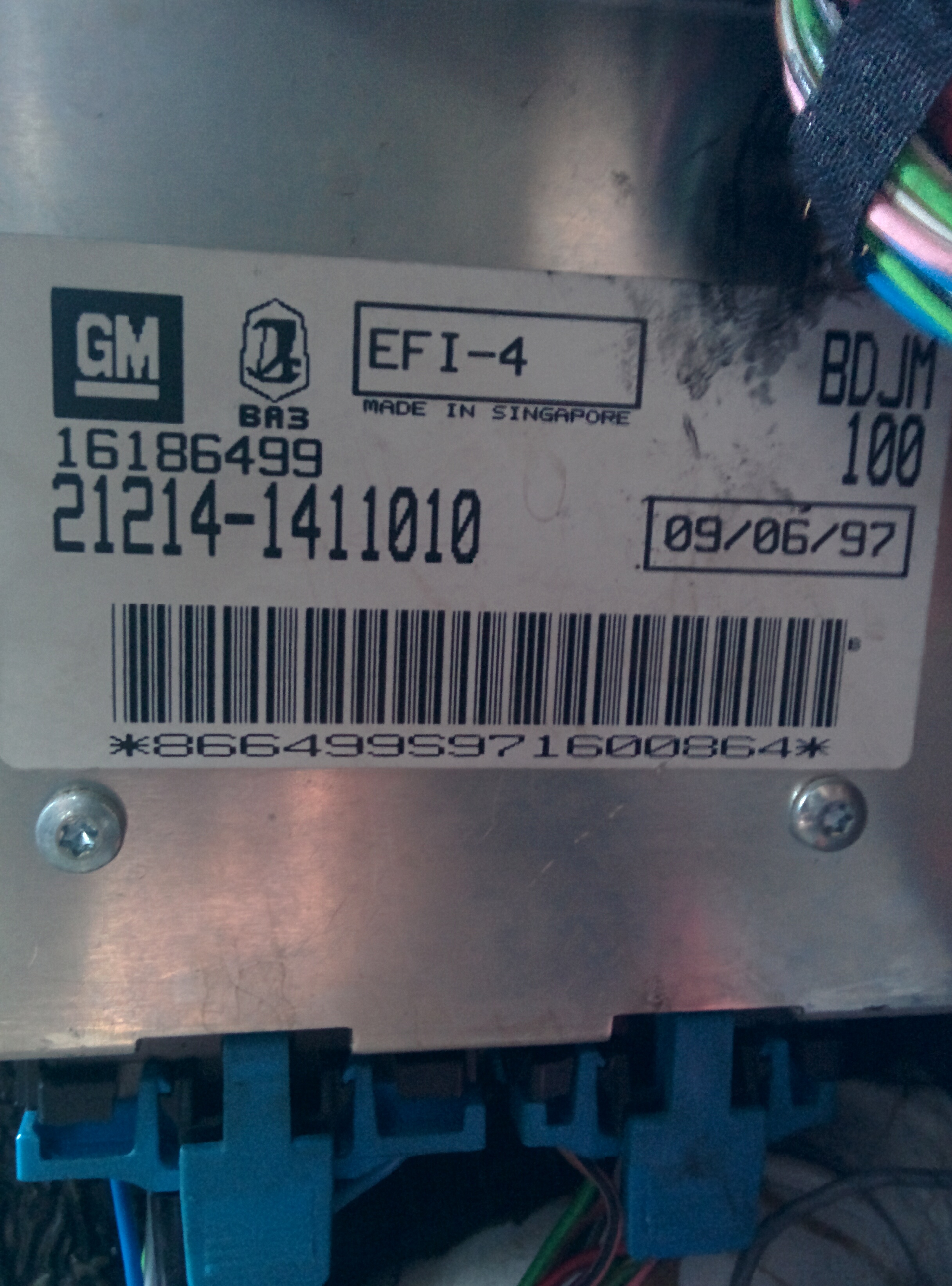

Its definitely 8192.

I mainly want it as an accurate troubleshooting tool so just unsure how you actually go about identifying the correct values for the various items. As I mentioned the timing stats are just wrong, or at least I hope they are! Haha.
Yep ill take some pics shortly, ive got a spare ECU.

Here you go.

Could be worth looking at running a 082 or a modded 808?

Yeah they are older holden ones. Same size, same connectors, very similar. But you would need to compare wiring diagrams and see if any pins moved by the time this computer came out. Ive looked at a lot of simialr daewoo computers and they look pretty similar but have a newer ignition system. Your ignition being different would be the most likely problem with that idea.
A quick google just found this pic here https://pcmhacking.net/forums/viewt ... =30#p34314 which will give you an idea how similar they are. Most the chips have the same numbers on them. That one I linked has the high speed comms chip, as does yours. The main IC numbers (U4, U8, U10, U11, U12) all seem to line up, so they are very closely related.
If you swapped to that computer you could run this software viewtopic.php?f=27&t=356
Theres a small chance that it'll also just run on your computer, but I wouldnt count on it. Surely some small detail will cause a problem. Would be interesting to burn 12P to a 32K chuip and test it, see if you get data out of it but dont try and start it with out some kind of tune work.
