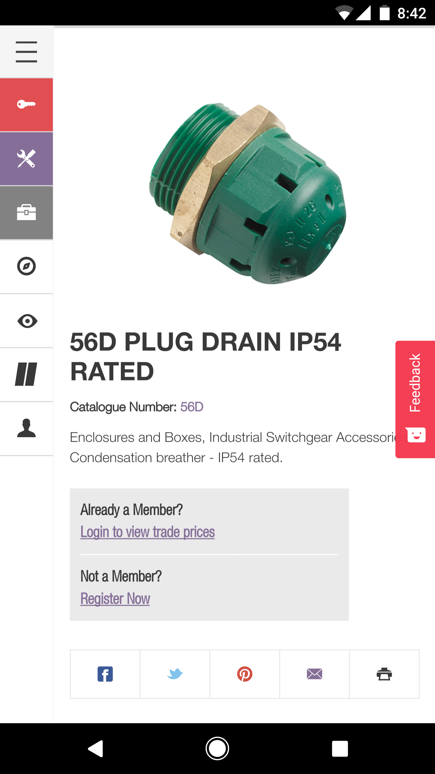

I'm with Jenko on this problem, being a speedway guy, we get dust and water everywhere... my 424 is inside an ip rated electrical box, it has a water proof round deutz connector to the outside of the box. All this is great except I still get moisture in side the fucking box... :evil: I assume its condensation and it needs an air vent of sorts? Like the late model Bosch pcm's?..

You can get screw in breathers for them I run them on other IP rated enclosures in hot wash environments. I'll try and dig up a picture.

Post by Dylan »
Clipsal part number 56D. Can be mounted on the top of the box as a breather or the bottom as a drain or both. They don't let moisture in. Are a 20mm thread size.
Posts: 2678
Re: water resistant /proof ecu housing
Legend :thumbup: thanks Dylan
