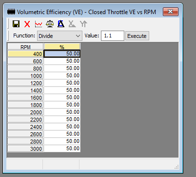

Probably a combo of both, sounds like not enough air as one problem. A common trick it to drill a hole in the throttle plate as seen on many factory cars including LS. Also in my experience is sometimes tuning the fuel around idle with a bigger cam there often is a delay from commanded fuel and it finally reaching the WB and then the WB response time on top as well make a situation that you end up tuning either a rich spot or lean spot which is self positive feedback with hunting making tuning by the WB throw it out even more, making it hunt more and so on.
I often found it to be a lean and rich spikes diagonal from each other where the hunting loops through. Sometimes you need to forget the data and numbers and looks at the pattern in the VE table and fix up the idle area to look more logical. Basically smoothing it out to the average in the surrounding area. That should help a heap.
Can you take a screen shot and post your VE table?

I hope this is what you want. I'm 100% brand new to efi and i'm completely self taught from this forum. I'm super proud just to get this thing started and running.

yeah I agree, I would aim for around 13:1, but it may well be that its not in closed loop idle and using the main table which is about what you have for those areas on the table, ok to cruise on but useless to be idling on that.
I can't recall exactly but I thing there is a scalar somewhere to tell it when it is to use closed loop idle, like the kpa it suppose to expect for idle I think?. You can see in the main dash there is a block called "close loop idle" it goes green when its active. that will tell you what its doing.
Otherwise the cells in the VE table look right for the engine, nothing too out of the ordinary.
