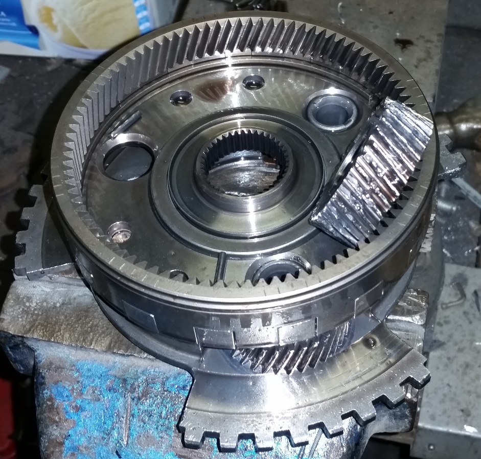

I had a look at an exploded view of the box and there was a reaction carrier which is splined to the low/reverse clutch pack so I had a fair idea the issue was in that area somwhere ...

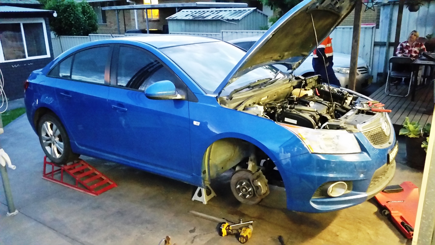

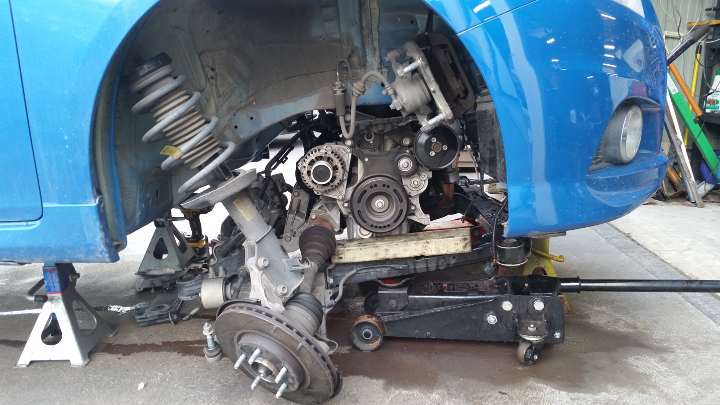

so the mammoth task began of pulling the gearbox out, which for anyone that's worked on a FWD car might know you have to remove the whole engine and gearbox plus the cradle it sits on to get the two apart! ... not so easy in a driveway, and the pain was increased by the fact its a turbo with all intercooler piling and such to remove aswell .... but we got there!

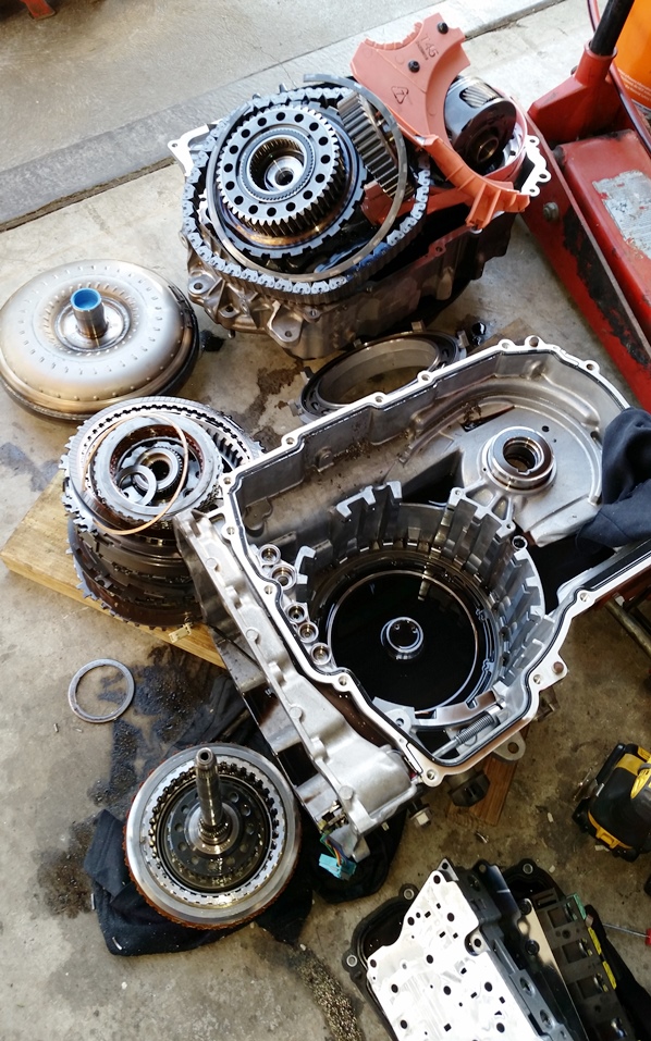

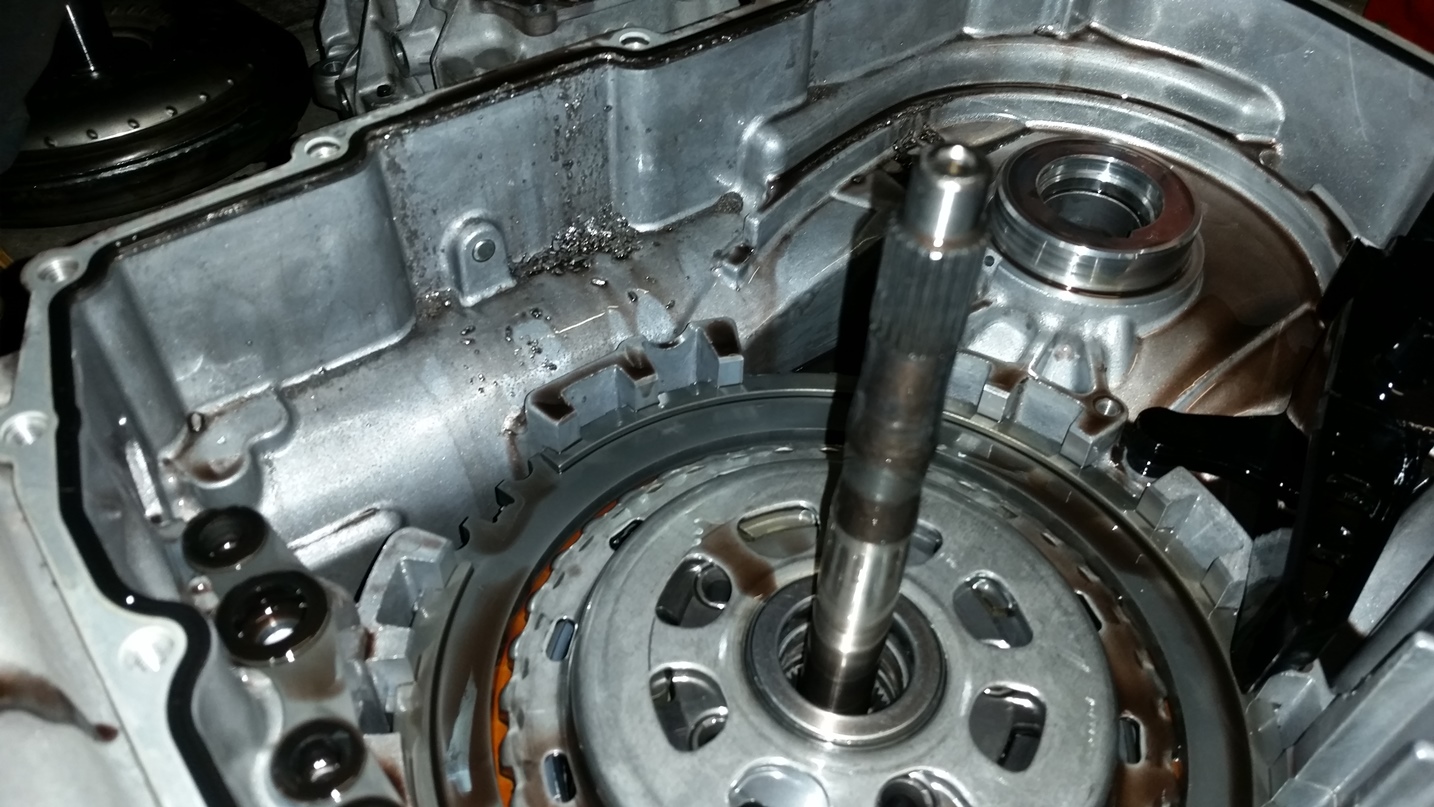

So once the box was out and split in half it was pretty clear that there was some damage done somewhere but nothing was obvious at that point.

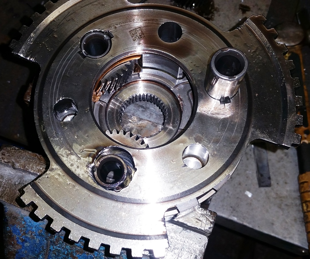

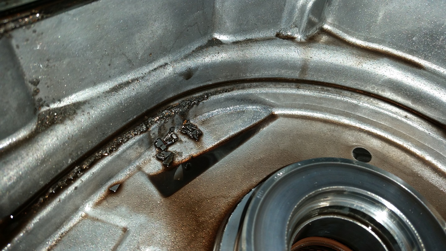

So with a bit more pulling down we got to the area we needed, and as it turns out the reaction carrier itself was the issue, and it looks like whats happened is it hasn't been able to handle the extra power and has just flogged out the pin that holds it in place, then in turn sending needle rollers through everything.
I hammered out one of the pins to confirm there should in fact be needle rollers around the pin as there wasn't a single one left in the flogged out one lol!!

I did do some searching and the higher rated boxes have a reaction carrier with 5 gears and also 4 tabs on the back to spline into the clutch pack .... so maybe it could be made to be stronger, but for me I will just turn the power down and be done with it.
on that note, I have found a gearbox at a wreckers with 12,000kms on it and its delivered to my door for $1600 with 3yr warranty so I can't beat that I don't think.
all that was left to do then was to re-assemble this mess and add it to the metal recycling pile!
its interesting to see how compact a FWD 6 speed auto is, but i guess obviously at the cost of reqduced strength....
