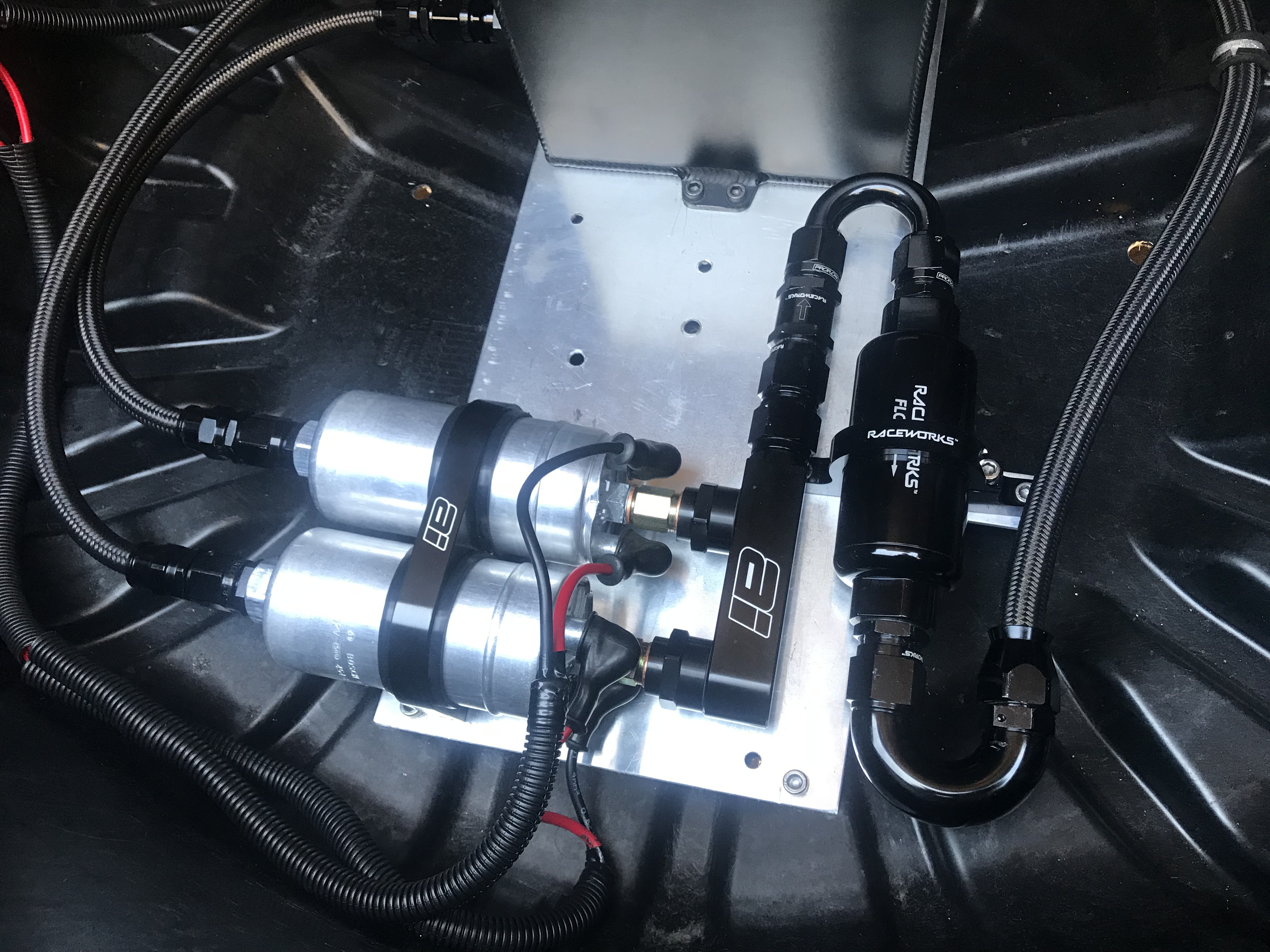

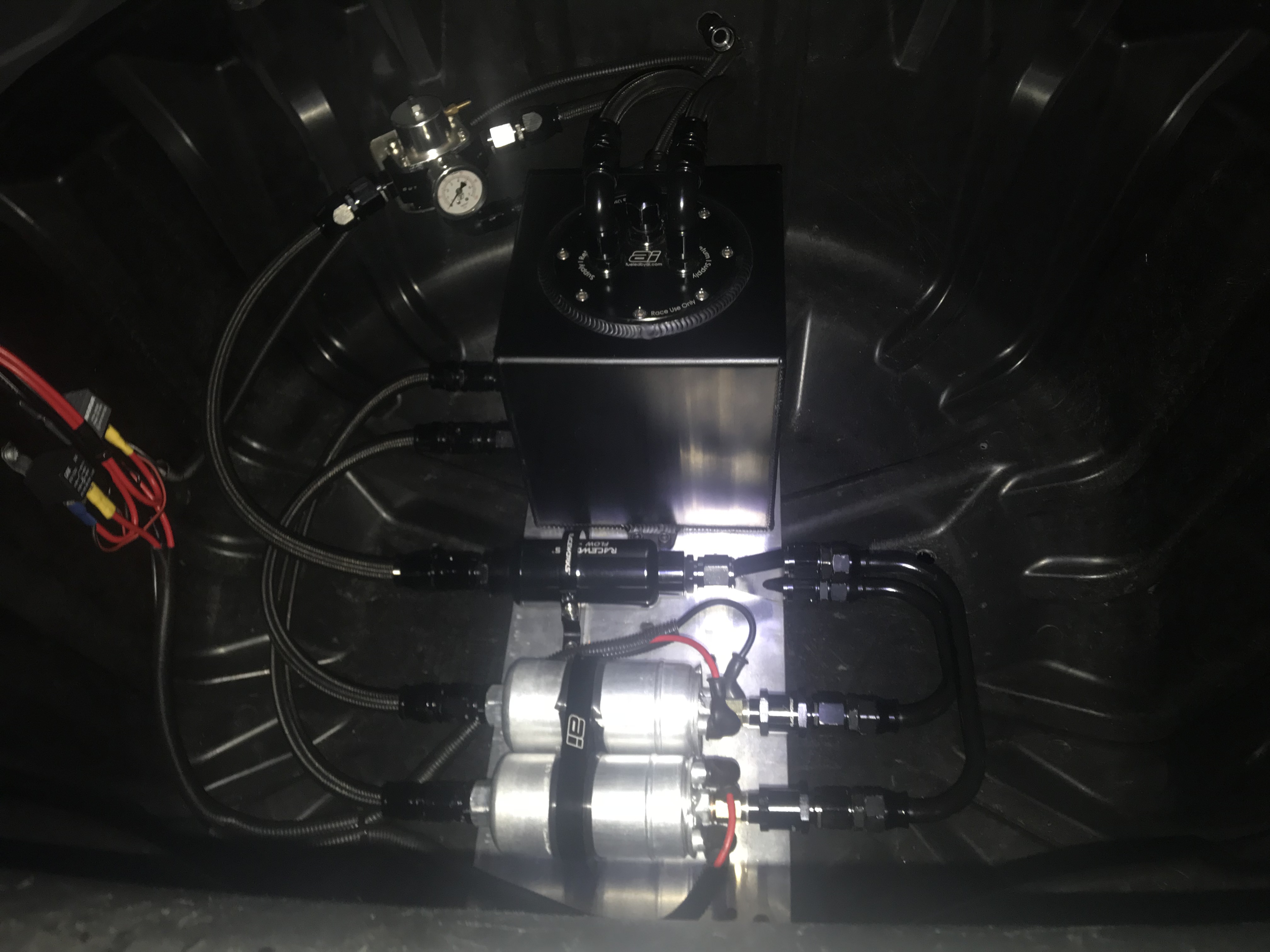

I’m wondering if anyone has used a stand alone pwm controller to control fuel pumps?
I have full external fuel system with two 044s but they are circulating too much fuel and it’s heating up, I’d like to slow 1 pump right down till it’s needed. Any info or directions would be great.

Current setup
Ve ss ecu
Intank pump feeding surge.
I have two o44 pumps.
One I’d like to run all the time. Second one I’d like to run pump at slow speed and ramp up according to demand. Ideally a controller that can monitor and maintain a set fuel pressure.
I currently have 1 pump running 100% and other pump turns on via a switch. I do have a Hobbs but I’m trying to stay away from that option. Pwm controller would be so much better. There is a small raise in pressure when second pump is activated (2-4 psi) which isn’t a issue.
