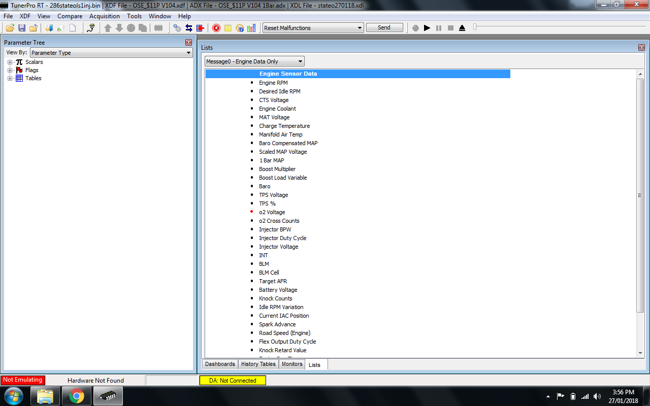

i have been trying to find a fix for this but am stumped, whenever i'm logging or playing a log there's no real time data shown in the list tab all it has are black & red dots.
I've tried different adxs for both 12P and 11P and updated all software but still shows the dots, is there something im missing eg a setting or tick in the box?
its making it really hard to analyze the data its doing my head in! :rant:
if anyone has info to pass on that'll be much appreciated.

I cant say ive ever seen that, post up a log and the adx file here we can see if its replicatable.

Thanks 202T here is the start up log from this morning
Re: Logging & playback list data missing
Had a similar thing with the latest release (build 9130) showing small squares .. https://pcmhacking.net/forums/viewt ... =10#p83695
No idea why/how but its fixed itself and displays correctly.
Try an older version and see if it goes away? Maybe it was a .net update that fixed mine, as the 9130 build went to Visual Studio 2017.

Works fine here. Tunerpro RT 5.00.9130.00

thanks heaps vl400 i downloaded build 8853 and everything worked perfectly, so i wonder what needs fixing or updating to get build 9130 to function normally?
Posts: 10013
Jenko reported similar wierd issues recently too viewtopic.php?f=7&t=4066&p=83959#p83959
We never really got to the bottom of it though :( If the older version is working for you keep that copy on hand and we can see if its fixed again in the next release.
