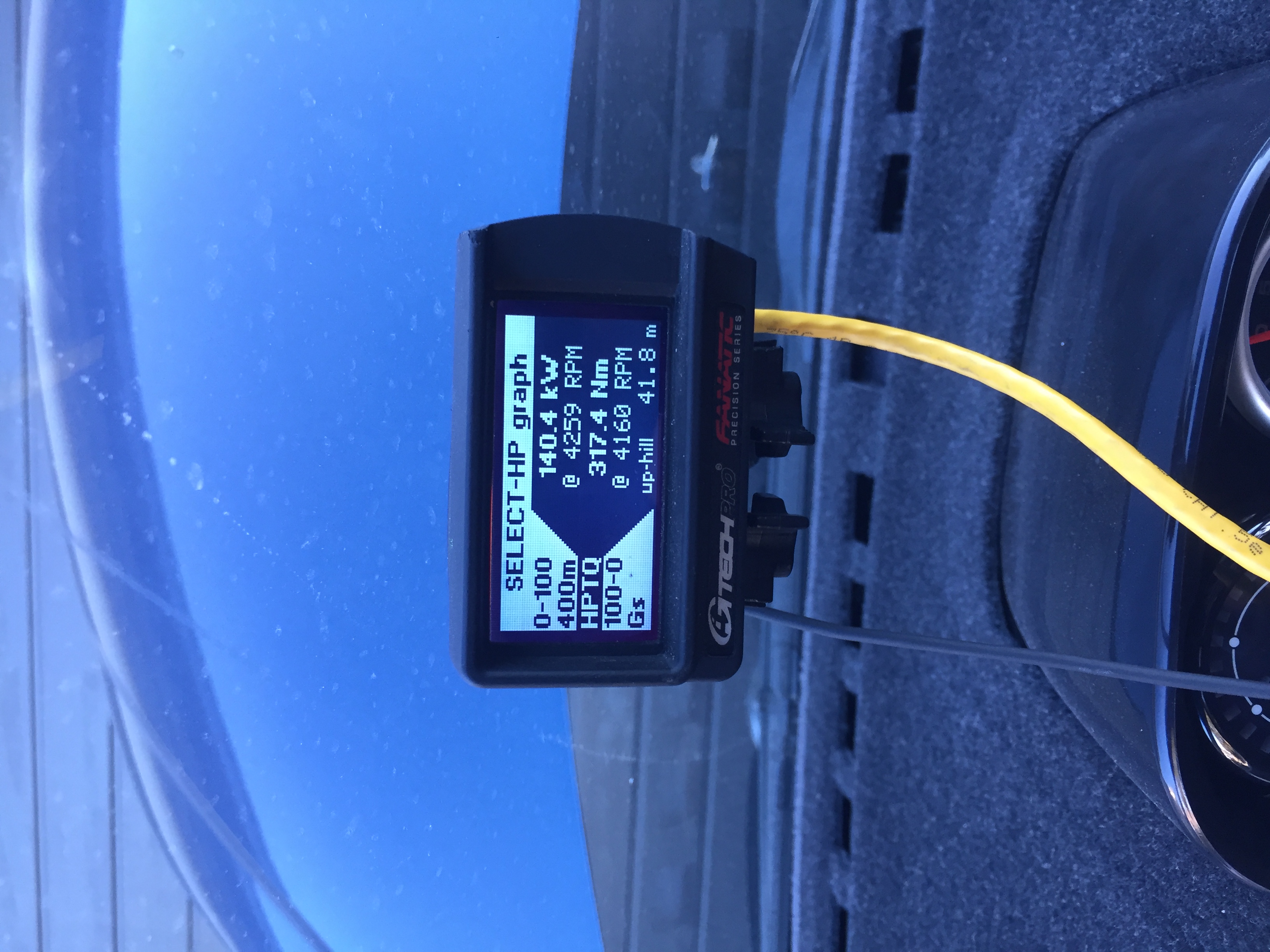

What’s everyone else getting out of there v6 turbo’s? Mine is 100% stock ecotec running 7psi, l67 injectors, walbro intank pump, l67 enhanced untuned yet. Even running the stock exhaust. Power seems down to me

I'm not surprised by those power numbers
Posts: 8549
Re: Vy v6 turbo
nor am I considering its got a walbro. Those pumps are 99% of the time are fake and fail quick or flow less than stock out of the box. Seen several engines die due to the walbros actually more accurately fakes sold as genuine.

So it seems about right for what it is?

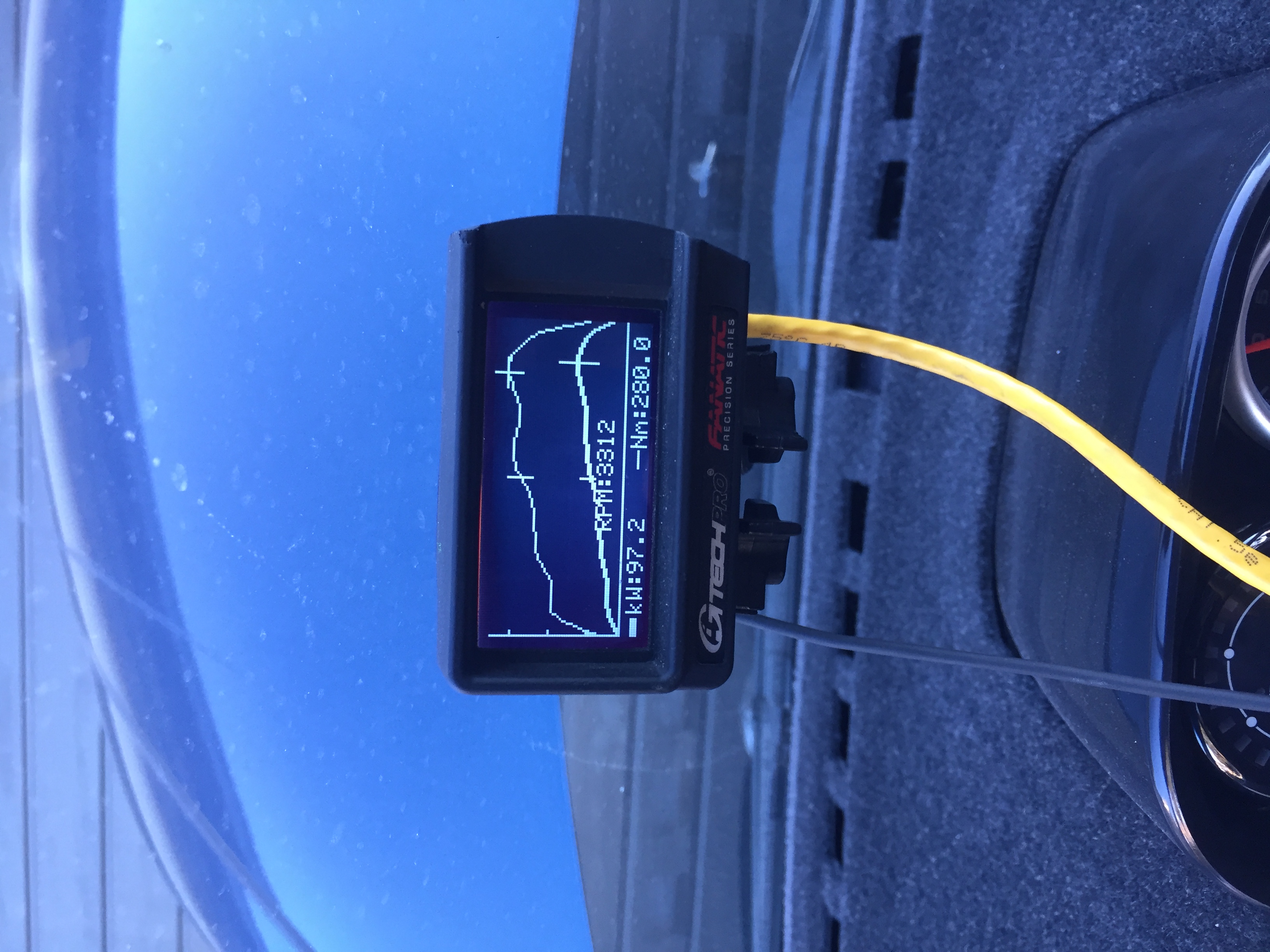

I’m thinking the gtech reads low. This is a run I did with the vy clubby. It’s got under 100k on the clock catback twin 2.5” exhaust, otr and mafless tune. Only putting out 170kw. That seems low as fuck for what it is
Posts: 8549
Re: Vy v6 turbo
yeah thing about the knock is I know a guy who blew up 4 ecotecs in a row, and there was no detectable knocks and it was N/A and pretty stock as well. Just was under powered and then randomly smashed the pistons on all the engines. Culprit was a "genuine" walbro.
