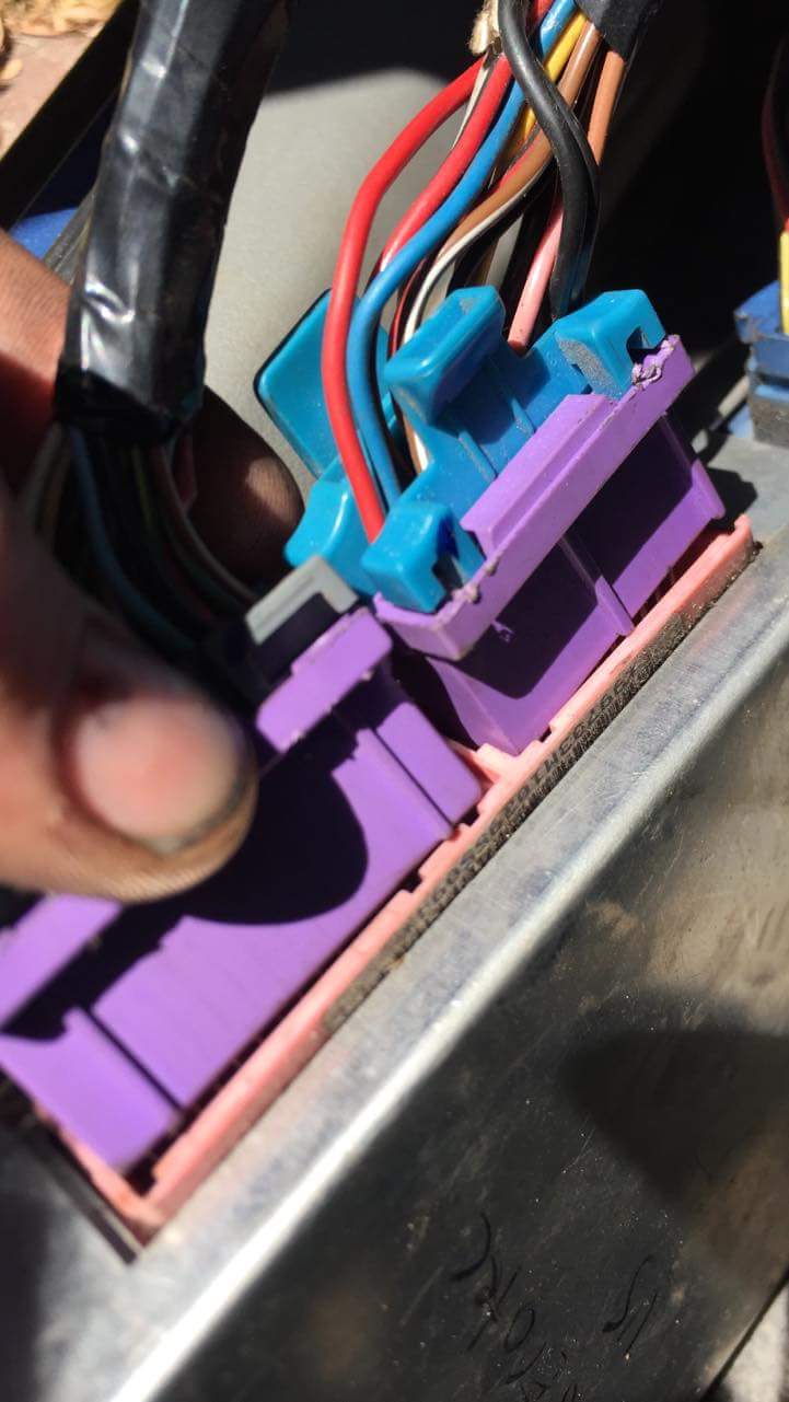

Got a fella who has a L67 he has put into a VR using what he believed to be a VS ECU & matching wiring harness.
The ECU is correct, but tne wiring harness has purple covers on the two plugs where they are normally pink in colour. The wiring pin outs appear to be in the correct order he said, although the alignment runners on the purple plugs are not. While trying to work it out another punter has said the harness is from a police spec model which had an ecu with metal connection points & not plastic like the standard variety. Said it had something to do with RF reception or interference.
Can anyone confirm this ?
Police spec VS V6 ECU & wiring harness ?

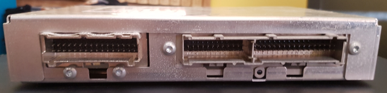

Not sure on the VS but the VRV8 RFI ECU has a different plug socket as in your pic and the ECU socket is alloy not plastic. Don't know what they were thinking when they made them.

Thanks for that info.Charlescrown wrote:Not sure on the VS but the VRV8 RFI ECU has a different plug socket as in your pic and the ECU socket is alloy not plastic. Don't know what they were thinking when they made them.

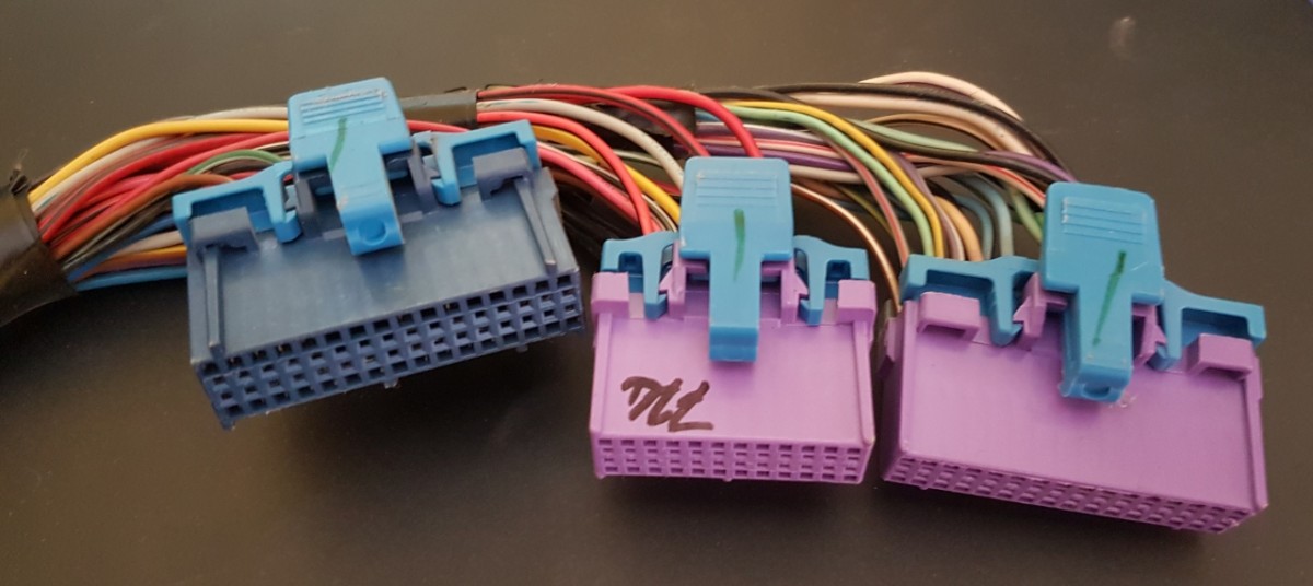

That is correct. the police radios transmit high power which can get in to the efi electronics. That is why grounded metal connector. Because its different, different keyway and colour connectors. But because its a phisical difference only, same pinouts.

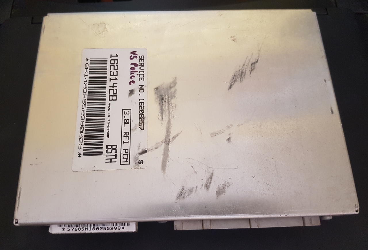

Heres some pics of one in my pcm collection. Service number 16208257 and "3.8L RFI PCM" where RFI is "Radio Frequency Interference"
You can chop the keyway pins off and plug a standard pcm in and it'll be fine.

Its weird considering the plugs and harness are not shielded, only the sockets are.
Proper design would have all metal plugs and sockets with foil/braid shielded harness with all interconnecting grounds. Seems like they got the ECU design done and then went "yeah nah, that'll do" "purple is a fruit!" on the harness.
