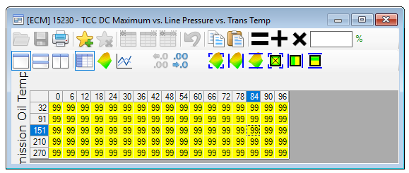

The TCC PWM output could probably be fooled into working as long as you're using a manual/non electronic trans and the boost control solenoid would have to accept the PWM frequency in use.
There are 2 tables for TCC duty cycle in an 0411/P59. TCC minimum DC % and TCC maximum DC %.
The tables reference commanded line pressure along one axis, and transmission fluid temp along the other. You could potentially fool the PCM trans fluid temperature up and down. and then use commanded line pressure as a way to limit boost up top. I'm sure theres many other ways you could do it. On an auto trans vehicle with a decent stall converter I will set the max duty to 99% and the minimum duty to 75% to prevent too much slip on lock. You can adjust the apply rate also.
