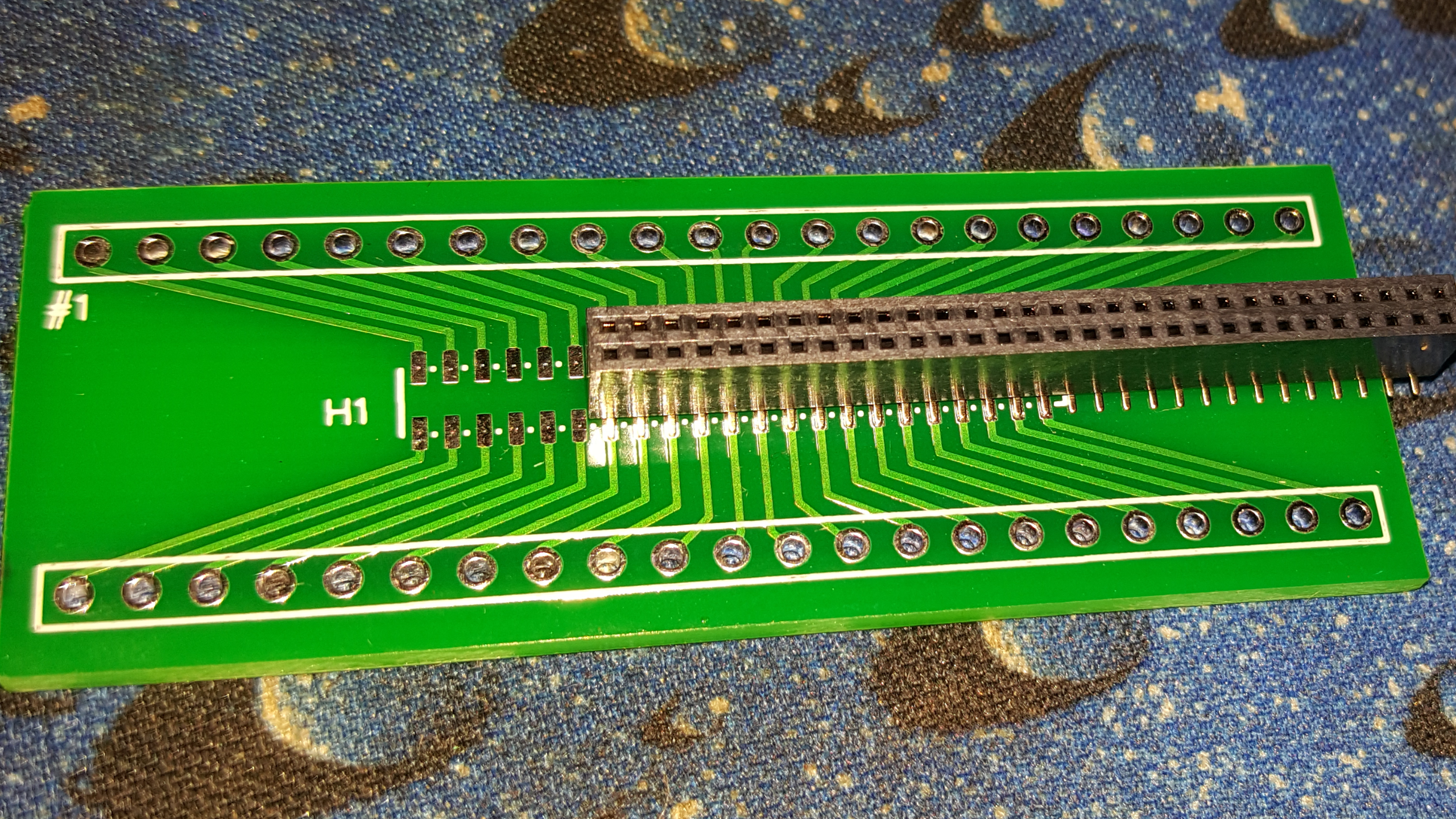

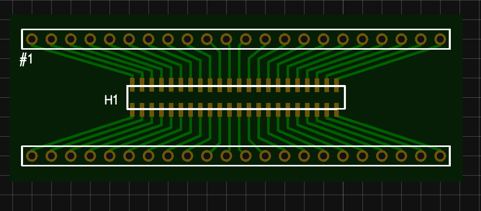

#2 The Adapter board - This is the real key to making this work. This board converts the 2.54mm pin spacing on the socket to the same pitch as the flash chip's 1.27mm spacing.
Adapter board.PNG (29.36 KiB) Viewed 4593 times
The files to have your own pcb's made
Gerber_TSOP 44 Adapter_20180424210101.zip
(17.8 KiB) Downloaded 343 times

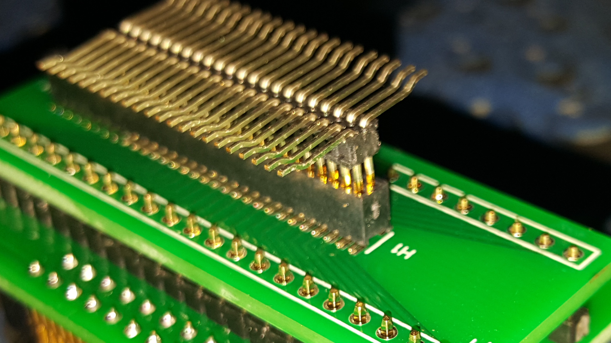

#3 The female header - any female header that's at least 2x22 with 1.27 spacing and L type pads will work. This is the type of header I used.
https://lcsc.com/product-detail/Female- ... 72530.html

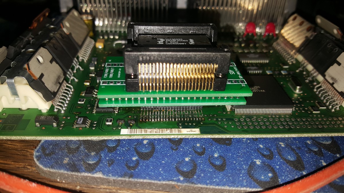

#4 The cheapest and easiest way to attach directly to the pcm is with a Road Runner header. They are a bit pricey but it's a whole lot less headache then other methods I've used to do this with.

The hardest part of all this was soldering the plastic female header to the adapter pcb. The header can be hard to get to sit flat and make good contact so I would advise soldering one and then pull it apart by force and see how well everything held up.
So pics of the parts and I test fit them and assembled everything.

nice project for flash testing without a bdm :thumbup:
