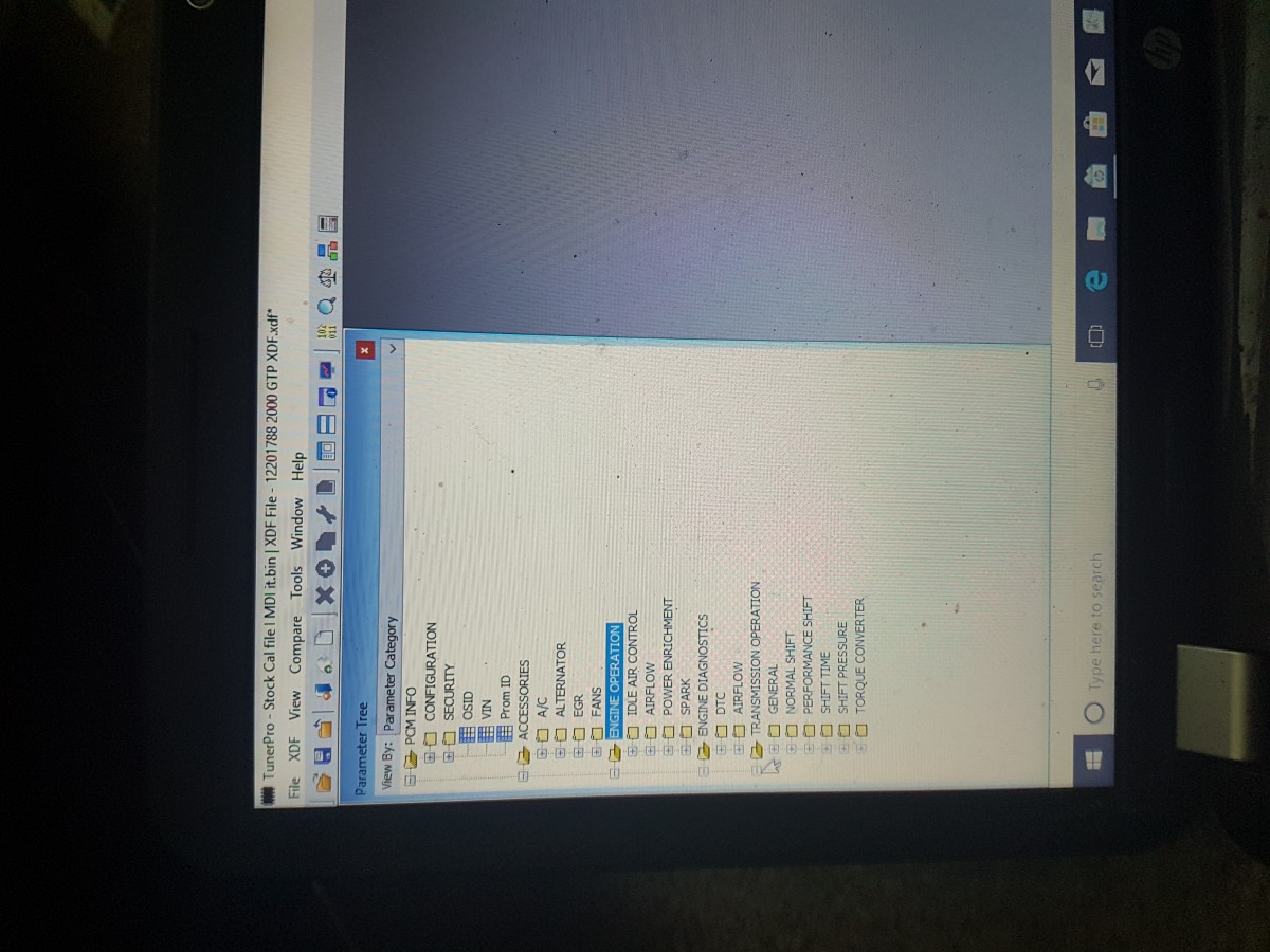

Thx antus downloaded the hxd and played with it a bit have to sit and figure it out yet see if I can been trying to figure the checksum or sums out got a bit of an idea but I'm lost lol but ill figure it out trying to open up the source code on tiny tuner but visual studios is freeking out lol so I have to try re download that see if I can go through the source code on Tiny but I figured id put this up here just a start by NO MEANS is this XDF usable but its what I put together in a few hours the other night little messy yet havnt totally figured out tuner pro yet first XDF. Thx again for points and any help Cheersantus wrote:Sure. There might be more than one sum too. Probably just 16bit sums, starting after the sum and running to the end of the segment. You should be able to use hxd to highlight and calc to test guesses more quickly, or just read the tiny tuner source.

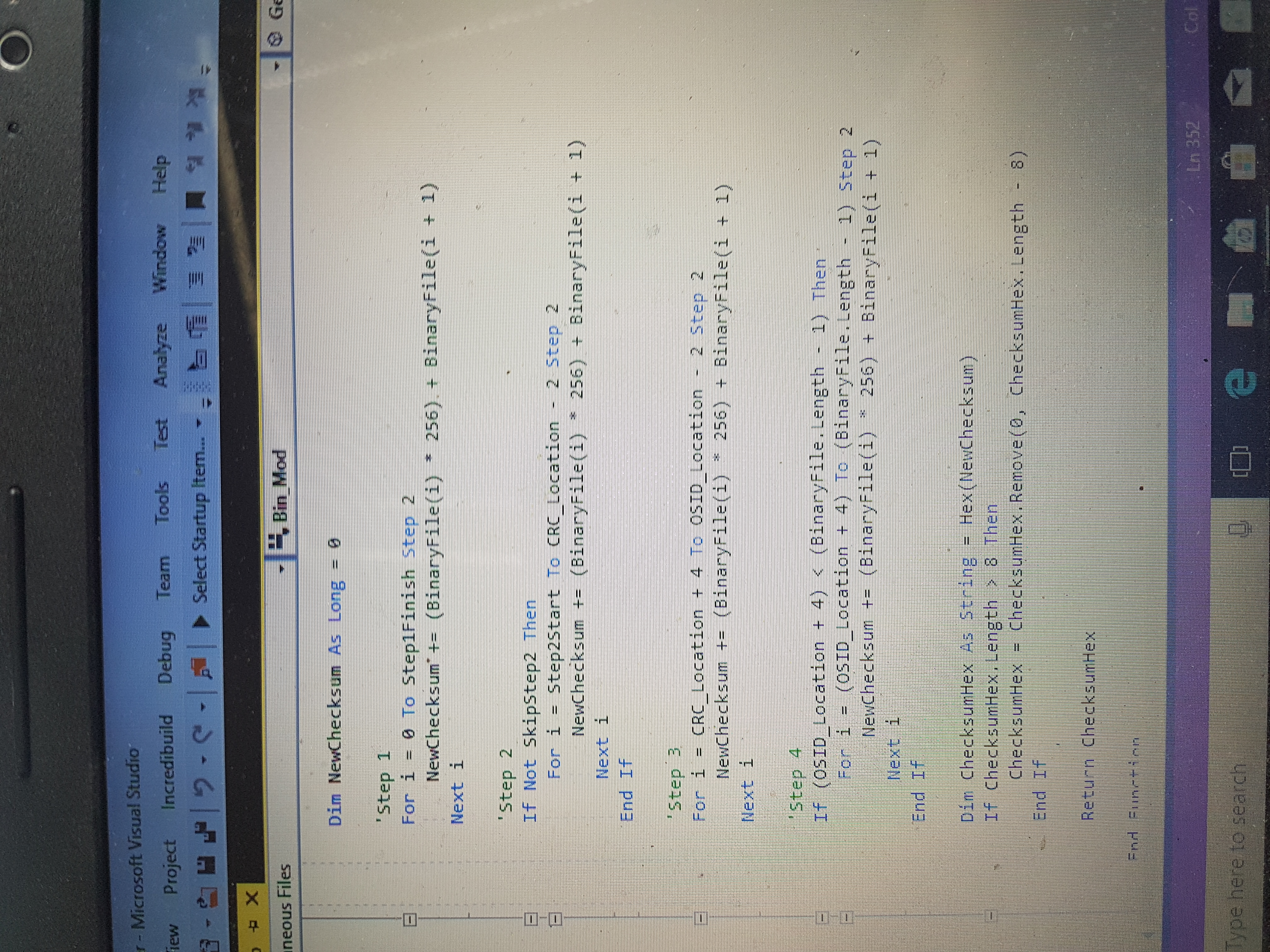

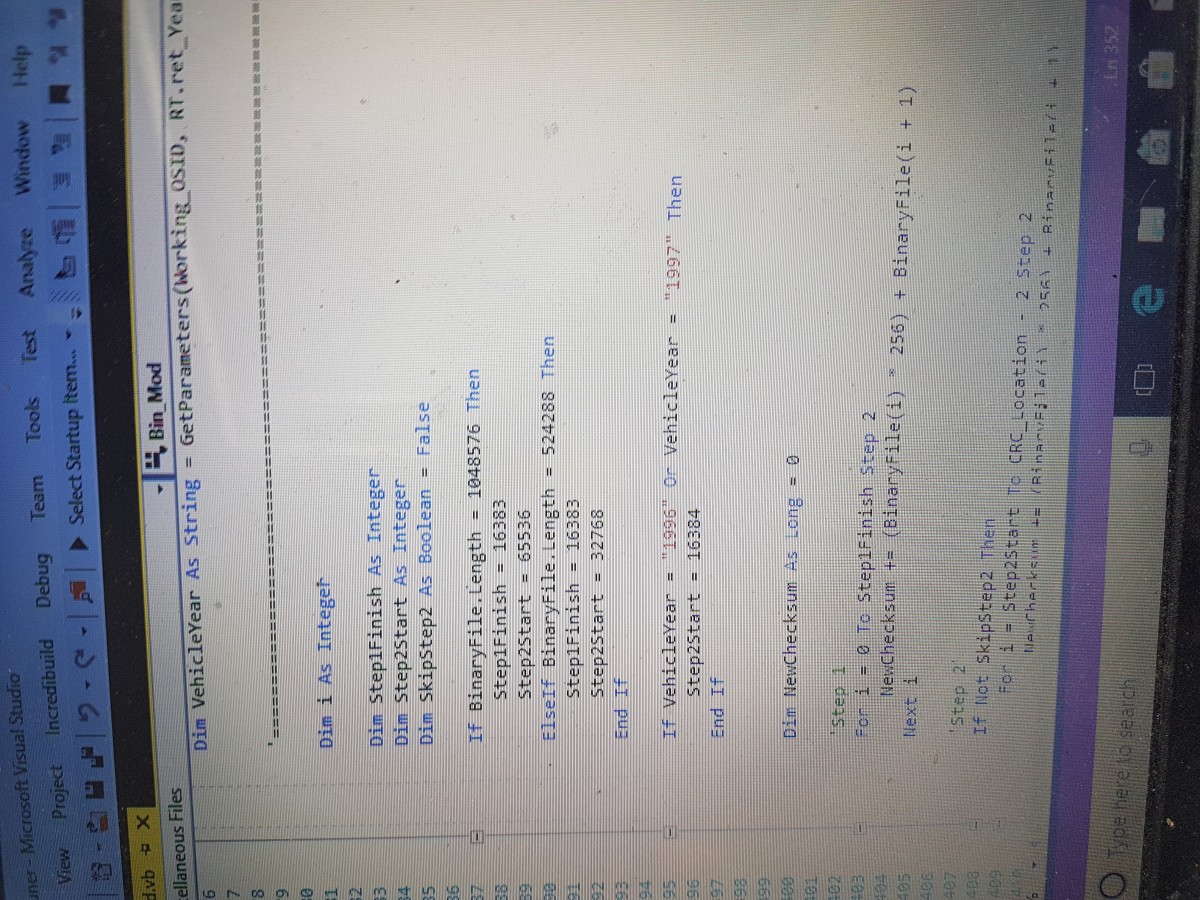

Ok so doing a bit more work on the XDF and I'm not sure if tuner pro can handle the checksum think a plugin would have to be made like the LS1 XDF I can post the source code for tiny tuner if someone is willing to make a plugin app I would but I havnt A clue as to do it still lots of learning hope someone can help out with it, found it in the source code and it looks like theres 4 steps to the checksum calculation but just what I'm gathering as I said not good at reading or writing code hope someone will help and heres an update for the XDF

Re: Checksum 2000 grand prix gtp
Sorted to parameter categorys
Checksum code
Checksum steps
