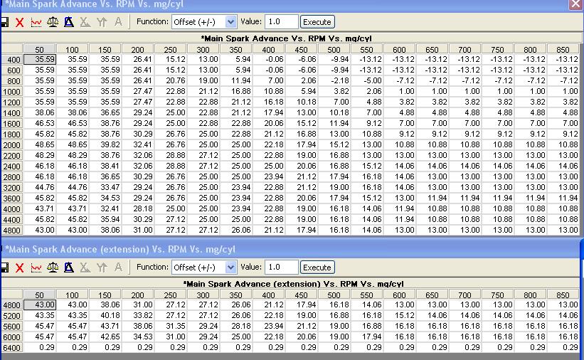

Info below is taken from a VT factory LPG bin and is the base spark map for Petrol and LPG.
It is MAF based but the MGC is similar to the MAP in terms of the table shape ie. a low mgc equates to a low MAP value and a high mgc to a high MAP.
Cruise mgc is around the 200-300mgc range, WOT throttle around 700mgc on a Ecotec V6 NA.
Obviously teh amount of psark you can run will be determined by the engine configuration, but the basics will be similar.
I'll let you worj through where the factory added and removed timing timing from.

looks like the timing has some major changes needed for lpg as well thanks yoda that sort of gives me an idea i might get more of an idea later when i play with my v6 sc with the afm at the moment i am still a long way from fully understanding .

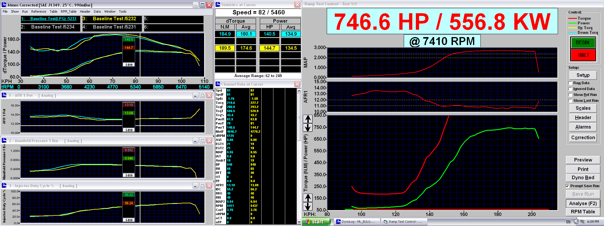

http://www.icomitalia.it/lang1/imp_jtg.html -this is the best-Attachments
if you are interested I can share my experience with LPG settings

Not everyone here has rar, so I've converted your pic to png so its easyer to see. Impressive stats!
- Subaru LPG.png (148.44 KiB) Viewed 7223 times

If only my commodore had that sort of power
