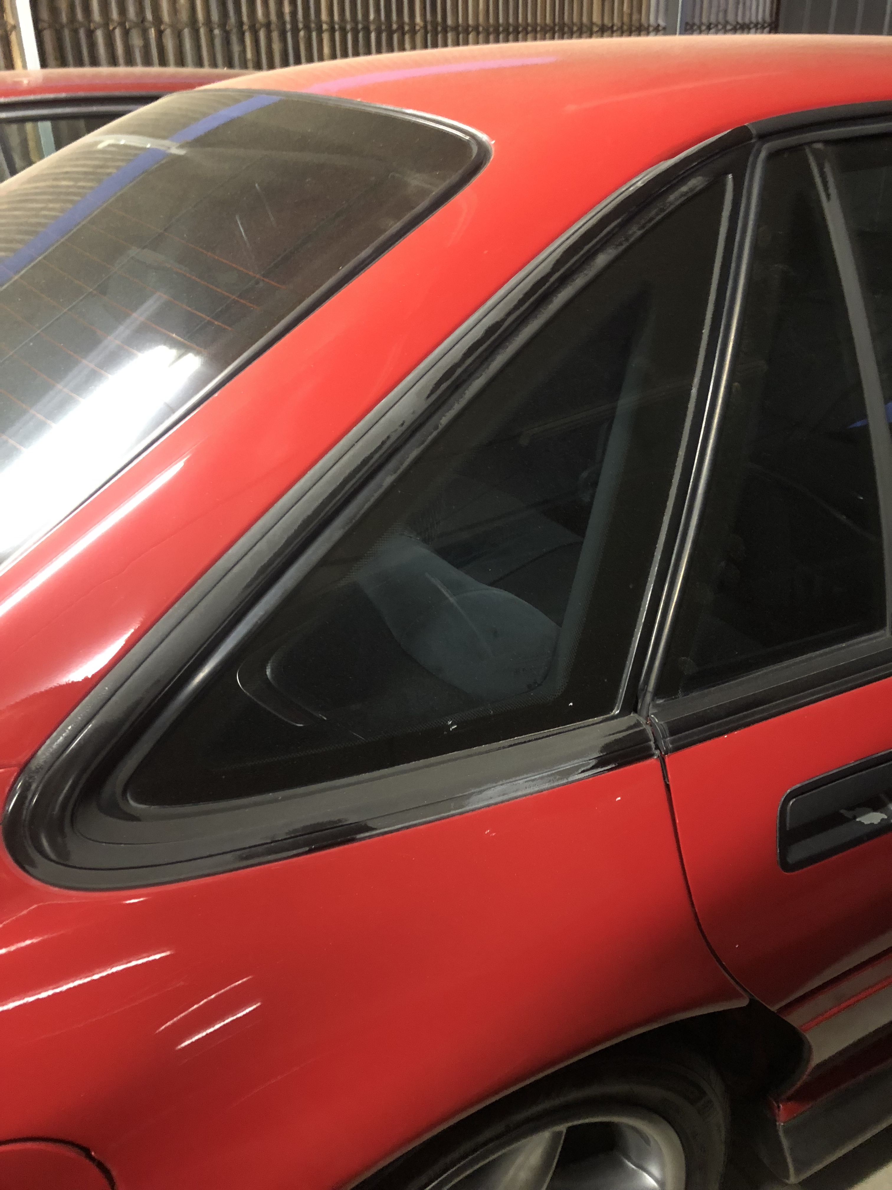

Looking for ideas/opinions on what to do about this -
That is on my VR clubsport, the car is looking pretty good now with exception of these, I have been hunting NOS or good second hand and have had zero luck.
It is a rubber surround that seems to be molded smooth on the outside, clearly UV has broken down the surface. I’m sure painting them is possible but does anyone have any experience with these?

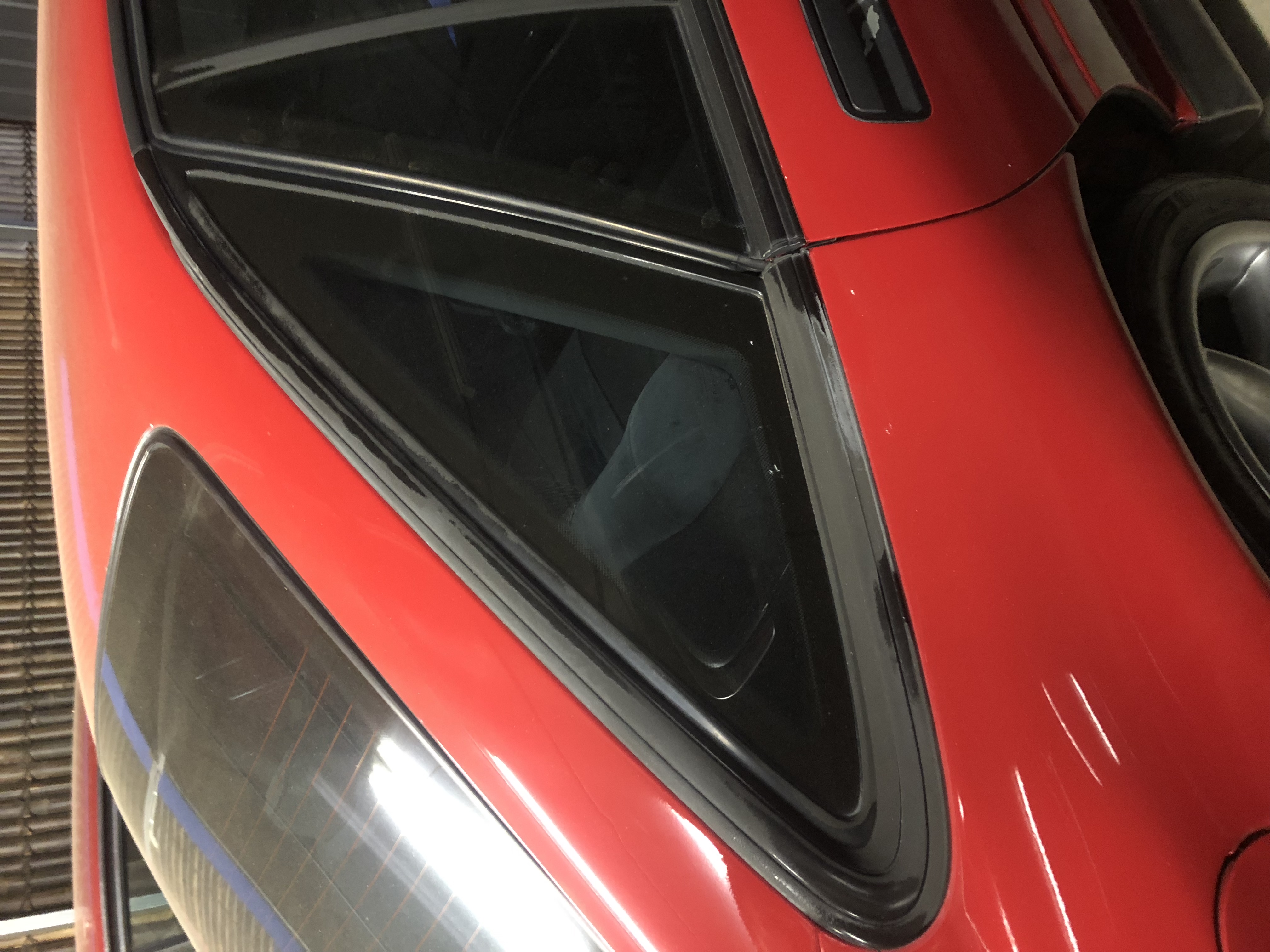

Why is it when I upload a photo from my phone that it uploads the right way around if you click on the attached file but on the page it’s sideways?...

As for the windows, you can get reasonable results with a gloss vinyl paint but requires masking the glass to protect from sandpaper and several hours of sanding to remove the roughness and cracks. Bad ones take days of sanding. Rubber is very hard to sand.

I'm happy to sand and paint them but am looking for more direction on the process and products to use. I'm not keen on putting the effort in if there're going to not last or look good. I guess I'm really looking to hear from someone who has actually done this or a similar job on rubber before.

I've done a couple before. The biggest issue it the cracks in the rubber, sanding might look to have removed them but they still show up after painting but if they aren't bad to begin with then they come up almost like new. Yours are too far gone looking at the photo.
I have tried about 20 different paint products over the years, none work except vinyl dye and it is almost like the factory coating. Only issue is the gloss dye is less forgiving to flex under 10-15c but won't be an issue on windows like that, it's more that it can crack if you bend the rubber over a fair bit like you can on the door quarters as they are exposed to that, body quarters are completely fixed so it won't be an issue.
Also 2-3 coats won't have an issue, it's more that if you go over 5-7 coats it can crack easier but it kind of needs a lot of coats as it has no filler and doesn't built well which is what you need for bad rubber to try fill the cracking. If the rubber is pretty decent then sanding and 2-3 coats it will look like NOS and flexible like is too. The biggest challenge is to find good used ones where the peeling is only minor and caught in time to restore it, otherwise you can forget it, results will be sub par.

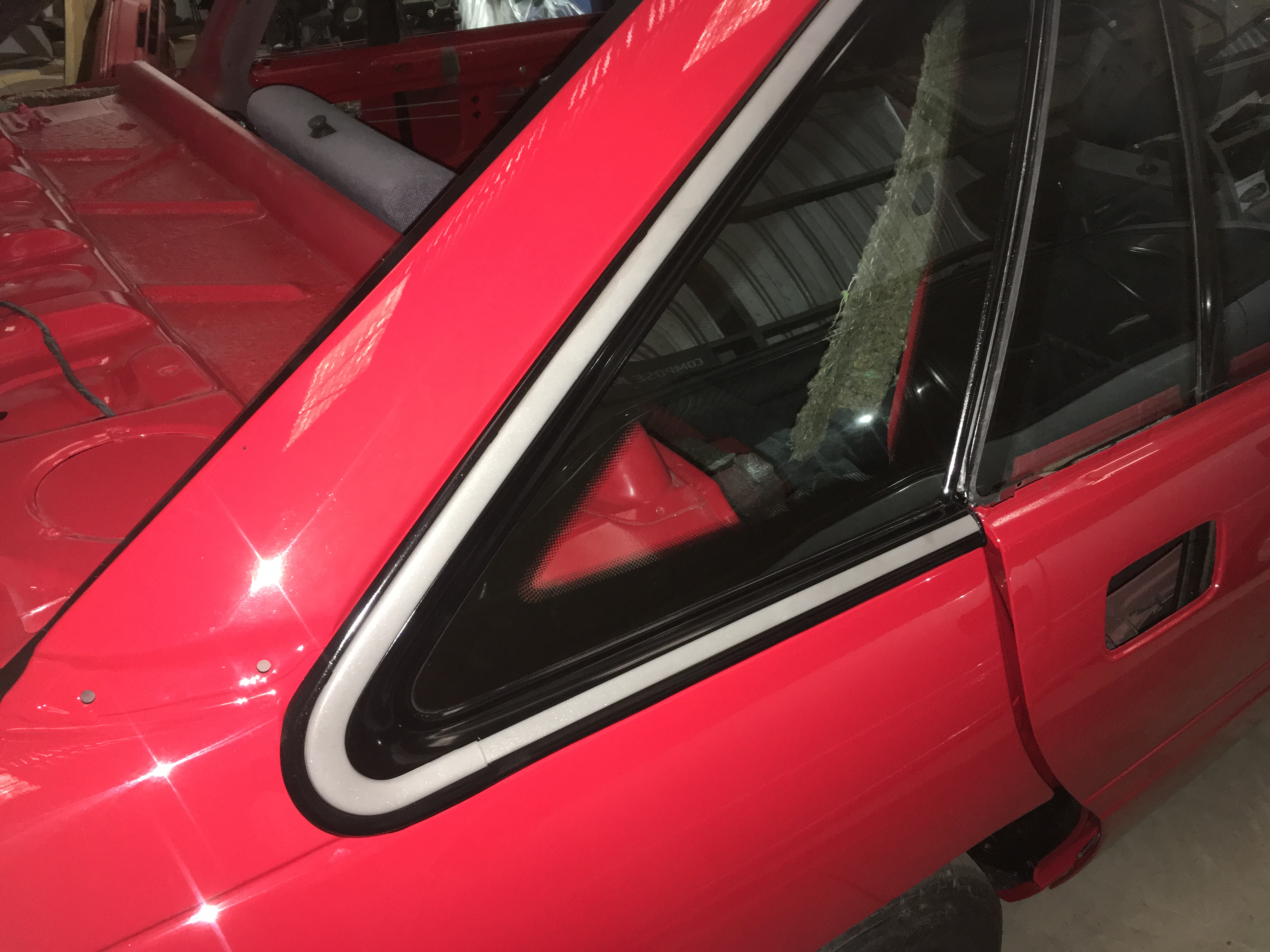

Example of the best result I've got. Was pretty much in vane anyway as I found enough NOS ones for 2 cars and swapped it out shortly after.

I've tried as suggested with the photo and no luck, even if i offset the rotation to trick it, it still loads to the forum on it's side, FFS....
