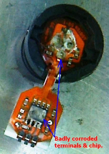

I also opened up an oil pressure switch he had to change on the LS VY a while back, was making the gauge go haywire.
Turns out that whenever it got a wash, the water and whatever else ended up inside the switch, sealed the new one with silastic around where the edge was rolled over to hold it together, in hope of keeping it dry when washed.
Pics a bit out of focus.

Yeah ls1 + water pain in the ass..... owned it for years finally washed the engine for the first time, dead oil switch dead knock sensors. replace oil switch, disable knock sensors (yes im lazy and they are under the intake manifold in the valley) never washed it again lol it can stay bloody dirty.
- Posts: 3823
- cars: VS,VT,VX,VE
Re: Investigating "the why's" of diagnosed problems
I don't think it's just an LS problem but more a GM problem....
