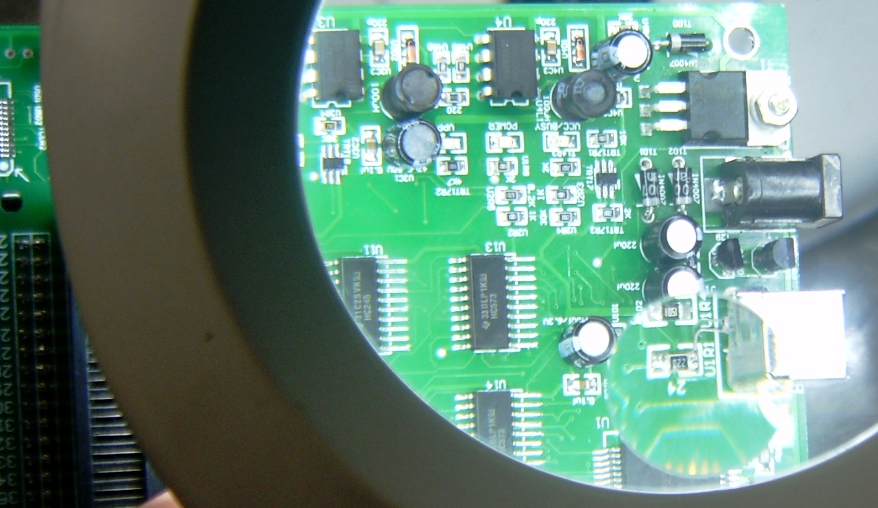

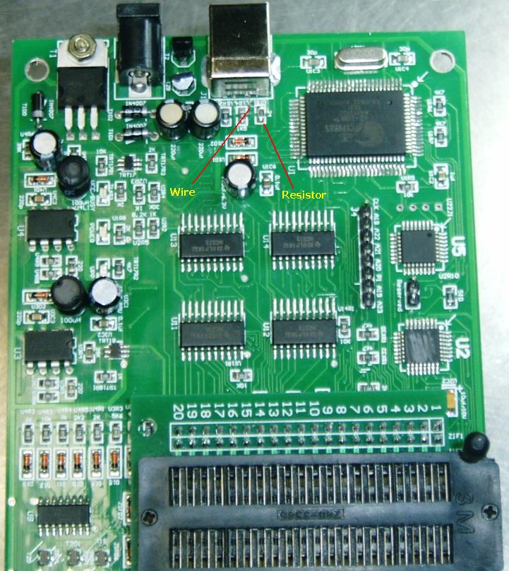

Though this one didn't kill the GQ4x that was given to me a couple of months ago..
It was a dead unit, seems to have burnt a track between one of the USB connectors on top of the board and the SMD 24R0 resistor after it..
Unfortunately Jaycar didn't have any 24 ohm SMDs in stock, but did have a 220 / 22 ohm, I figured why not, the units dead anyway, I'll chase a 24 ohm up later if I manage to fix it, which to my surprise I did, was pretty happy with that effort..
using the .3mm tip (.011") it soldered the chip onto the board looking like factory, I also piggy backed a .012" wire off of one side and soldered it to the USB pin where the original connected to..
Pics are a bit fuzzy, I need to invest in a camera, one day...

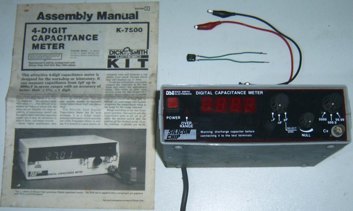

Here's my old nugget, took a week of nights to assemble from scratch, half of which was because nothing fitted into the case even remotely close.The1 wrote:I still have my old Bob Parker ESR Cap tester, but recently picked up one of these, handy for quick testing alot of other components to like transistors and mosfets.
I remember thinking half way through the task, I should've paid the top dollar for the built one and made money doing work in the time it took me to assemble it, would've been cheaper in the end..
How cheaps that, I'm sure the sum I paid for my old cap testing kit that I had to assemble was probably 10 times+ that amount, and doesn't do much more than caps..

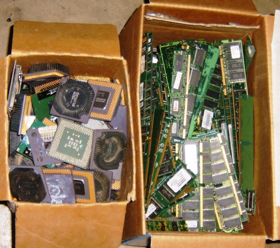

Last time I spoke to my brother on the phone, he reckons he's going to try gold recovery from some ram ans cpu's, I said excellent, I'll drop you a sample to experiment with til you get a system worked.
Dug these out for him to try, just old P1's mostly 80502's, some nuggety duron's and celerons.
The rams just the 32 / 64mb sticks for now, and some fast page edo, nothing of worth to me.
I filled a 10 liter box with ram, 5 liter of cpu's..

Dude you should be selling those CPUs. They are worth a good amount these days as they are all collectable by retro/vintage PC guys. Gold recovery from those are a negative endeavor, there might be only $40 worth total from the CPUs and RAM. Sell the CPUs, many of those are worth from $5-30 each depending on rarity/popularity. RAM is stuff all but even $10 for a set should sell.
here see what I mean. Durons for example were very well regarded back then and now among collectors. Better than the 10c worth of gold and few $ of wasted chemicals.
https://www.ebay.com.au/sch/i.html?_fro ... 0&_sacat=0
Pentium overdrive which looks to be half your box. Even better!
https://www.ebay.com.au/itm/Intel-SL2RM ... ctupt=true
All my stuff is post 00. mainly Althon 64 and Opteron server CPUs. Heaps of ECC DDR ram. I got some late 00 stuff too.
