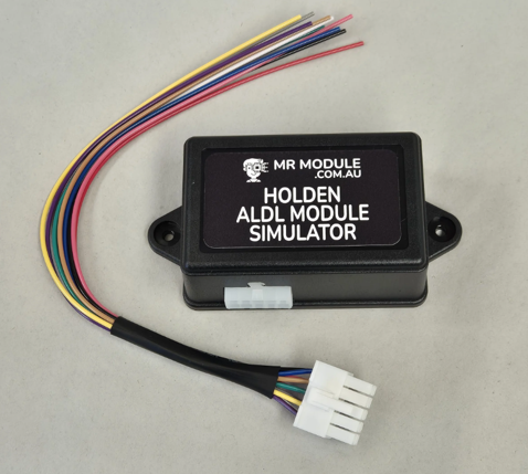

This is an ALDL data simulator for VR-VY.
I originally came up with this after experimenting with ALDL on an Arduino. It was initially a BCM simulator only, but has since been revised and can do many other things. It also now uses a connector instead of permanently connected wires.
Big thanks to this forum for a bucket load of information and VL400 who answered quite a few questions I had. Also thanks to countless others who have suggested improvements and help find and fix bugs.
Features are:
- VR-VY VATS simulation, including automatically linking to PCM if required.
- Option to disable VATS with a manual kill switch so engine will not start.
- VS-VY low speed cooling fan relay control output.
- VT-VY oil pressure and engine malfunction warning lamp outputs.
- VT-VY A/C request input (retain the standard pressure transducer and have the PCM control the A/C compressor).
- Allows the use of VT-VY dash cluster (coolant temperature, warning light and fuel consumption data transmission from PCM to cluster).
- ABS/TC and SRS data simulation to prevent dash cluster warning lights.
- VT-VY Traction Control Torque Request PWM signal output, to connect to the PCM, to prevent a "requested torque out of range" DTC.
- VT-VY Low vehicle speed output (< 5km/h), that can be used to trigger anything when the vehicle is stationary (eg. a reverse lockout solenoid).
- PCM data simulation, for when the PCM is replaced with an aftermarket one, to prevent the instrument cluster warnings.
- Support for BCM 'Disable Chatter' commands, so it can be silenced like a real BCM.
It comes in a case 85x55x35mm with 2 mounting tabs.
It comes pre-configured as a BCM simulator that will work with any Delco PCM from VR to VY. If you need to change configuration its done by opening the case and changing dipswitches on the PCB (see the installation instructions).
Printed installation instructions are included, and also attached here as a PDF.

It runs an Atmega328 (same microprocessor as an arduinp uno) on a dedicated PCB I had made for the purpose.
The development was initially done on an arduino and then on an atmega328 on a breadboard/bench setup I made.
The code itself was written in the Arduino IDE

Also had a question about how the VATS linking works:
At Ignition on it waits a short time for a VR or VS PCM to send it's VATS message. If none is received, it sends a VT-VY message 40 (PCM data request). If there's no response, it goes back to waiting for a VR/VS PCM for a short time. If a VT-VY PCM is connected, it will respond.
If it's the first use, the PCM won't be linked to the BCM simulator. The BCM simulator will see this in the message 41/pcm response data. The BCM simulator will then unlock the PCM and link to it automatically. Once linked it will resend a message 40 and should get a message 41 response with VATS OK, if not it will retry the link. This whole process takes less than a second and only happens at first use, after that VATS will pass instantly. It will redo it every time it finds the link is broken (a different PCM was fitted), so it isn't "locked" to only 1 PCM ever and can be reused indefinitely.
Once the BCM simulator sees VATS is OK it will start the BCM data simulations (heartbeat, all module requests, etc).
It only simulates VT-VY BCM data if connected to a VT-VY PCM. If it finds a VR/VS PCM it will stay quiet (only do VS low speed fan).
