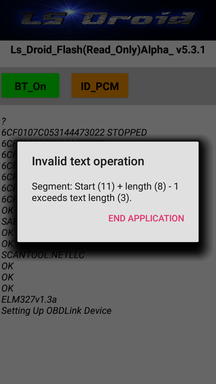

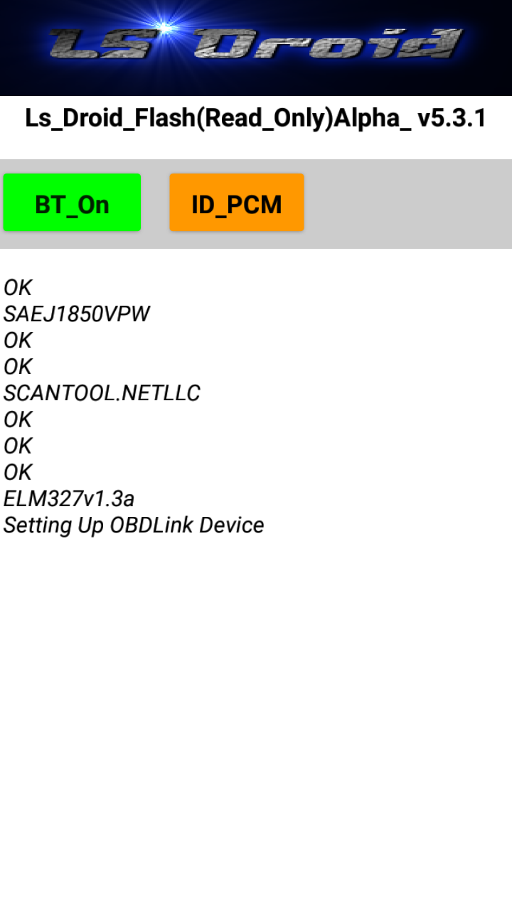

The following tests were conducted on a P01 512k PCM service# 09354896, with operating system 9381344. A Samsung J3 (s327vl) Android v6.0.1, OBDLink MX bluetooth and bench harness were utilized.
LS Droid Flash v2.1.6 VIN/Serial change
-BT_ON: ok
-Id_Pcm: ok, vin/serial/osid all correct. Seed 3B98 Key FB12
-VIN# Change: ok, functional after all power removed.
-Serial# Change: Repeatedly failed. "Wrong Length" warning appears momentarily, despite correct 12 digit entry. Same results, after checking Alt Serial Write box "Wrong Length."
LS Droid Alpha v5.3.1 (Read Only)
-BT_ON: ok
-ID_PCM: Repeatedly failed. Warning box appears on screen, blinking sporadically "Invalid text operation Segment: Start (11) + length (8) -1 exceeds text length (3). END APPLICATION." Phone gets buggy, app stops, phone will then go to restart screen for several seconds.

Speedy wrote:The following tests were conducted on a P01 512k PCM service# 09354896, with operating system 9381344. A Samsung J3 (s327vl) Android v6.0.1, OBDLink MX bluetooth and bench harness were utilized.
-BT_ON: ok
-BT_ON: ok

Sounds like you need to update your OBDLinks firmware..... or that you have an issue with the pcm on your bench. The reason I suspect a PCM issue is that the Allpro use's Elm commands. Ls Droid Read has ZERO Elm commands used for sending or reading data in the app. The app is built around the ST command set(not to be confused with the Elm AT command set).
In your screen shot the word STOPPED appears. This will only occur when the Obdlink tries to send data while the PCM is still sending data to the OBDLink. SO that means the port on the Obdlink didn't close or that the PCM likely isn't sending a proper end of frame message so the Obdlink knows to close the port.
It's also possible your bench harness isn't as "good" as you think it is. I just had someone using the write app run into issues that they ended up tracing back to poor connections in the bench harness they were using.
As for Ls Droid flash 2.1.6 I have never had anyone run into an issue with the length of the number they entered. I would suggest counting from 1 to 12 in HEX for a "test" serial number to write and then adding or subtracting a digit on the end if it still gives you an error.
