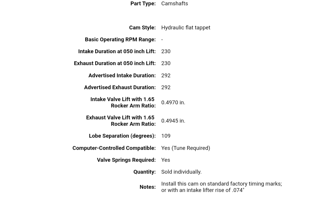

Ive got a holden 304 with a 4761 cam installed but it's running std tune and running really rough and fouling the plugs I've got all the tuning gear to burn a new memcal ect just winding if anyone can help me with the changes I need to make to get it running okay to be able to take it to the dyno in a few weeks I'd really appreciate if anyone could help

His the current bin file the car is running on and cam specs below if anyone can help me I'd really appreciate itHolden202T wrote:get the bin file from the car with the flash tool, zip it up and upload it here, then someone might be able to go from there for you.

Is the engine standard apart from the cam? Or modified? Compression, heads? etc..
That's a fair sized cam for a 304, tight seperation angle too.

The engine has shaved heads , 040 oversized pistons , little head work it drives okay and has lots of power just does idle great and is fouling the plugs really bad atmoss96 wrote:Is the engine standard apart from the cam? Or modified? Compression, heads? etc..
