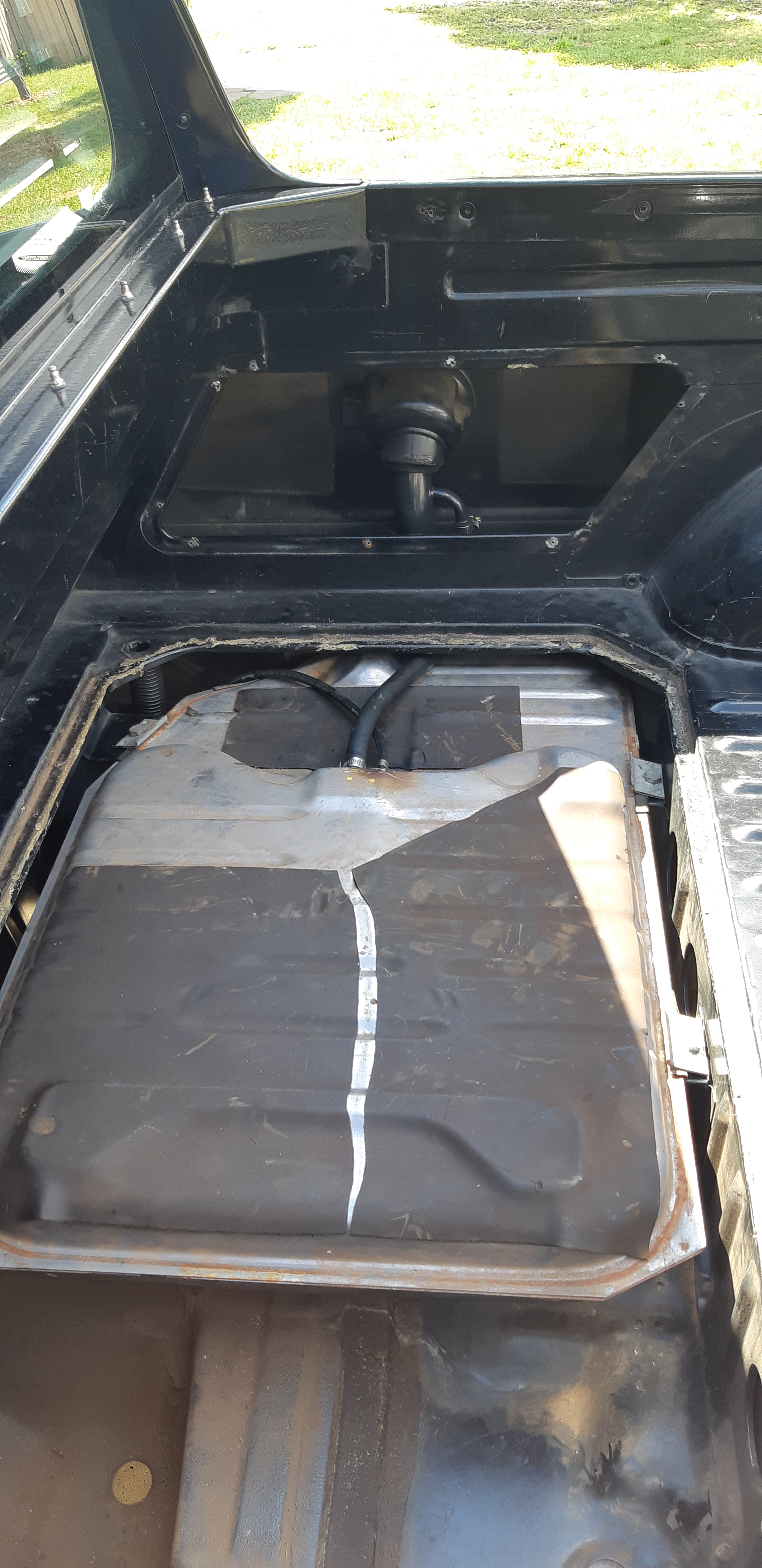

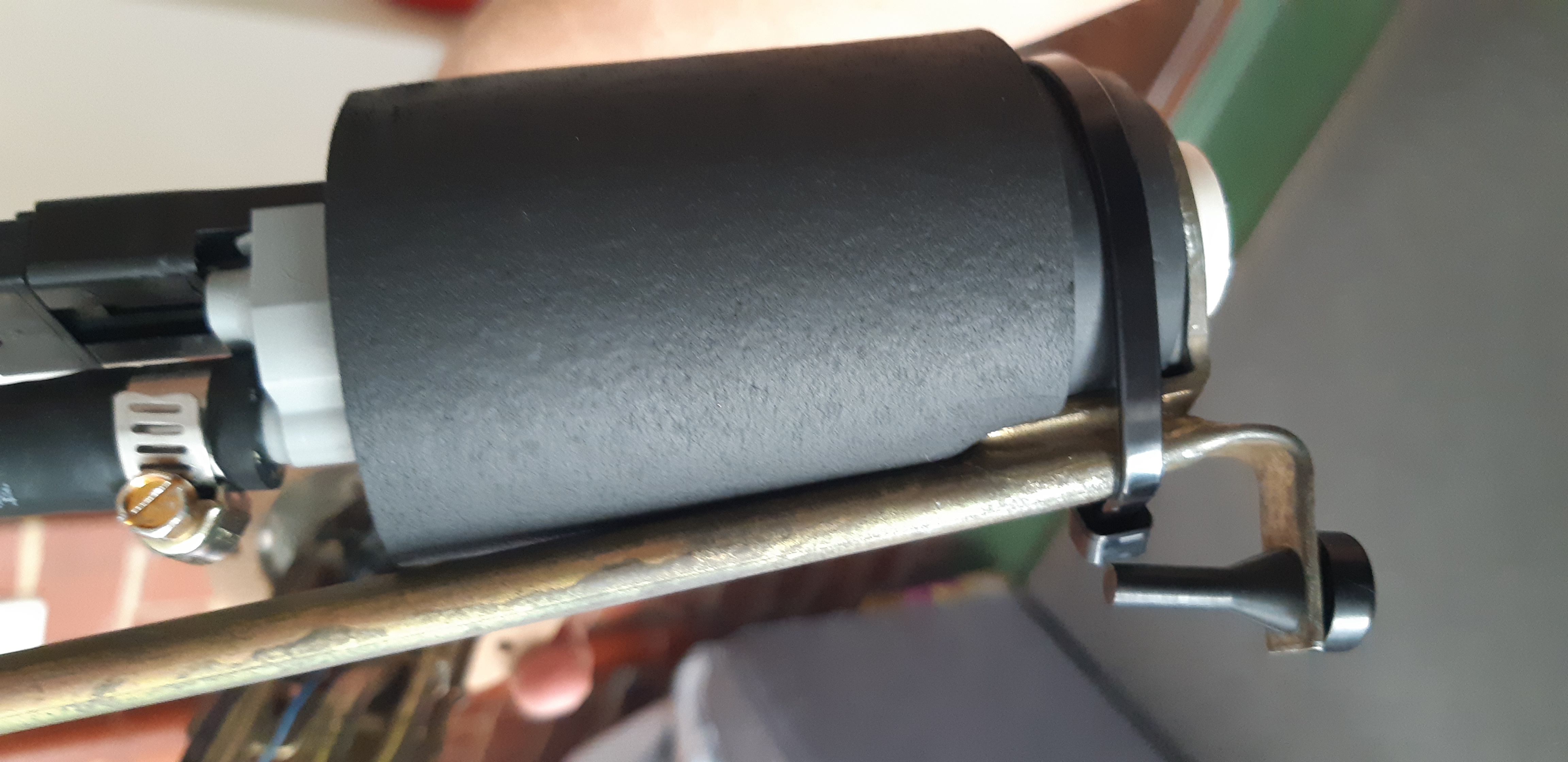

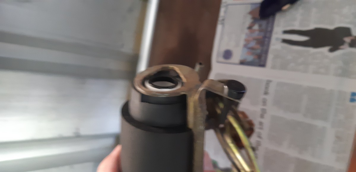

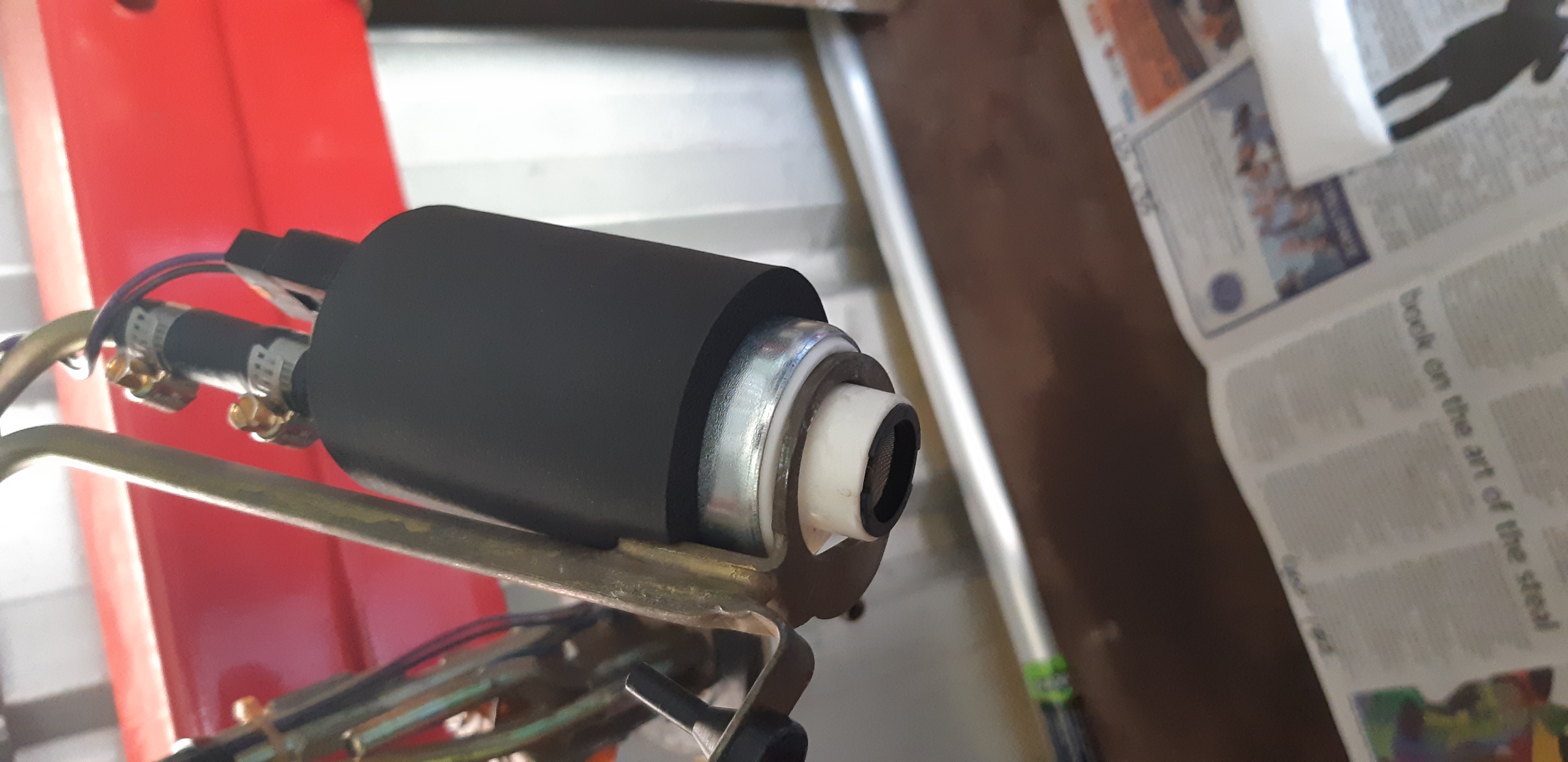

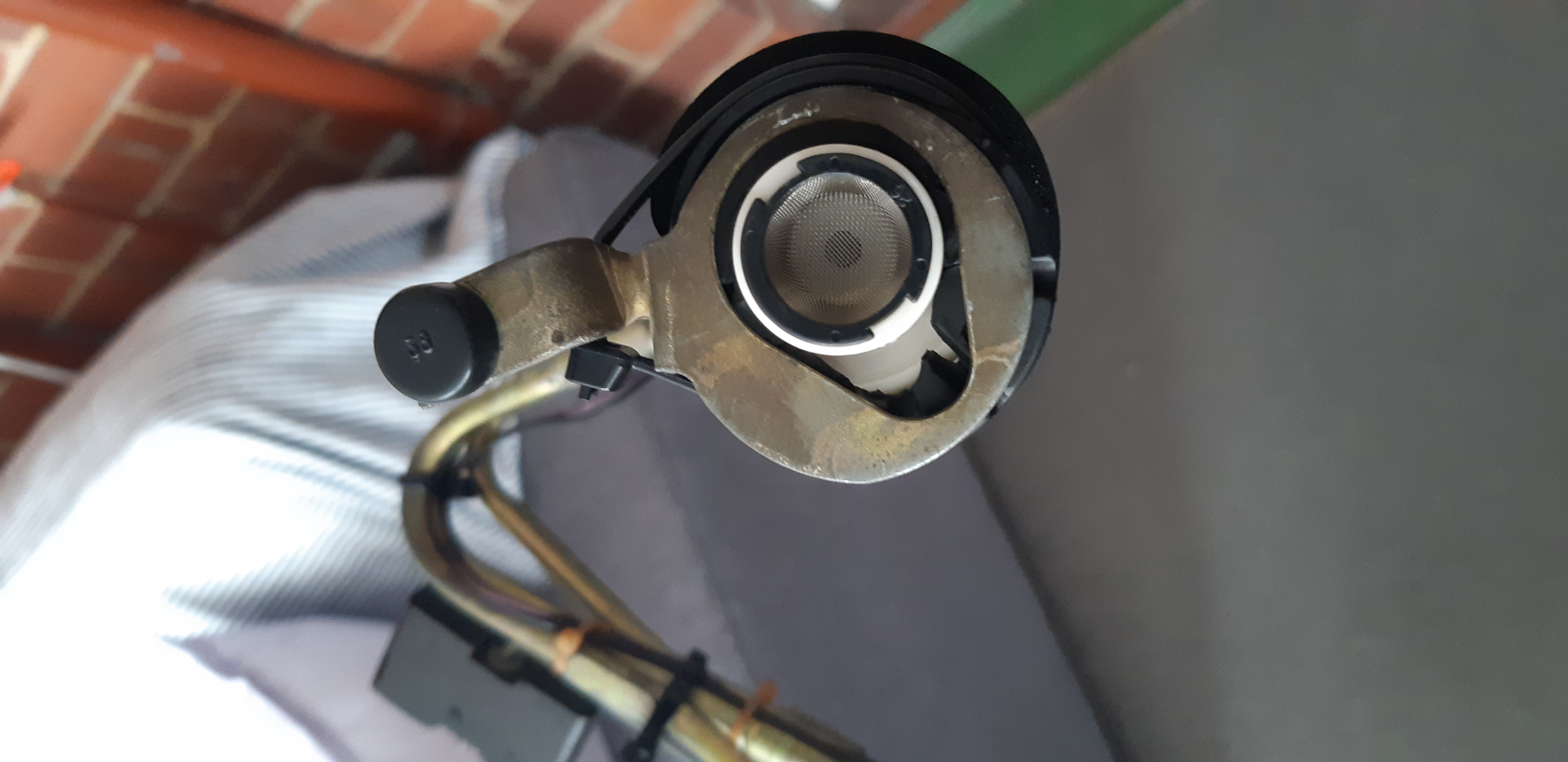

Yeah I knew that but TI Automotive sales and dispatch team don't seem to synchronise well, the receipt I got mentions that but what they packed and sent is different. Anyway after getting a full refund and they told me to just keep the pump, I did a little mucking around and managed to secure it to the hangar. I have attached pics. I cut the walbro bottom rubber mount bottom bit completely off and used it as a sleeve at the bottom lower part of the pump. I used my old factory pump lower mounting rubber and cut out all the high spots with a stanley blade on both sides. Then I used a cable tie to centre the inlet part to the bottom of the hangar. The filter slid on nice and easily. The filter is a 22mm version on the GSS340 model which is larger than the other GSS series. The pump is firmly secured and the inlet area should not rub against anything. It's fitted to the tank, tank is in the ute. Just got to get a new elbow hose that joins the filler neck to the tank as the original is dried and has cracks. My local hydraulic hose shop has it in stock, the gates 90 bend elbow filler neck hose and they can cut it down to my required length.

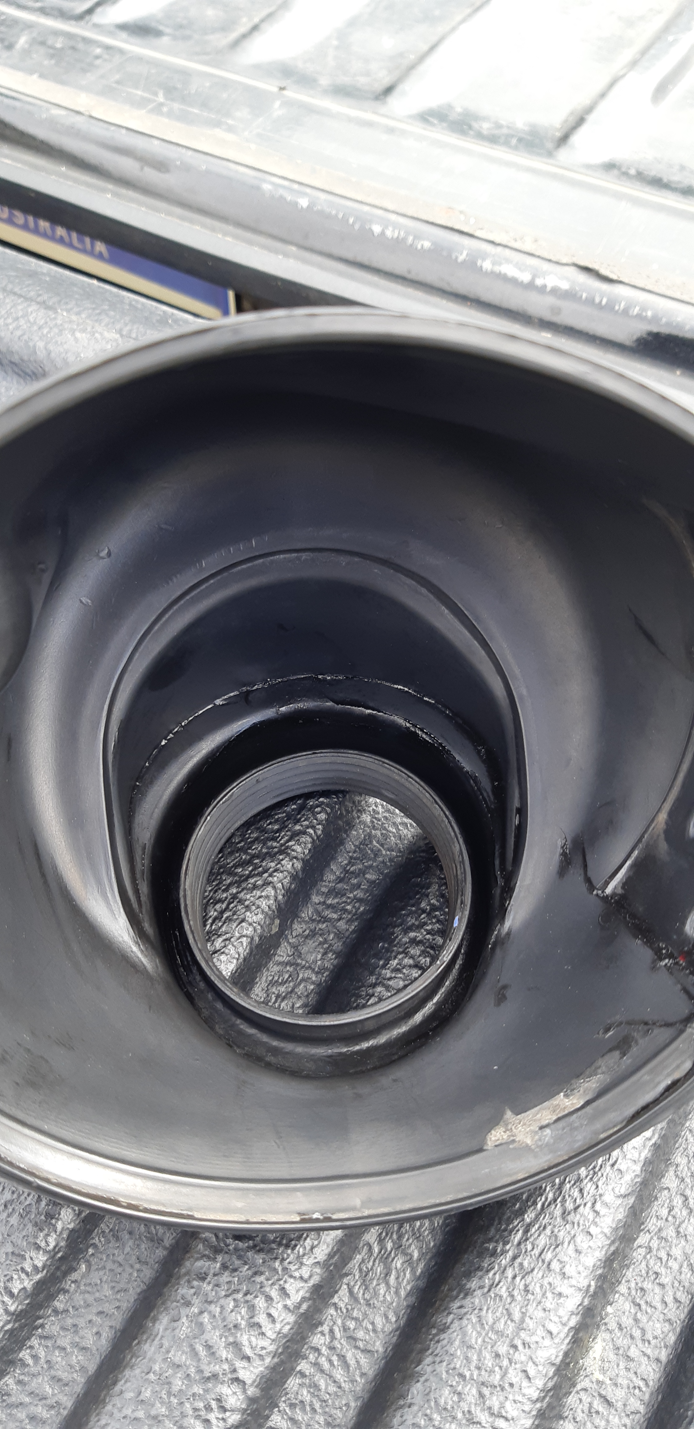

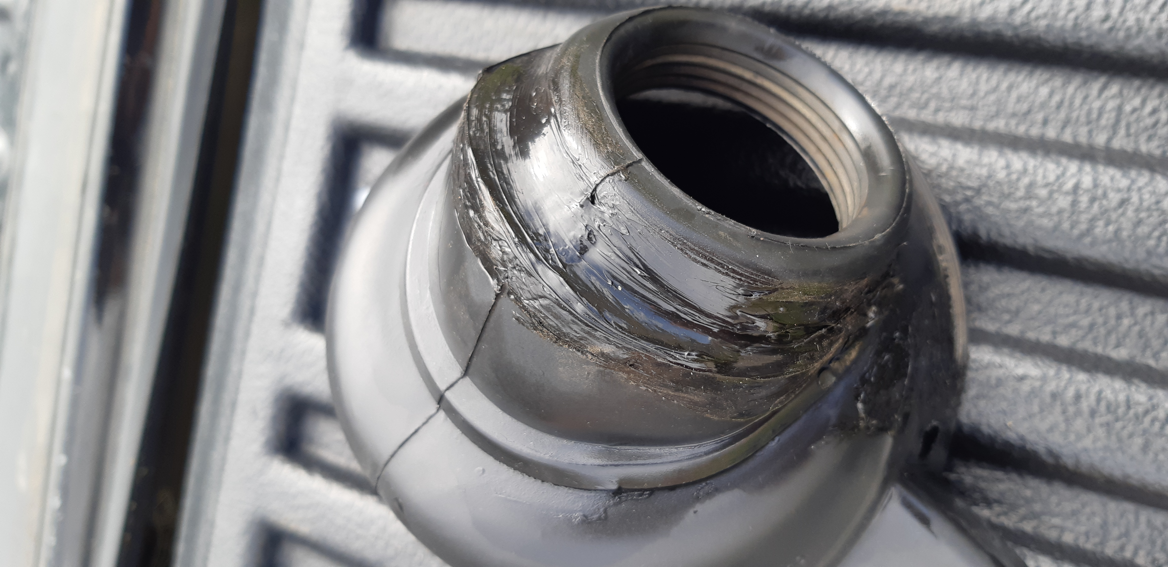

Any one got a VS ute? The filler neck seal (the black rubber that sits inside the petrol cap housing) is impossible to find. Use loctite 406 to glue as much as you can of the split rubber together then use windscreen sealant behind it (not on the petrol cap side as it does collect dust) and it works well, holds it really firm. The reason I did it is to stop water when washing the ute or on rainy days from seaping inside that was the cause of my rust bubbling up on the lower rocker panel. I have a plastic tub liner so water was not getting inside from there.
Also replace the the aged clear and the big plastic breather hoses with fuel line and clamp it to stop the fuel fumes on very hot days. The large 16mm hose I got from Veale auto parts is made by Raceworks and it bends very well without any kinks. Veale Auto Parts are very competitve in prices and I found them much cheaper than Ebay, Covs etc.
