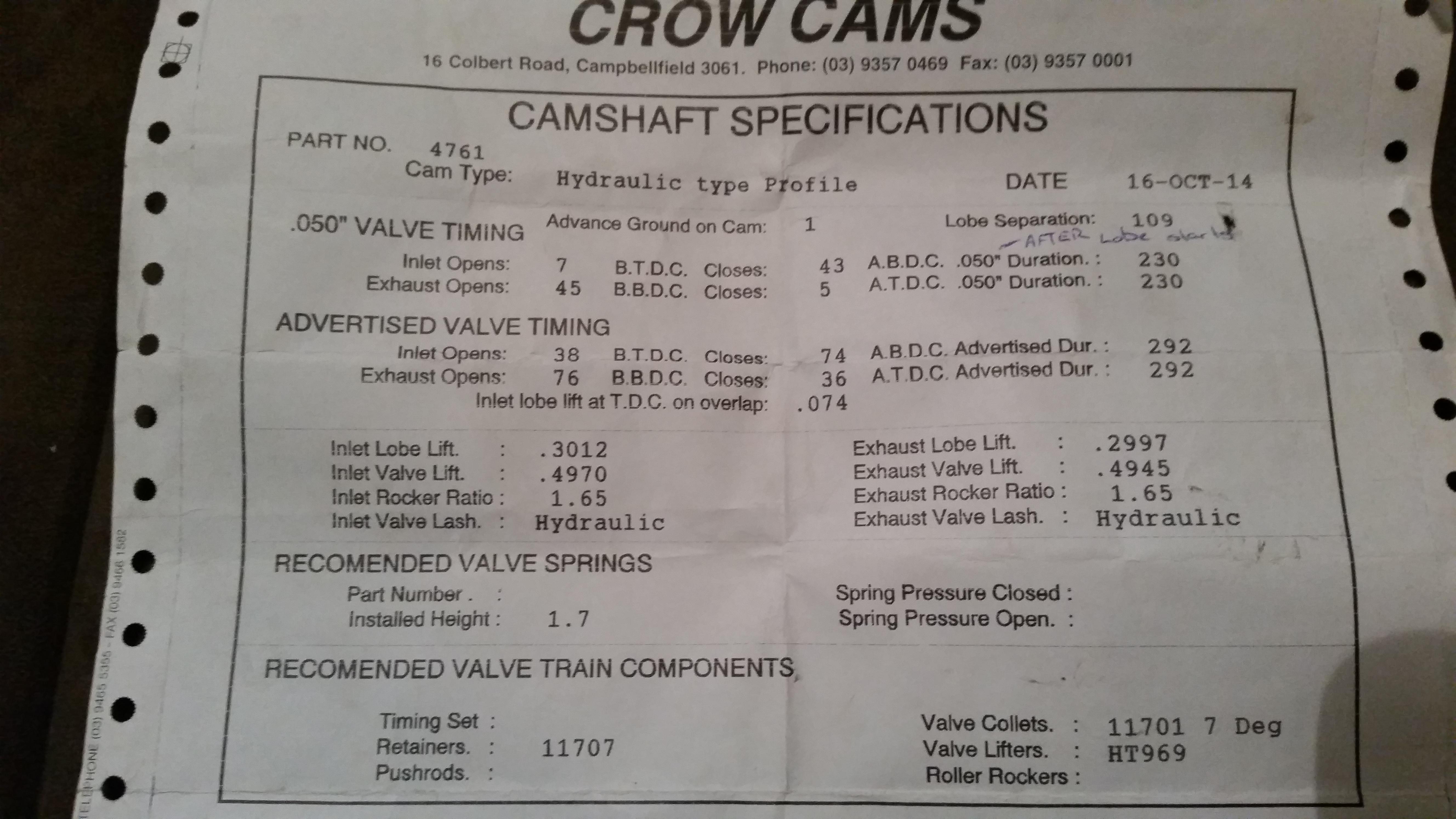

big cams
Posts: 53
Joined: Fri Mar 06, 2015 4:54 pm
cars: lots of holdens
Re: WANTED: vs v8 manual memcal standard or performance
Post by big cams »
Dylan wrote:What cam and injectors have you fitted?
hi mate im after a complete eprom. I've got extractors blue top injectors cold air in take the cam sheet is at ADVERTISED VALE TIMING is 292/292 with a lobe separation of 109. I can try post the sheet up if u need it?
Posts: 3364
cars: VR Commodore V8
Post by Dylan »
Yeah post the whole spec sheet. What comp ratio?
big cams
Posts: 53
Post by big cams »
hope it works
