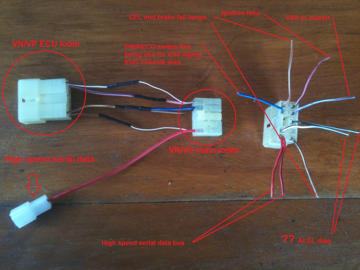

I manged to dig up this pin out for interfacing VN-VP looms into VR-VS cars. Turns out there is no tach signal on that plug, it actually comes through the 8 pin grey plug at the other end of the loom. There is though a single pin tach connector for diag purposes near the ECU end a bit farther up the loom.

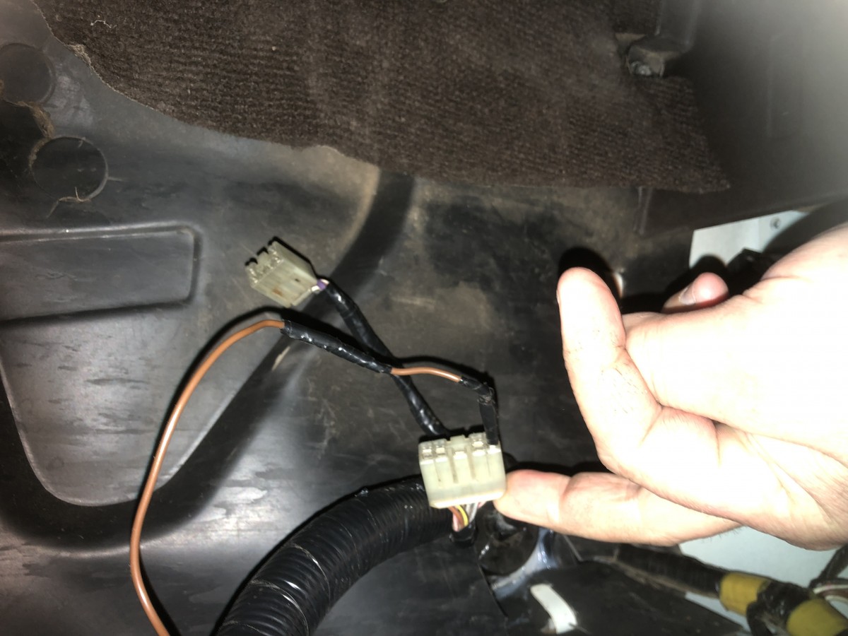

Yeah I think I know the wire you are referring to.. I’ll take a pic of it... much appreciate

None of my diagrams show those plugs, they show the wires and colour codes scattered throughout the diagram though. So you have to go by the colours. I know that it is the thin solid brown wire (not the thick one) in the grey plug that would be next to the fuse box in a VN-VS. The thicker one is AC request from memory.

One brown is alt light one is tacho they all follow pretty conventional Holden colour coding blue and green temp and oil and a strip added for cooling fan etc.the plug by the ecu has pink ignition black and white for diagnostics probably a purple for speed signal a wire for park neutral switch 1 for torque convertor lockup 1 for trans temp 1 for check engine light
