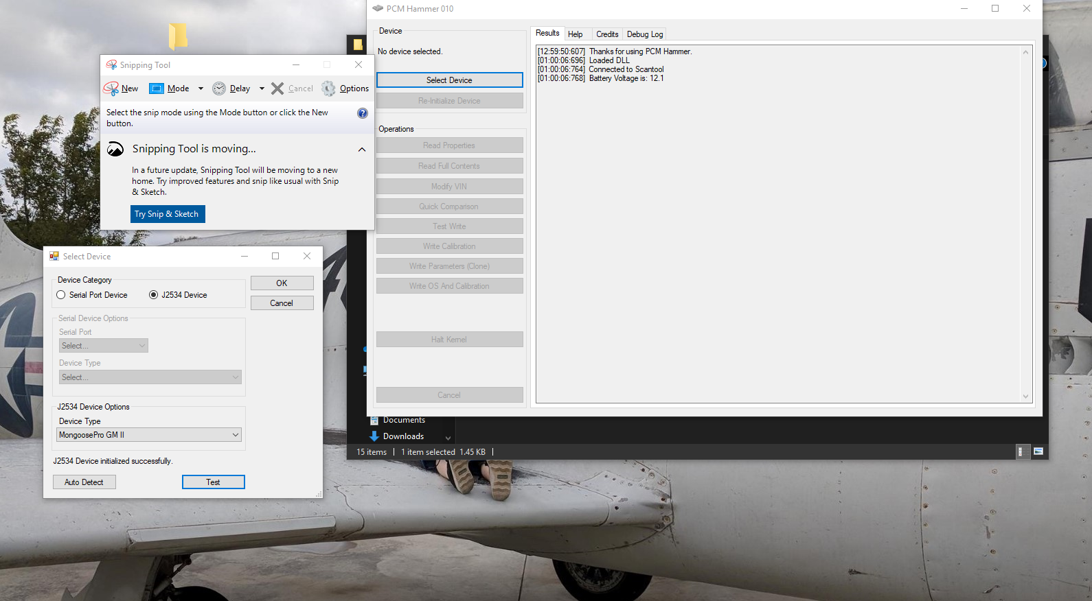

Not sure what changed on the back end But release 9 and 10 seem to have broken J2534 at least with a GM mongoose or tech 2. the select device tab allows you to select the device and test and you get a readback on the main window but it will not stay selected. Went back to release 8 and all is well.
