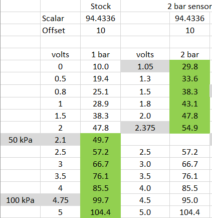

Stock VE table has MAP values from 15-105 kPa. Using a 2 bar MAP sensor would result in the 50 kPa cell being equal to 100 kPa. Anything above 50 kPa is boosted (up to 15 psi), and anything below 50 kPa is vaccuum. Unfortunately, if we have a larger camshaft, then we might only idle with a MAP reading of 45-50 kPa. This would equate to the ~25 kPa cell with the 2 bar MAP sensor. So from idle up to boosted would be a range of cells from 25 kPa through the 50 kPa. As you can see there are not a lot of cells available in this region. But what if we could slide down / scale the MAP value that the PCM "calculates".
Again, the key is to watch the MAP sensor voltage! The sensor will only put out a certain voltage based on the intake manifold pressure. Using the stock MAP scalar and offset values, 50 kPa = ~2.1 volts and 100 kPa = ~4.75 volts. Replacing the 1 bar with a 2 bar MAP sensor will drop the output voltage by 1/2. So, 50 kPa = ~1.05 volts and 100 kPa = ~2.38 volts.
Keeping the stock 1 bar MAP scalar and offset values with the 2 bar MAP sensor shows: 1.05 volts = ~30 kPa and 2.38 volts = ~55 kPa. This means that the PCM will use the ~30 kPa and ~55 kPa cells for idle up to boosted [6 cells in the VE table]. Going into boost will use the remaining cells (60 kPa through 105 kPa) to represent the 0-15 psi cells [10 cells in the VE table].

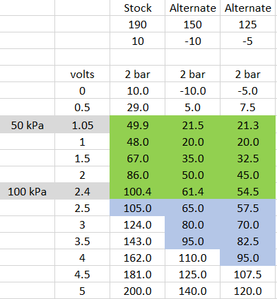

Ideally, we would want to adjust the # of cells so that more cells are available from idle up to boost with the trade off of having less cells in the 0-15 psi region. You can do this by adjusting the MAP scalar and offset values. I have played with these values and gotten it so that there would be ~8 or 9 cells for idle up to boost and ~9 or 10 cells for 0-15 psi. But you can play with these values to bias more or less to one region of the other. Making a spreadsheet goes a long way to being able to visualize the MAP value the PCM calculates based on different scalar/offsets.
Green cells are idle up to boost, Blue cells are the boosted portion.

One thing I forgot to explain, the PCM can only "read" up to 105 kPa. This becomes important because as you can see on the MAP vs. voltage table, that after a certain MAP voltage, the PCM MAP value will stop increasing. It will max out at 105 kPa. Under the alternater 150 / -10 column, this occurs at ~3.8 volts (~155 kPa or ~8 psi). So the cells that will work for boosted cover from 100 to 155 kPa. After 155 kPa, the PCM MAP reading will be stuck at 105 kPa. For these areas of operating, you will be on the last column of the VE table and will be making adjustments based on RPM.
