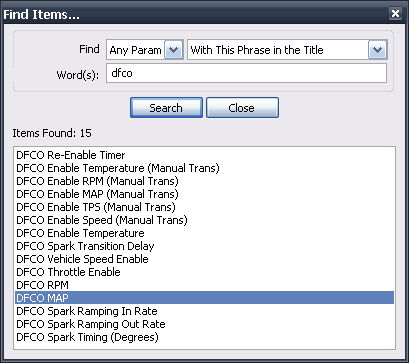

Do the DFCO settings not have an influence on wanting to stall when returning back to idle from decellerating.
I added the dfco entries in the xdf of the last VY I played around with and found that some did have a positive influence to the outcome regarding stalling from decel

Good point. Turning off DFCO was one of the first things I tried, but it didn't change anything for me. I'm sure it could cause this though. If it doesn't resume fuel delivery quickly enough that's obviously going to be a problem.
So it's still something that anybody with a return-to-idle problem should try first. And it's pretty easy to shut off via minimum speed or something like that.

I've had DFCO on and off during tuning too, no difference especially since it gets disabled below certain RPM/road speed anyway (I've lowered these from standard due to gearing without issue). I have changed the ignition advance settings here though too so it doesn't retard as far, helps with smoother transitions back to fuel and avoids popping out the exhaust, I guess that also eases the transition to idle advance numbers.
