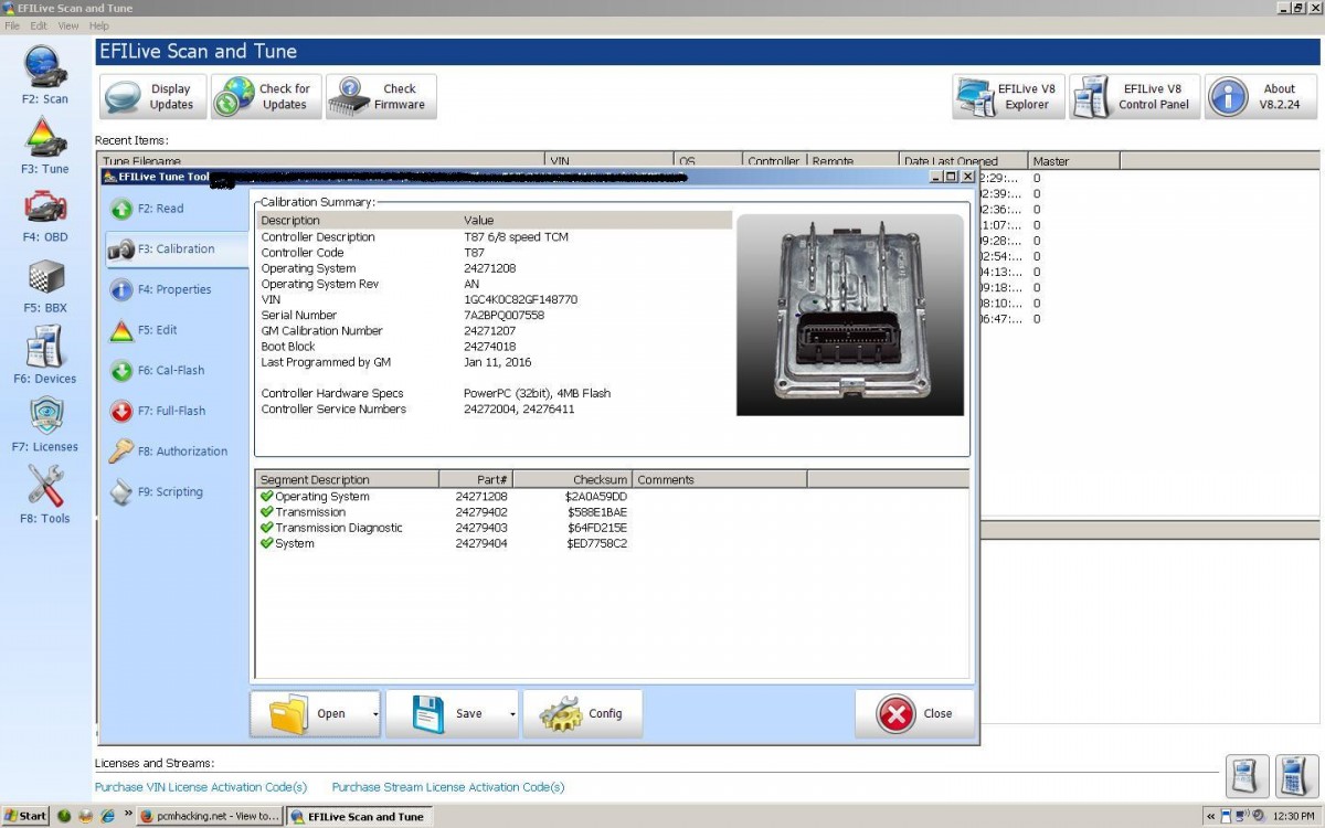

GMLAN didn't work but interpreter type Keyword2000 and algo 39 seems to work great on the two that I have. :thumbup:
I assume this is an Allison 6spd since the vin is a 2016 Diesel LML
VIN: 1GC4K0C82GF148770
VIN 1GC4K0C82GF148770
Make CHEVROLET
Model Silverado
Year 2016
Drive Type 4WD/4-Wheel Drive/4x4
Style/Body Medium/heavy Pickup (GVWR greater than 10,000 lbs.)
Engine 6.6L
Manufactured in FLINT, MICHIGAN, UNITED STATES (USA)
Age 4 years
Cab Type Crew/ Super Crew/ Crew Max
Engine Model LML - PTI, DURAMAX
Gross Vehicle Weight Rating Class 3: 10,001 - 14,000 lb (4,536 - 6,350 kg)
Brake System Type Hydraulic
Engine Configuration V-Shaped
Fuel Delivery / Fuel Injection Type Common Rail Direct Injection Diesel (CRDI)
TCM Service No: 24271207
TCM Traceability Code: 7A16002BPQ007558
TCM Security Seed: 6D30 <<<<<< Key is F3D7
TCM Module 1: 24271208
Edit: >>>>>>>>>>>>>>>>>>>>>>>>>>>>>>>>>>>>>>>>>>>>>.
Turns out EfiLive was able to read it so I guess they have the algo figured out already, can't save as a bin though :silent: Here's a screenshot of more file info.
