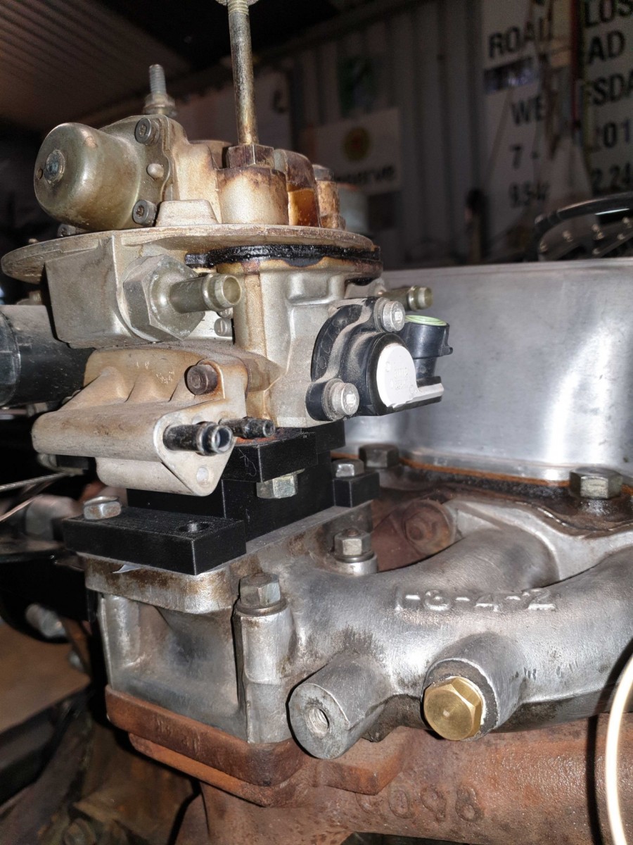

Thats interesting. Although it is suspiciously light on technical details. Im very interested to see how it turns out. Ive had an adapter printed with a Markforged X7 in their proprietry material called onyx, data sheet attached. It looks like regular plastic material, but they say its stronger than 6061 aluminum. Its also very light. When we bolted the TBI carbie on to a manifold with an adapter made from it and rocked the TBI, the whole engine moves and it doesnt flex at all. We'll see how it goes when the car is running when the project gets that far. By the numbers it looks like it should be suitable.
https://markforged.com/x7/
Machine cost is high, but its not too bad to get a shop to print out a model for 1 offs without investing in the hardware.
Here is a pic of the TBI on the engine. I wont steal the owners thunder though, I know he will post a thread on here when its alive.
