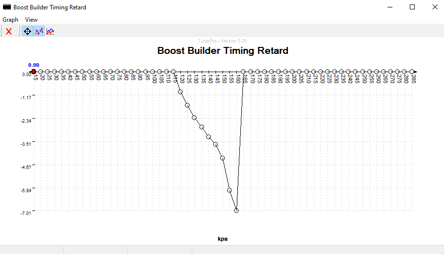

I've made more modifications to my current LC version to have a spark advance offset based on manifold pressure.
Boost Builder Table.png (15.54 KiB) Viewed 14276 times
This way I can pull timing to help build boost, but I can add timing back in once I hit my target boost level so that it holds.
I tested it last year and it worked great. I think I'll do more testing with the current version before trying different methods.

That is a great idea. One question I have is how are you handling the boost measurement? The stock MAP is limited to 1 bar, but you can fake it by using a 2 or 3 bar sensor. Or are you trying to use a 2/3 bar sensor and another PID which allows you to go higher than 1 bar? (GM.MAP vs. SAE.MAP)

I'm using it with a modified os for boost and a 3 bar map sensor.
One annoying thing is that the offset table and launch control valve are outside the Address range that standard tuners use for a parameter flash. So to make changes I have to do a full flash.
Haven't had time to figure out a way to have the tuner include this address range in a parameter flash (not sure how difficult) , or move the parameters inside the normal address range (may have to override unused parameters, so not idea for other people)
