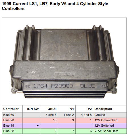

Hey Gampy,
I wondered the same thing 18 months ago as a mentioned in this post I made early last year: viewtopic.php?f=42&t=6208&p=92299&hilit=chuff#p92299
This is the information that caught my attention in the link I provided in the above mentioned post.
I'm not sure if that helps you in any way but it is at the least a possible lead.

Re: 2004 Chevrolet Cavalier 2.2L ECM
I downloaded a stock 2004 tune from the hp tuners repo and that app says its a P11.
Internet sluthing shows pictures which look like an E38 case from the outside, and perhaps it is the same family, but I'd guess the hardware would be cut down internally being only a 4 banger to keep costs down.
