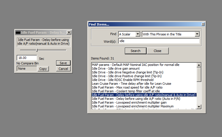

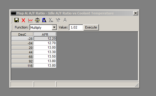

Posts: 8550
Re: Vn 304 help needed
I would think its these. For auto there is P and D settings as you can see in the search list.
There is also a table for closed loop idle VE but I have never had to use it, all the cells in that table are at 50% default.
vp304
Posts: 479
Joined: Wed May 19, 2010 4:21 am
Post by vp304 »
Thanks vlad
My idle a/f ratio vs coolant temp is around 14.1 at 92deg c
Unless my coolant temp sensor was playing up as i couldnt get my ose plugin to work other day and maybe ecu thinks its cold all the time. Tho i had no engine lights on so dought that was the problem.
delay before ideal af ratio is set at 20 sec on my tune also
Posts: 8550
Im thinking if they don't match then you could use the closed loop idle VE, but iirc you need to enable a flag to use that table, it should otherwise be using the main VE table.
I could be wrong on that, so if anyone wants to correct me on that.
