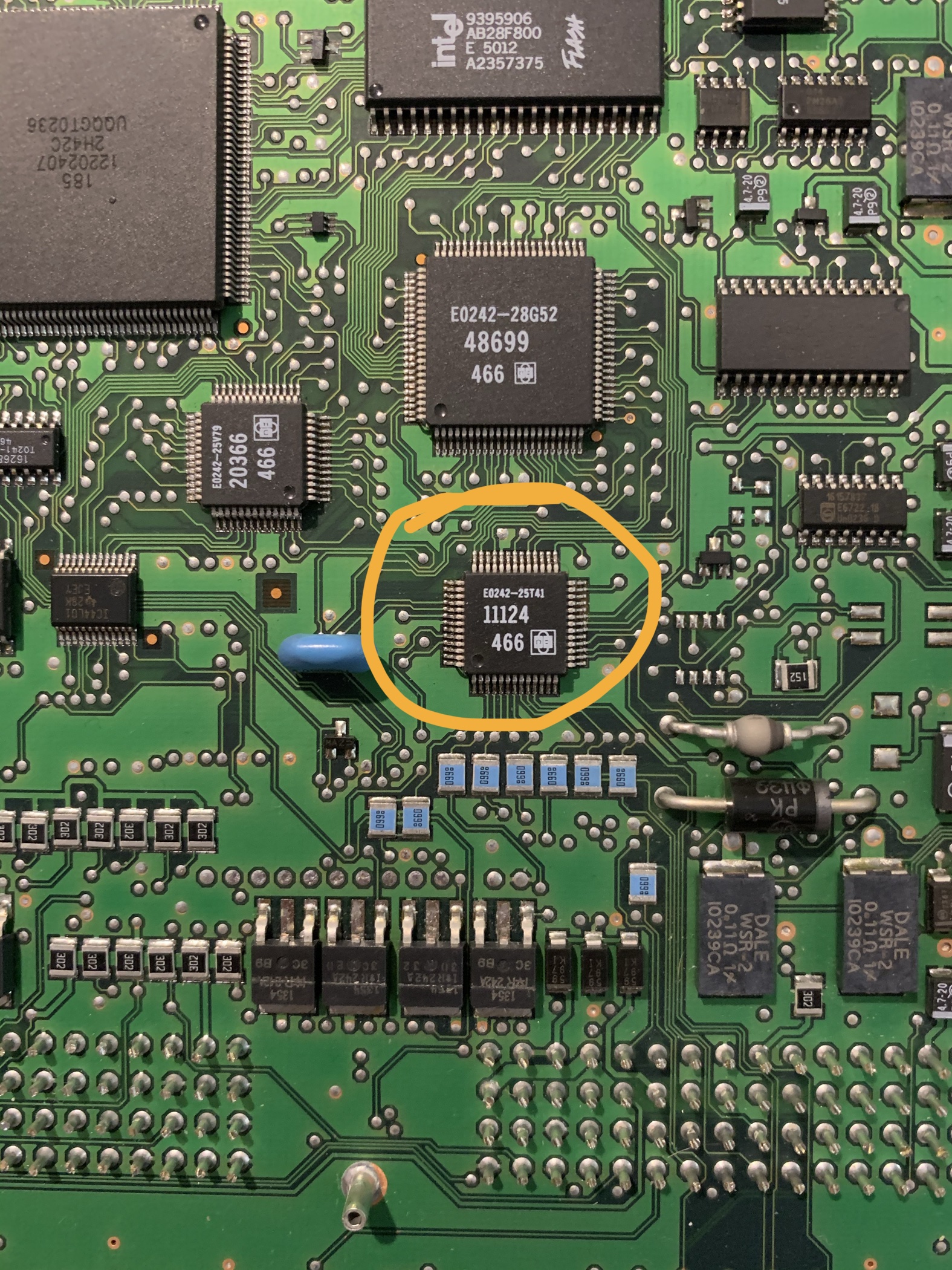

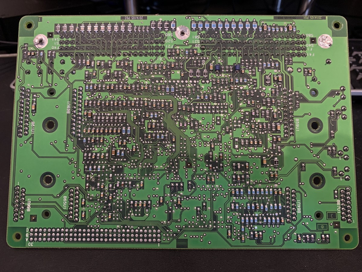

I am trying to determine how the circled chip communicates with the main MCU.
And if anyone would be able to help me ID the chip that would be great.
The board I'm looking at is an Intel P59. Pretty sure the hardware number is 12575502
I've traced the chip to be connected to the ignition coil pins, which I am trying to do some reverse engineering of the logic for the ignition control.
I'm having trouble understanding how the MCU communicates with peripheral chips. I understand there are chip select pins and address pins, but I am having a hard time searching for info as I don't know the terminology very well so I could use a point in the right direction. I've tried to read the MCU data sheet, but parts of it really goes over my head.

I think it is more than that. I think the chip above it, the 48699, is in between it an the cpu. You really need to understand how that one works. I think its also involved in the control of the WE pin for flashing. There are some registers the cpu writes to, to control it, but its quite hard to figure out. Sorry I dont have more.

Yeah, I was afraid it was going to be more difficult than that. Has anyone determined what chips those are?
I haven't even seen anyone post what the main CPU chip is. The only one that I have found so far is the MC68336/376 datasheet which is a 160 pin chip like the one in this PCM.

I traced some of the pins on that chip, since it is used on v6s pcm and early style ls1 and maybe others.
It also filters the crank, cam signals and send them to processor, it can be configured to run in different modes, single coil v8, dis module v6, 8 coils and so on.
ON v6s pcms there are some pins wired to pcm connector, for 6 Coil on plug style, but not sure how that can be turned on, is it software limitation or there is also some hardware too.
