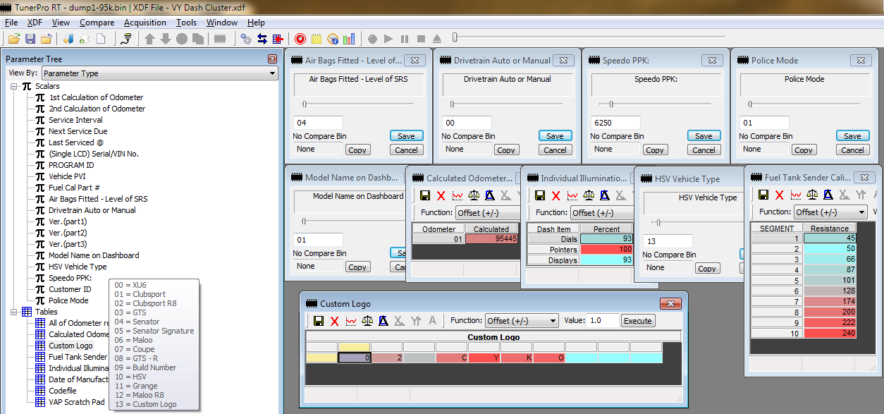

Got around to finalizing my sons dash request today, piggy backing the chip on his dash and pulling the eeprom contents, editing it and flashing it back.
I also further edited an XDF I'd downloaded from here some time ago, adding some useful & not so useful entries into it.
The authors name is in the header, & added mine for the additions, hope it's OK to redistribute.
Pic of some of the additions if anyones interested.

Updated the XDF above based on what I found after using the Aust Arrow software.

Thanks mate..The1 wrote:Nice work
Hi mate, yeah I read and flashed back without de-soldering using a piggy back connector (for the want of a better terminology) connected to my GQ4X programmer.L67PSI wrote:Hi Ken, were you able to take the read directly from the cluster without de-soldering? Or using an adapter like the SOP8 adapter?
Just had to massage /shorten the plastic on the connecting end of the clamp a little with some fine sandpaper to get the end contoured enough to go deep enough over the chip to make good contact.
